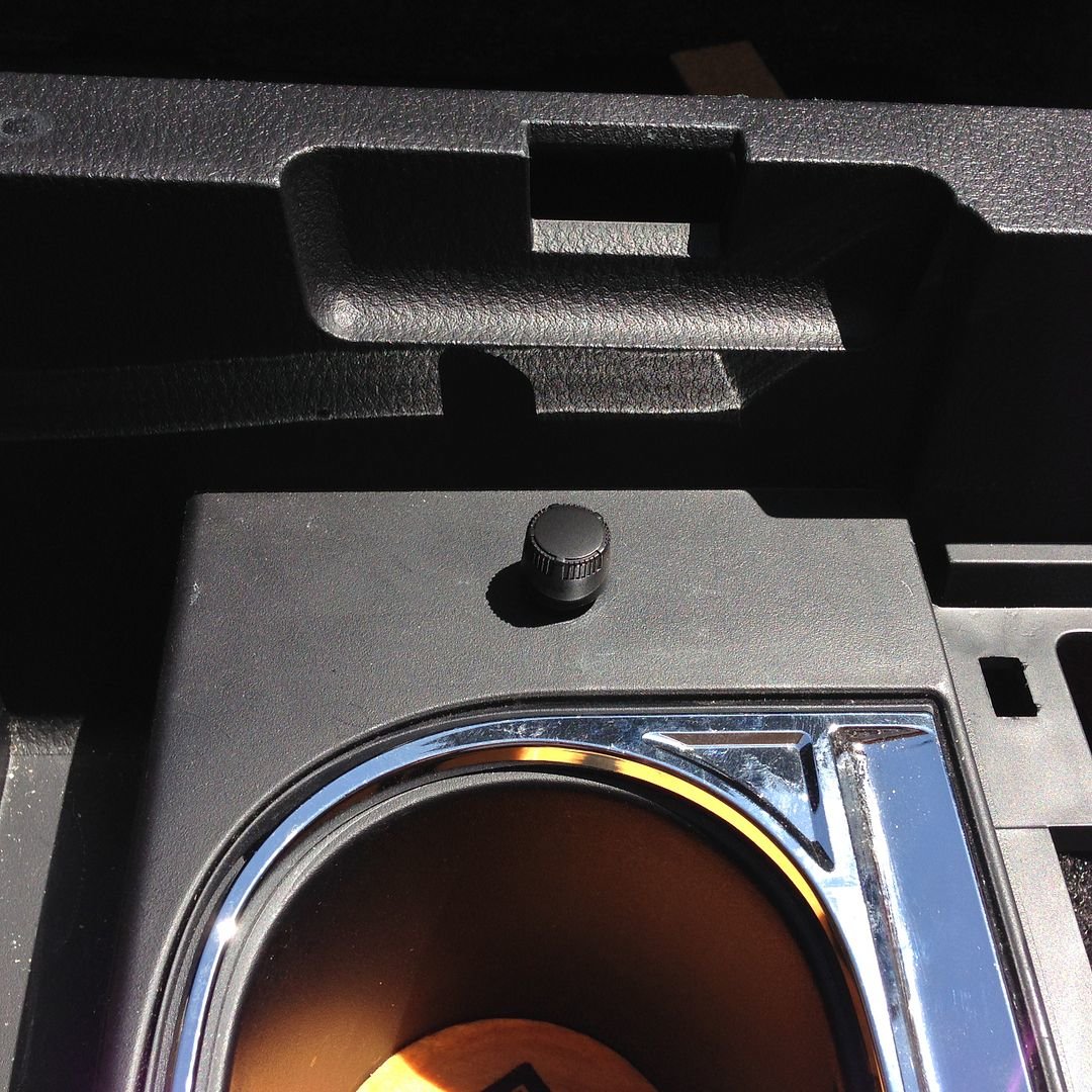

    I have the same bass knob, but installed it at finger tip position as I drive.
    Adjust it for almost every different music genre...

    Thats a perfect spot for the knob, I may move mine.
