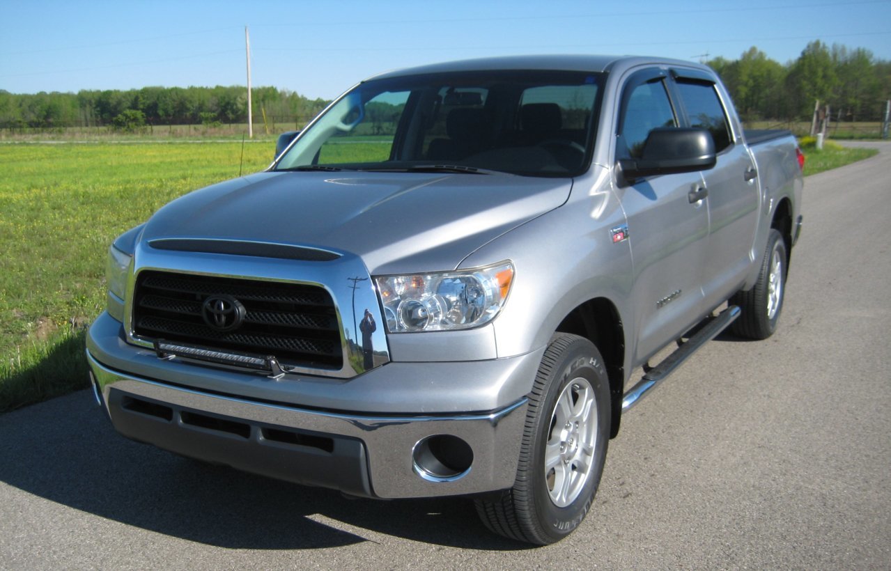

    My '07 crewmax, 5.7L, 4X4, clocked 70K few years ago (now has 75K). I had all the driveline fluids changed, belts, hoses and coolant. Recently, New tires (third set). New battery (third one). Might take me 10 years to put another 50K on, then I'll do it again. I don't agonize over preemptive mechanical repairs,(water pump, injectors, bearings, etc) I haven't a mechanical failure in 15 years, and if and when I do, I'll just get it fixed. It always starts and runs today as well as the day I drove it home.
