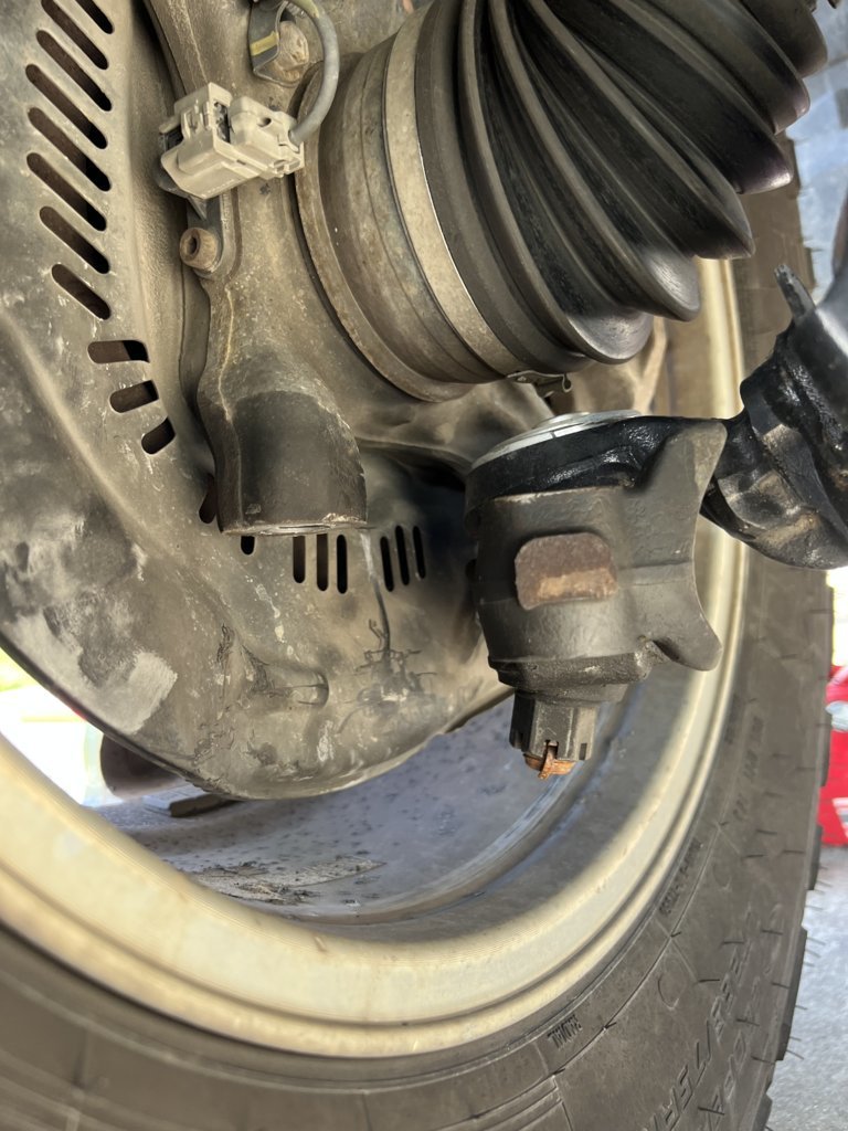

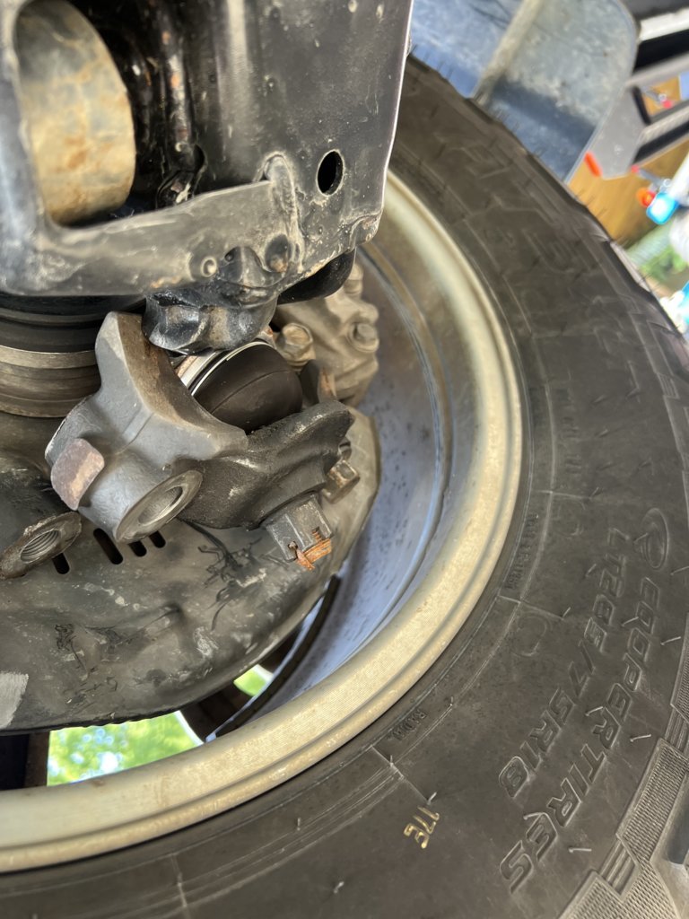

    Well, I went to move my truck (2008 tundra crewmax 4x4 5.7) to take it out tomorrow and I was hearing a bunch of clanking and it rode odd. It felt like a flat tire. After moving it about 100’ I looked underneath and see one of the lower ball joint/control arm bolts is gone. I called two stores near me and nobody sells the bolt and I’m not having any luck finding a part number.
    I did replace the lower ball joints and control arms as well as swaybar end links 4-5 months ago but I guess I didn’t get the bolt torqued down enough. I plan to use lock tight this next go round.
    Ive never had this happen before so is it as simple as replacing the bolt and rechecking everything or are there any other things I need to check? I drove this truck 100 miles highway last week and it ran great so I think this lost bolt was a recent occurrence.

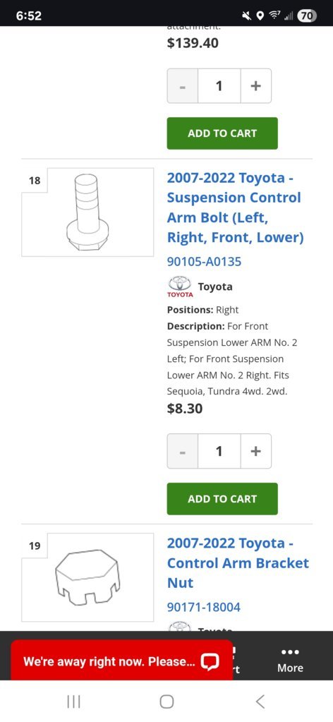

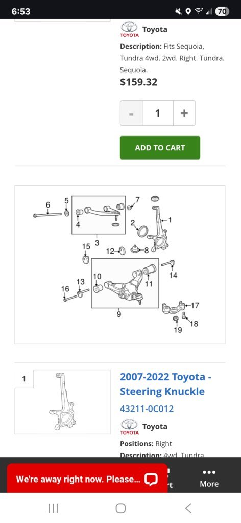

    It's #18

    what website do you use to find part number like above? I never see the exact part number when looking at my dealers parts website.

    I usually look them up on sparksparts.com
