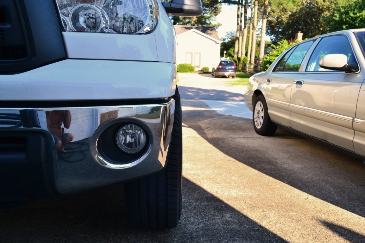

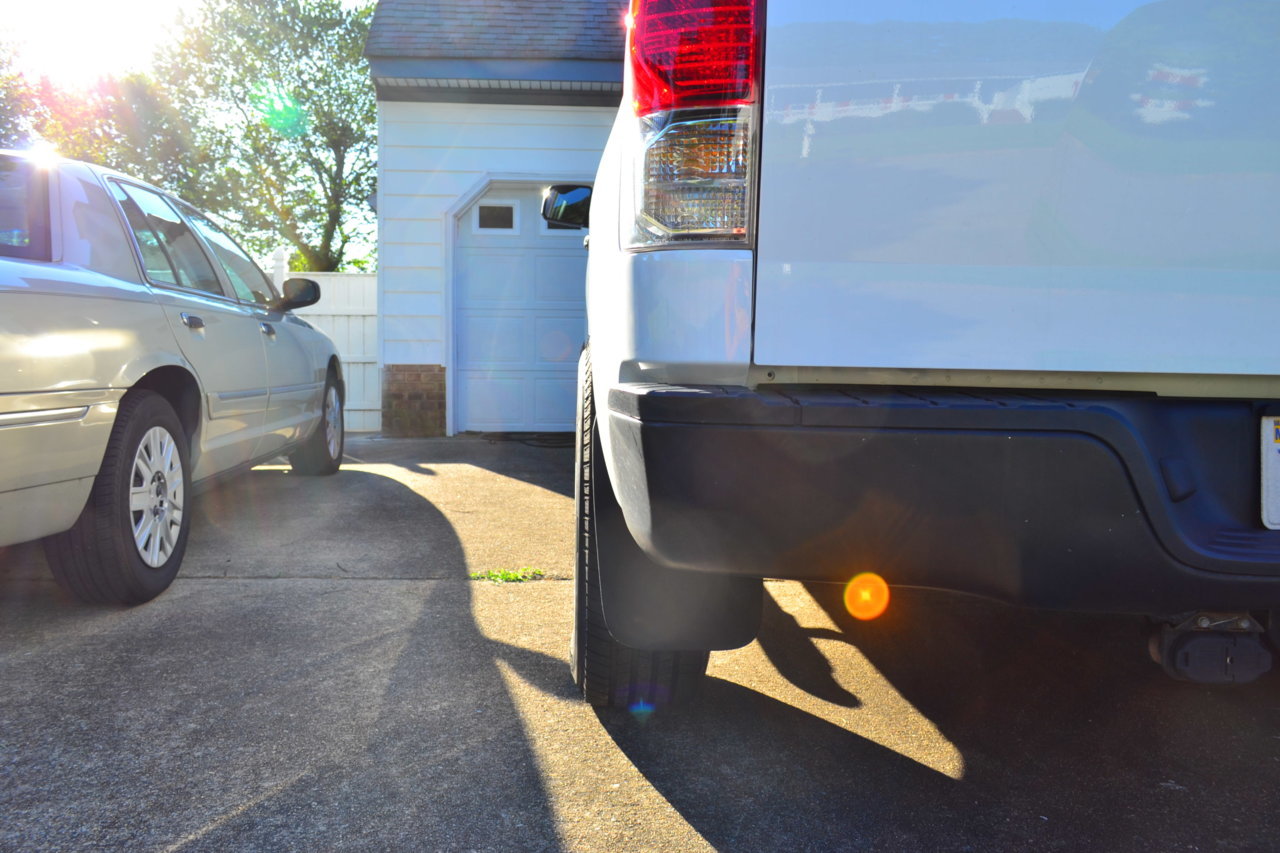

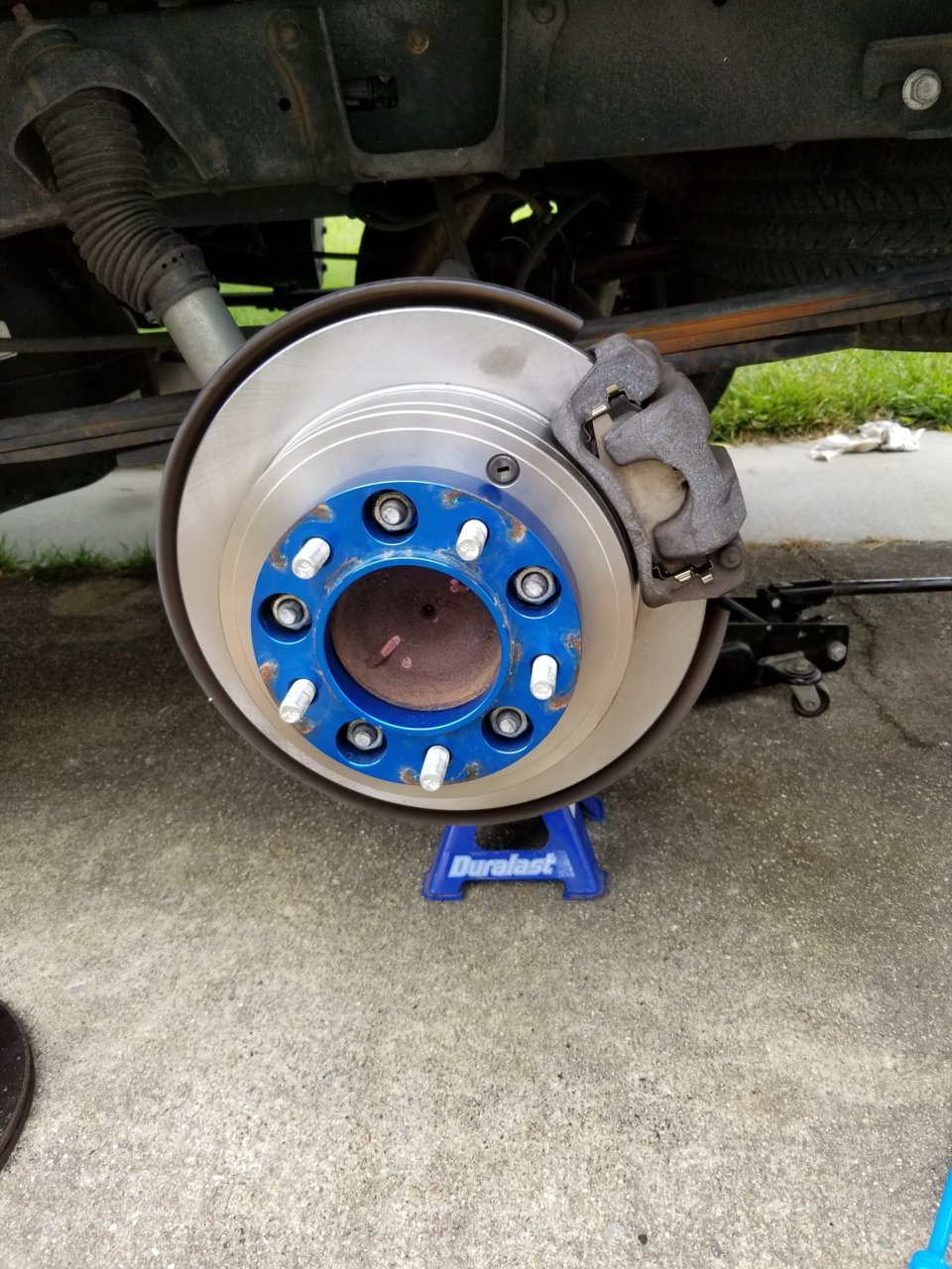

    These are spider trax, 1.25. I added them to fit 295-70 tires. I wasn't going for appearance, I wanted the tires for sand. Like has been mentioned, this is an alternate $250 solution vs $1000+ for new rims. Many miles of beach driving and a few moderate mountain trails, zero issues.
    I used blue loctite so I could disassemble without heat. Red has to be heated to break down.
    Also, very important, make sure the faying surfaces are completely clean. DSC_2493.jpg DSC_2495.jpg

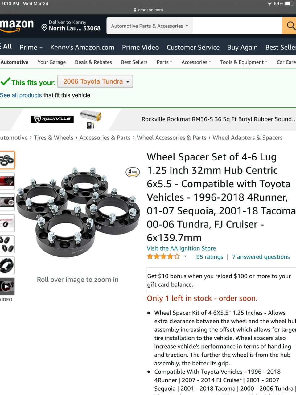

    So I’m a complete retard when it comes to tires, rims, spacers, etc but I really want my truck to have a wider stance as well. Am I correct in assuming I can just buy these spacers from Amazon and instal them fairly easily? It looks simple enough but like I said I really have no idea if these are garbage or if it is more complicated than it looks. 2A122827-3906-4771-89FE-97E5E673A352.jpg

    I wouldn't use those on a dare. At that price those are probably cast aluminum with low grade studs = not safe.
    There's a reason Spidertrax or BORA are nearly that price for one spacer.
    For your truck probably the best deal I've found is here:
    https://www.1stgenoffroad.com/store/p842/SpidertraxHubcentricWheelSpacers.html#/
    You'll need two sets. A little more pricy but still about 1/4 the cost of new wheels.

    T6 aluminum
    135 ft lbs torque
    All good reviews as far as I can tell.
    However, I value my life. Not worth the risk just to save a hundred bucks. Plus I’d be nervous as hell driving with those now. I’ll check out BORA.
    Thanks for the heads up.

    If there's anything I know about Amazon, its that their descriptions don't always match reality, and what you see in the listing is not always what you get on your porch. That price just tells me those are not the real deal. Like I said, probably cast aluminum and glued in low grade studs. There was one review talking about the studs spinning when trying to torque them, which tells me they're not splined studs.
    BORA are great, but not usually stocked anywhere and are made to order. Usually takes several weeks to get them.
    The Spidertrax in the link above are on the same level as BORA and you can usually get them much quicker.
    Someone mentioned earlier the Supreme Suspension spacers. They look to be legit too, but only come in 1.5" or 2" according to their website.

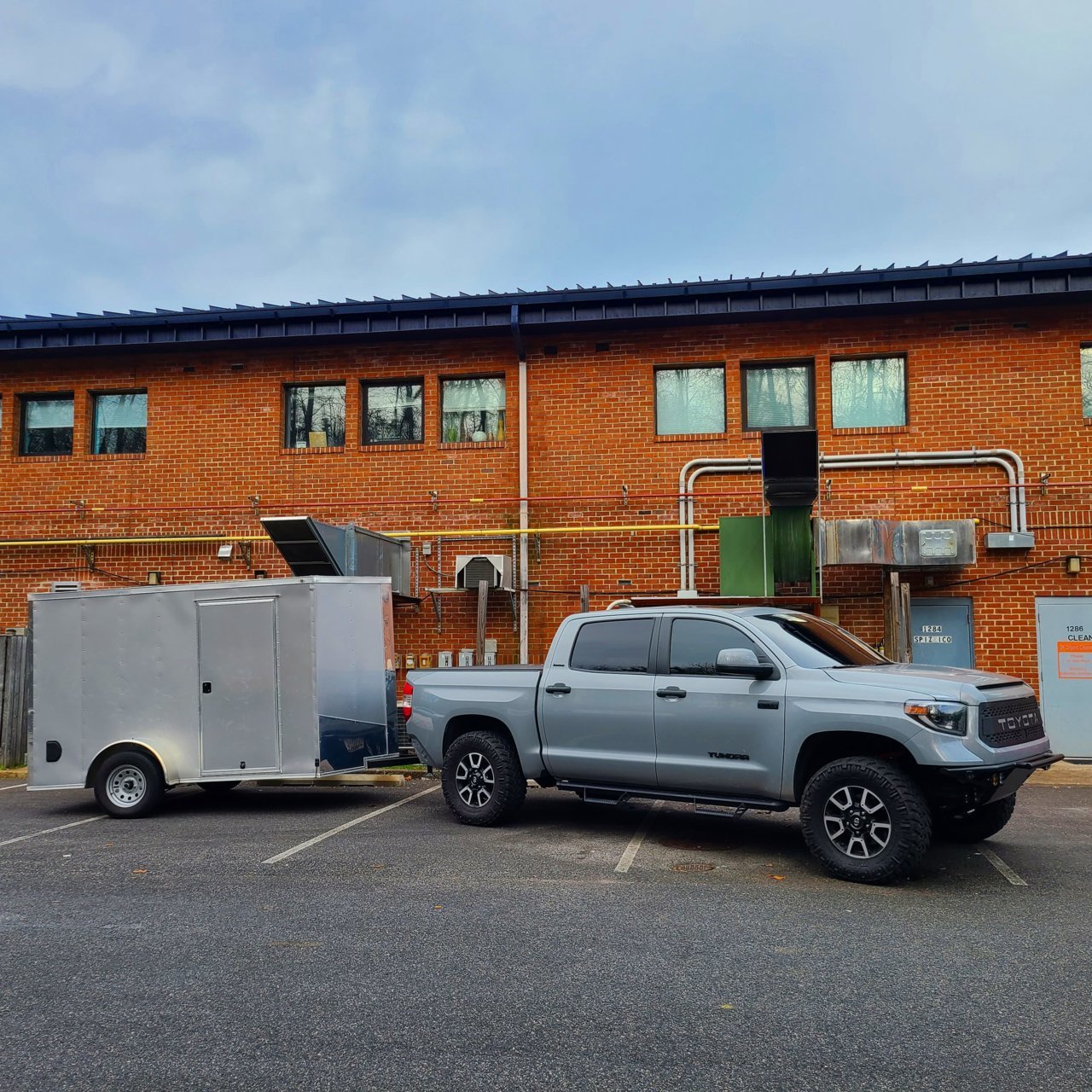

    I tow a 6x10 regularly (2 or 3 times a week) with 2" Boras. Not a single issue. It's squatted here (overloaded tbh) because I had to use it to haul our stuff from a move.
    I recheck torque every oil change/tire rotation (around 7500 miles) and they have not once been loose. Have 21k on the truck currently.

    I used 1.25" Spidertrax spacers on my '07 4Runner for over 5 years and never one problem. I bought the below "cheap" set mainly to test on my 2016 CM but they were very good quality, hub-centric, with correct lugs and I didn't have a single problem. I didn't like that the 1.25" spacers threw crap on the side of my truck so I switched to 1.0" BORA spacers, which solved 90+% of that problem for me and I still kept the improved spacing off the UCAs and the stance I wanted.
