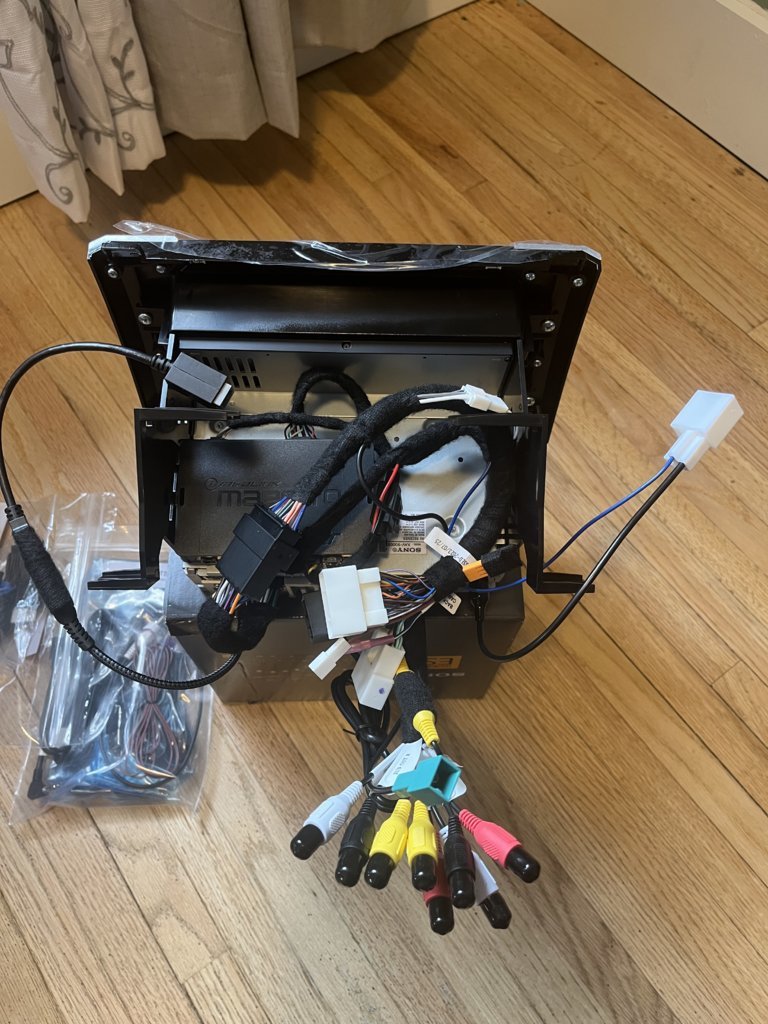

    New head unit from Trail Grid Pro, pre-wired and Maestro programmed ready to drop in:
    upload_2025-9-8_15-24-57.jpgupload_2025-9-8_15-24-57.jpgupload_2025-9-8_15-24-57.jpgupload_2025-9-8_15-24-57.jpg

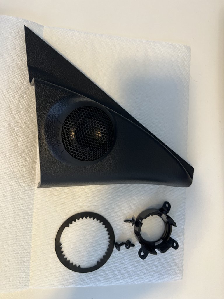

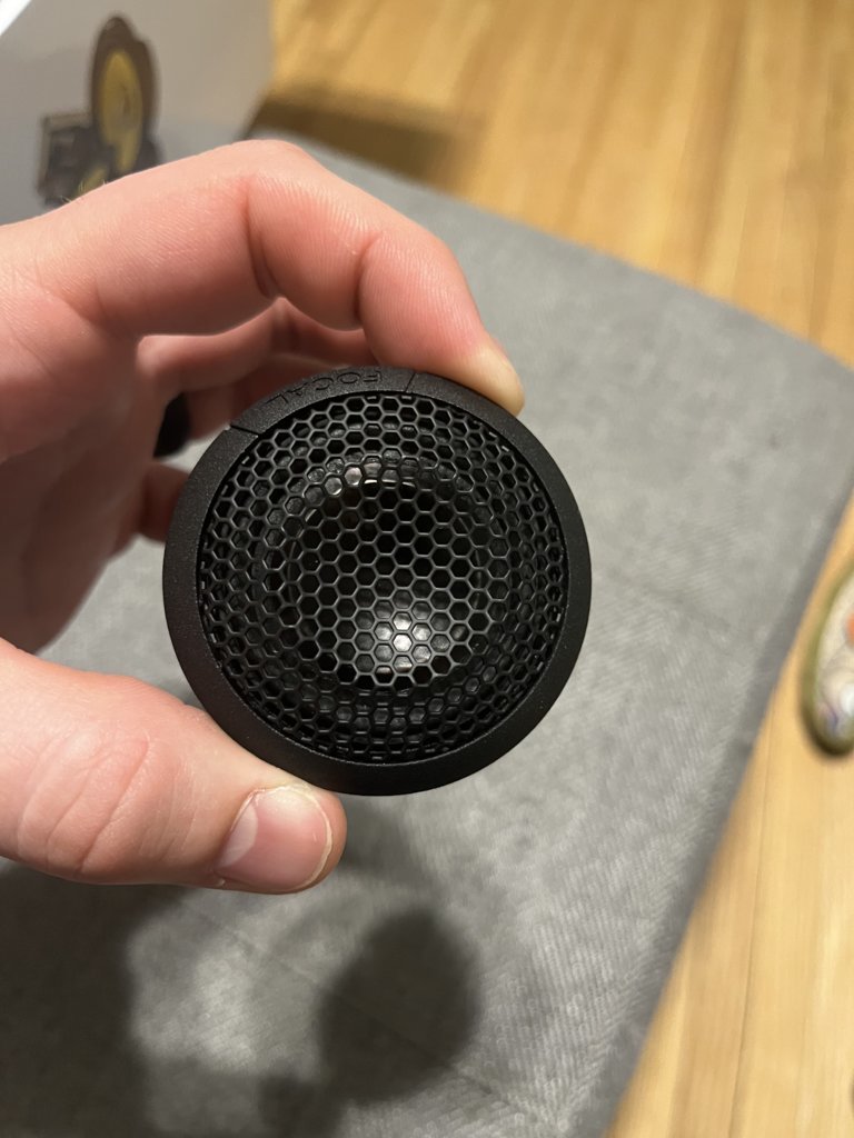

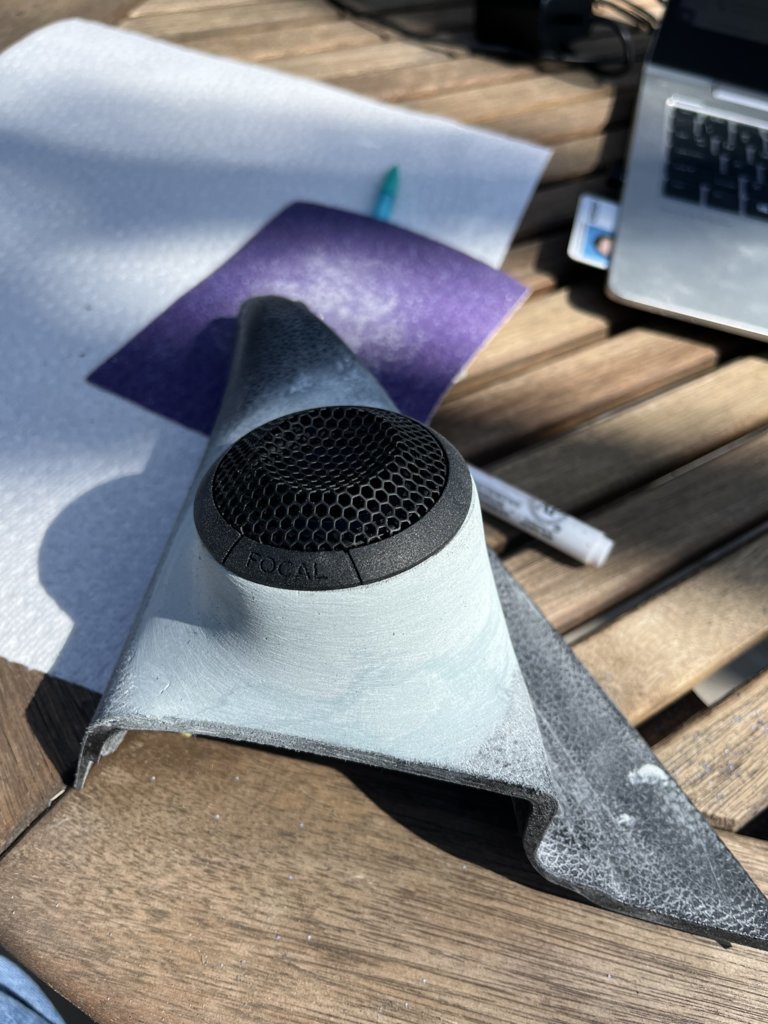

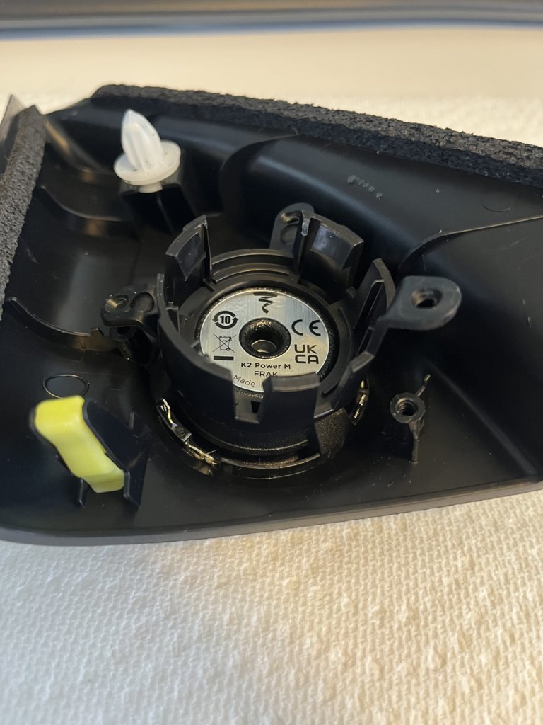

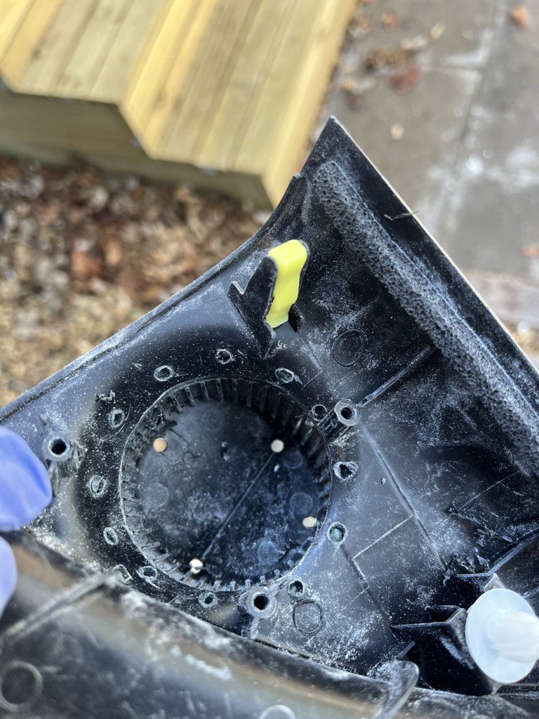

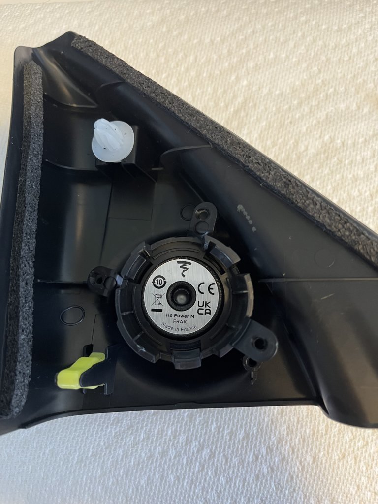

    Originally had Focal K2’s with the Frak tweeter for front stage, modified JBL sail panels to fit them:
    upload_2025-9-8_15-26-49.jpgupload_2025-9-8_15-26-49.jpgupload_2025-9-8_15-26-49.jpgupload_2025-9-8_15-26-49.jpgupload_2025-9-8_15-26-49.jpgupload_2025-9-8_15-26-49.jpg

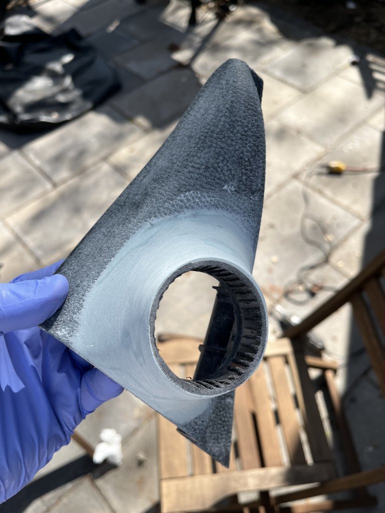

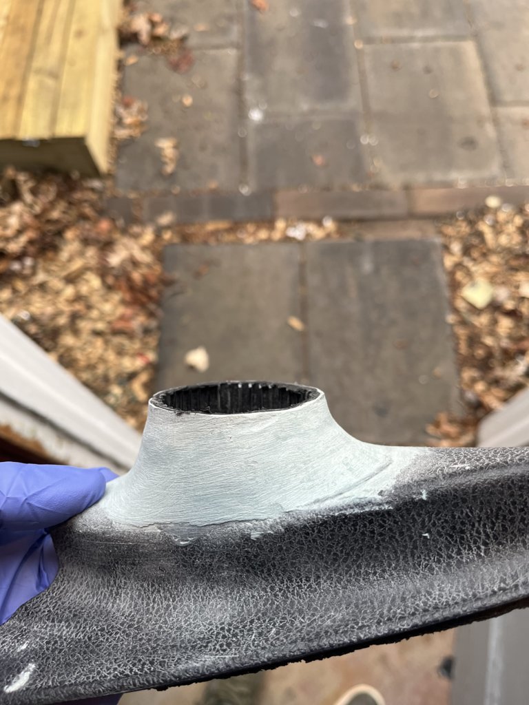

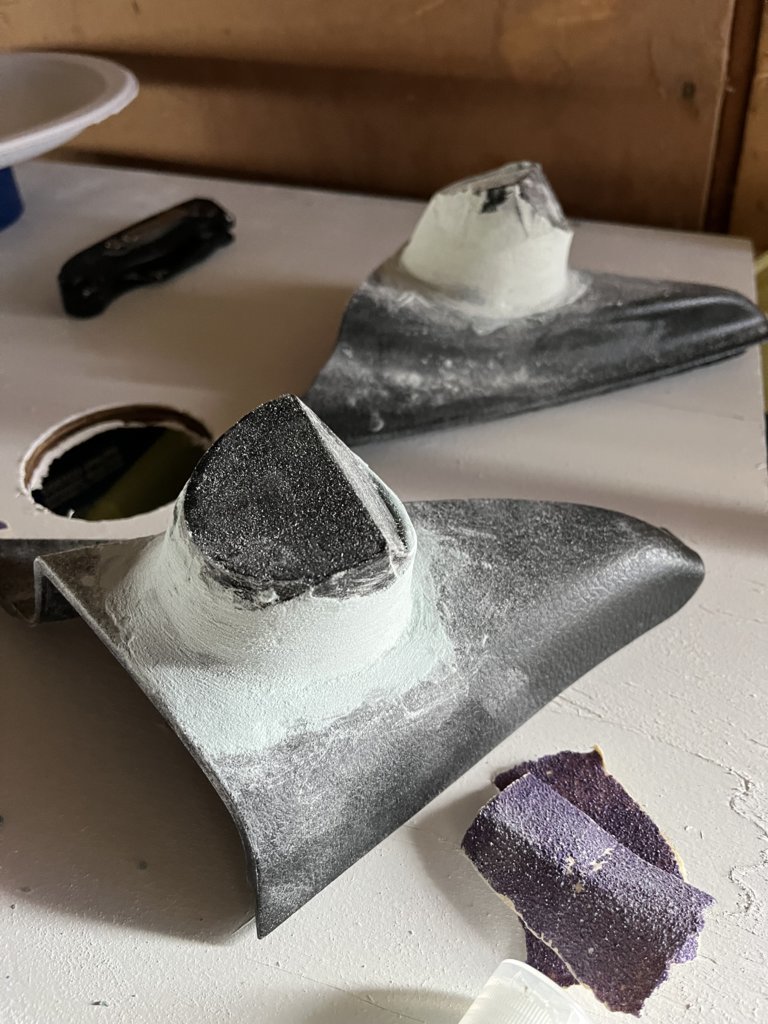

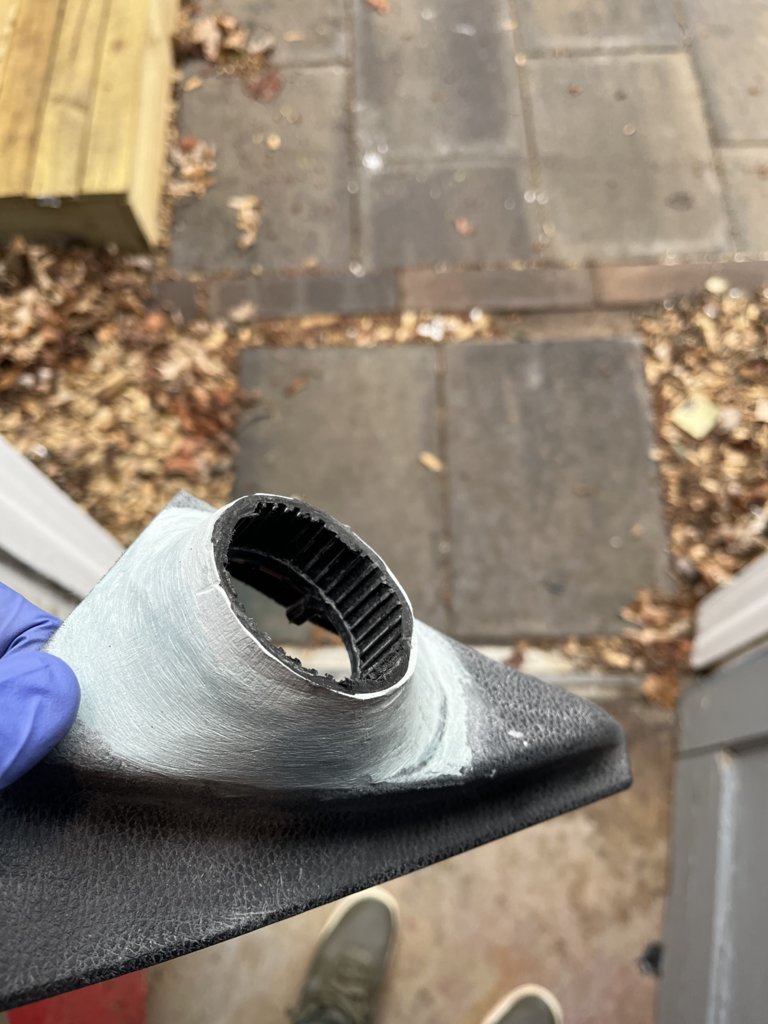

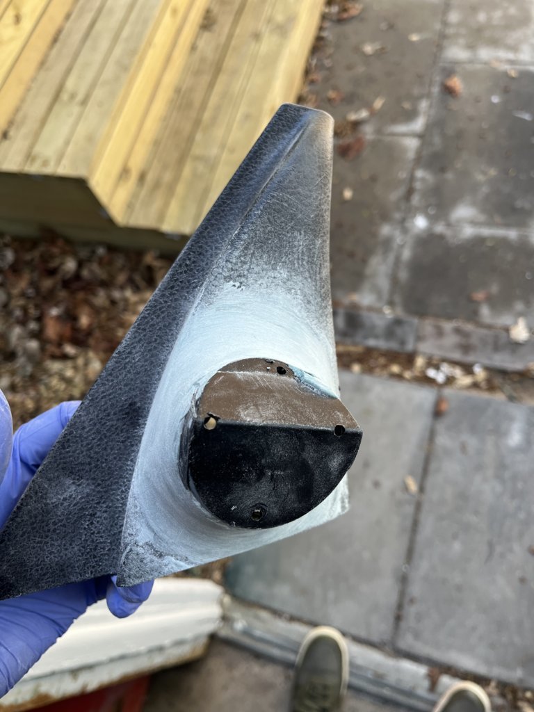

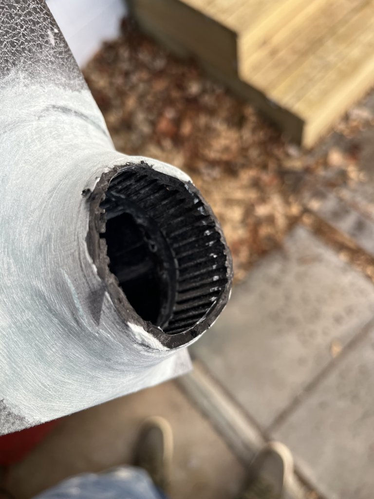

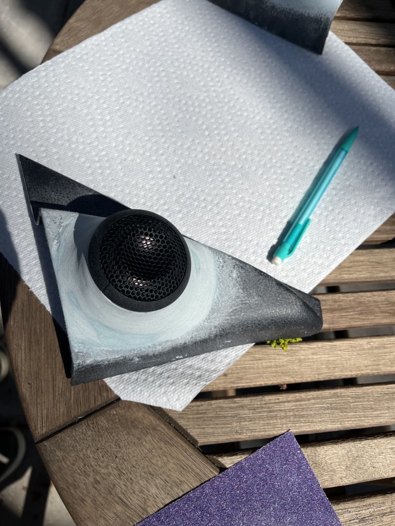

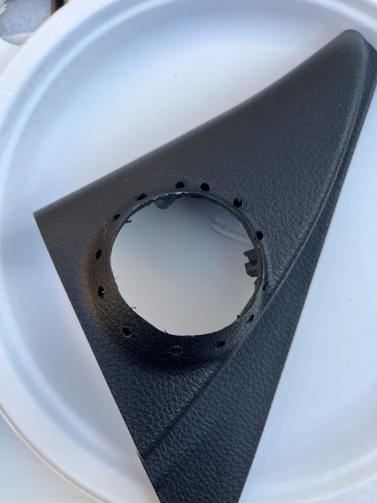

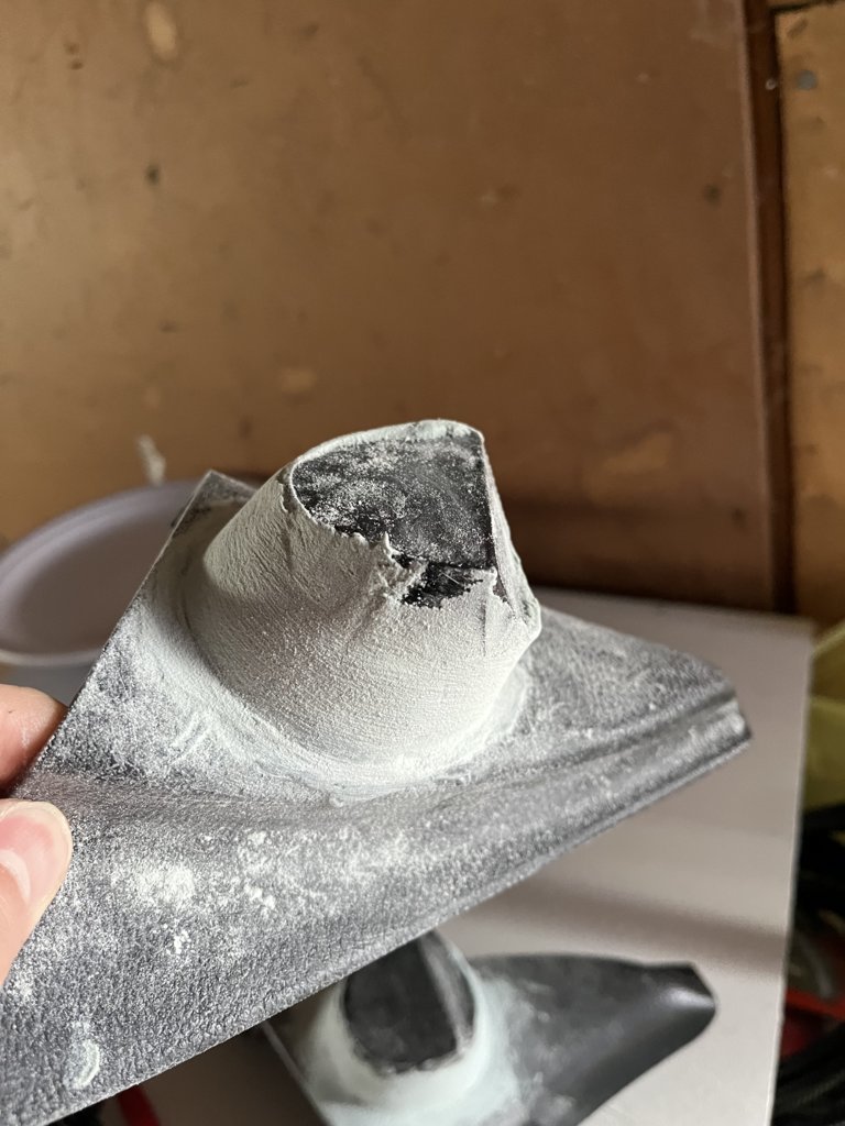

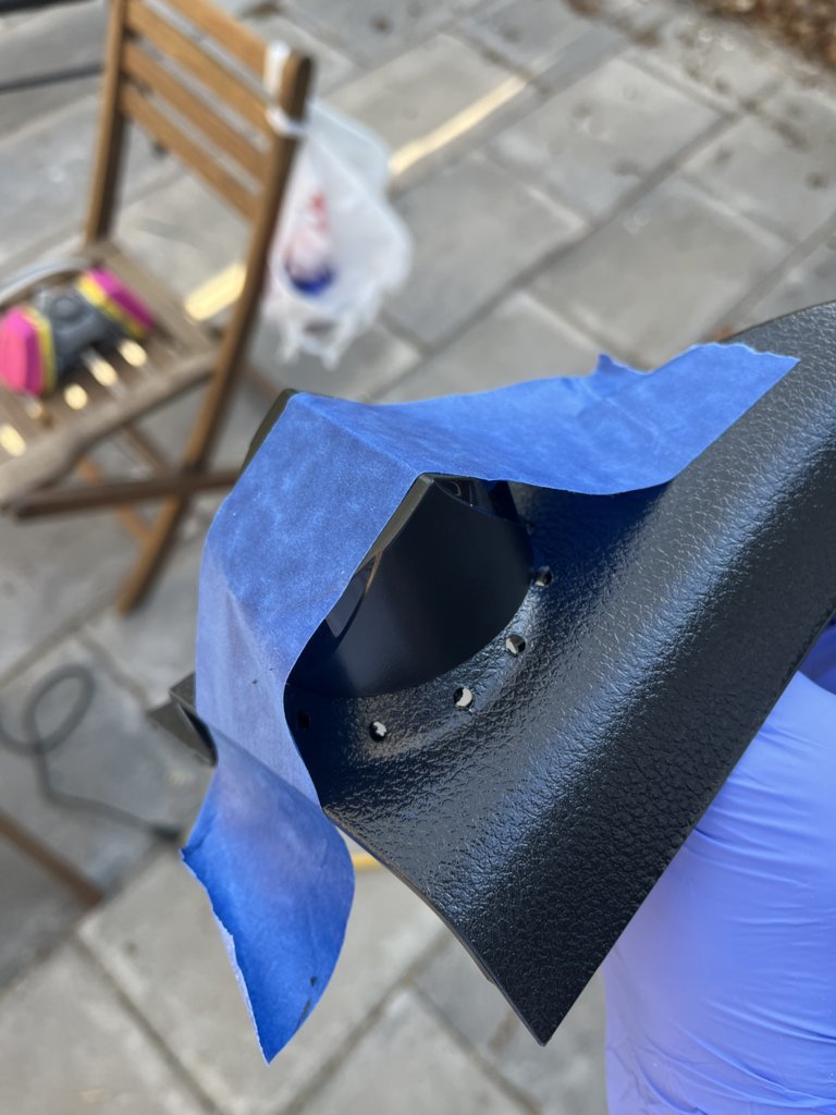

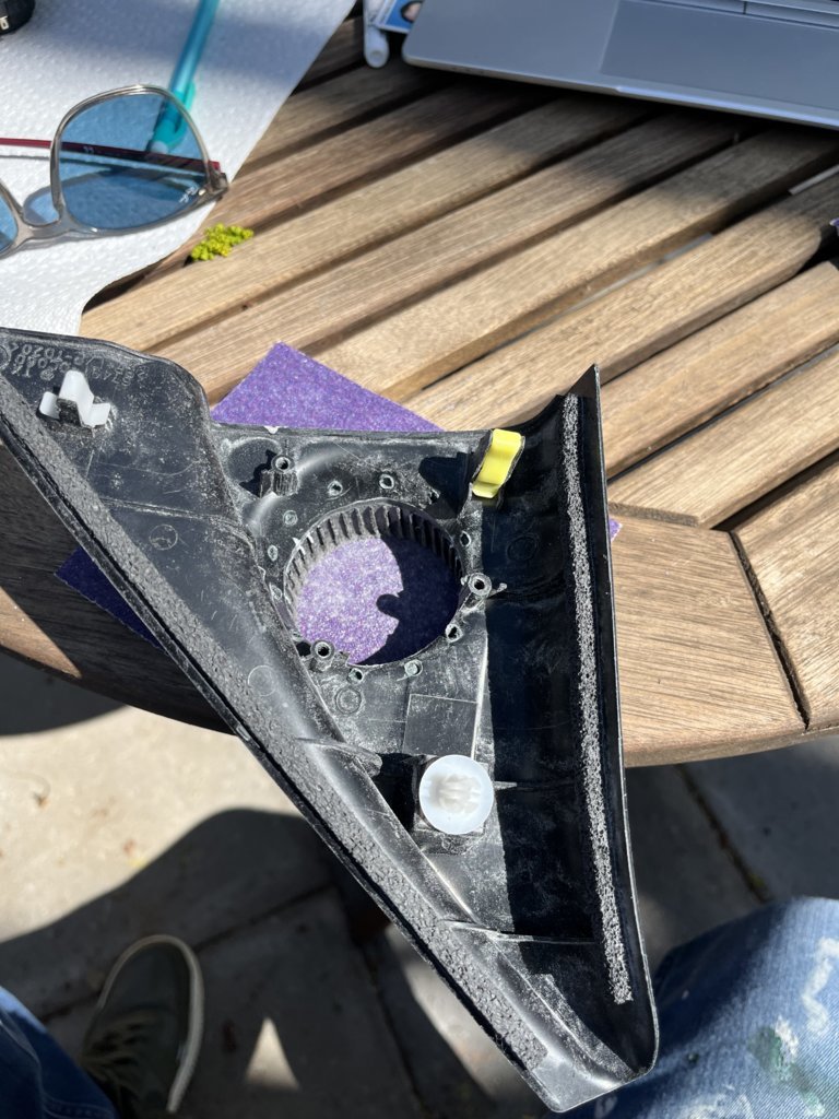

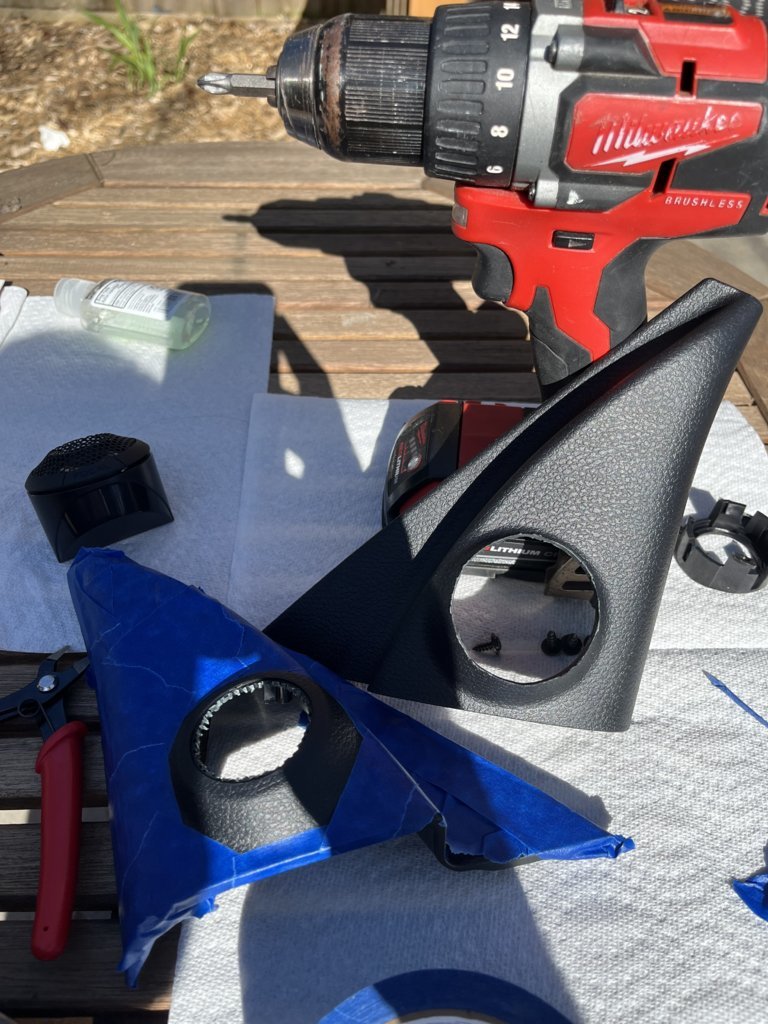

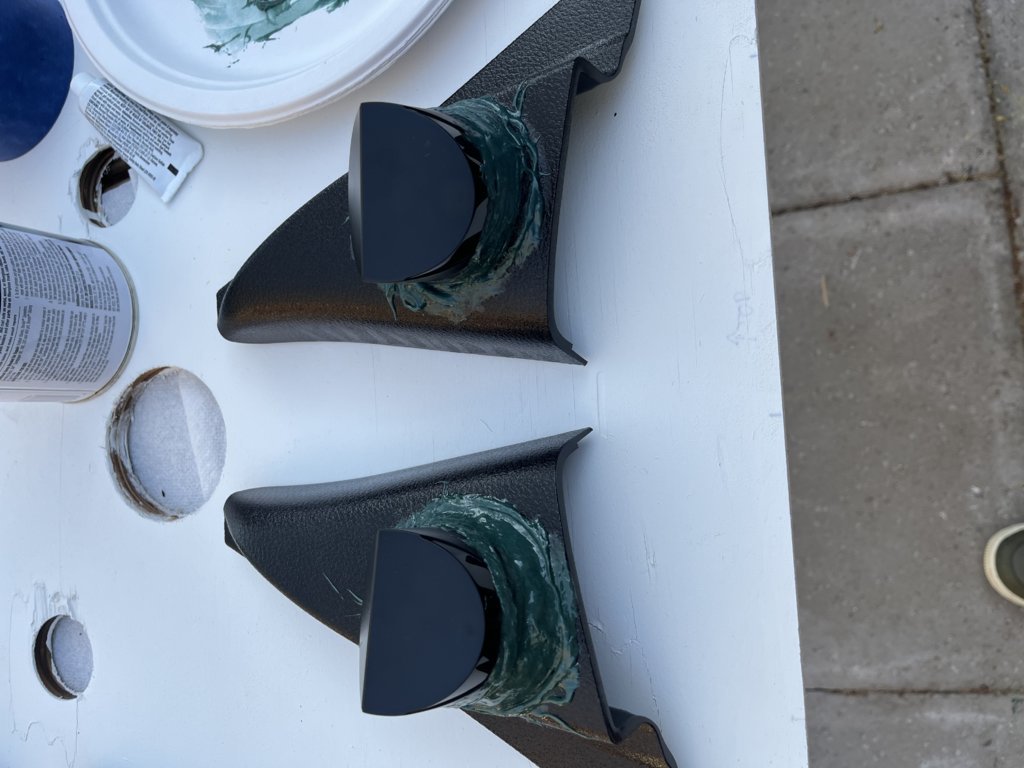

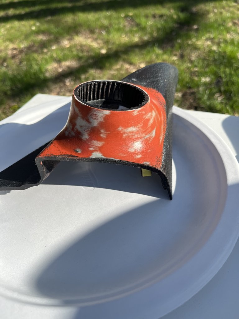

    Fit was decent, but no way to secure and there was a noticeable overhang/lip so I used stranded body filler, the Frak included cups, glazing putty, SEM texture coat and SEM trim black to build custom sails.
    upload_2025-9-8_15-28-39.jpgupload_2025-9-8_15-28-39.jpgupload_2025-9-8_15-28-39.jpgupload_2025-9-8_15-28-39.jpgupload_2025-9-8_15-28-39.jpgupload_2025-9-8_15-28-39.jpgupload_2025-9-8_15-28-39.jpgupload_2025-9-8_15-28-39.jpgupload_2025-9-8_15-28-39.jpgupload_2025-9-8_15-28-39.jpgupload_2025-9-8_15-28-39.jpgupload_2025-9-8_15-28-39.jpgupload_2025-9-8_15-28-39.jpgupload_2025-9-8_15-28-39.jpgupload_2025-9-8_15-28-39.jpgupload_2025-9-8_15-28-39.jpgupload_2025-9-8_15-28-39.jpgupload_2025-9-8_15-28-39.jpgupload_2025-9-8_15-28-39.jpgupload_2025-9-8_15-28-39.jpg

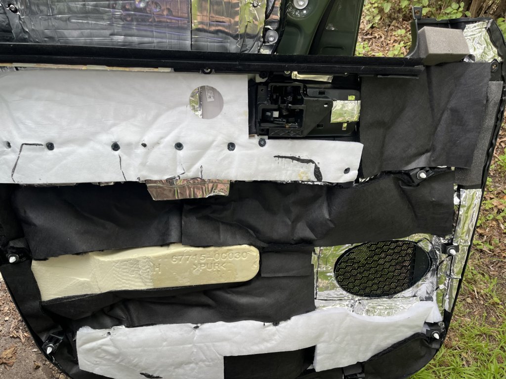

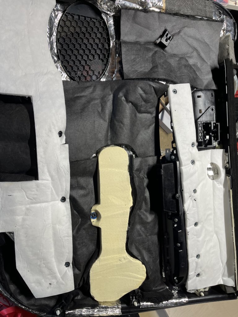

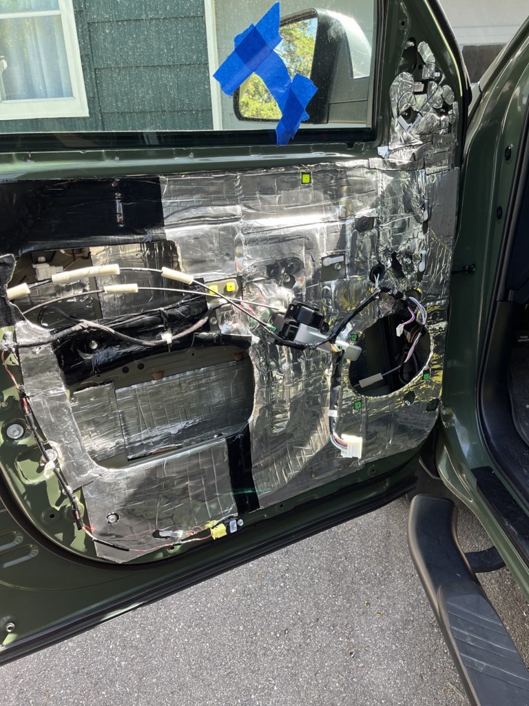

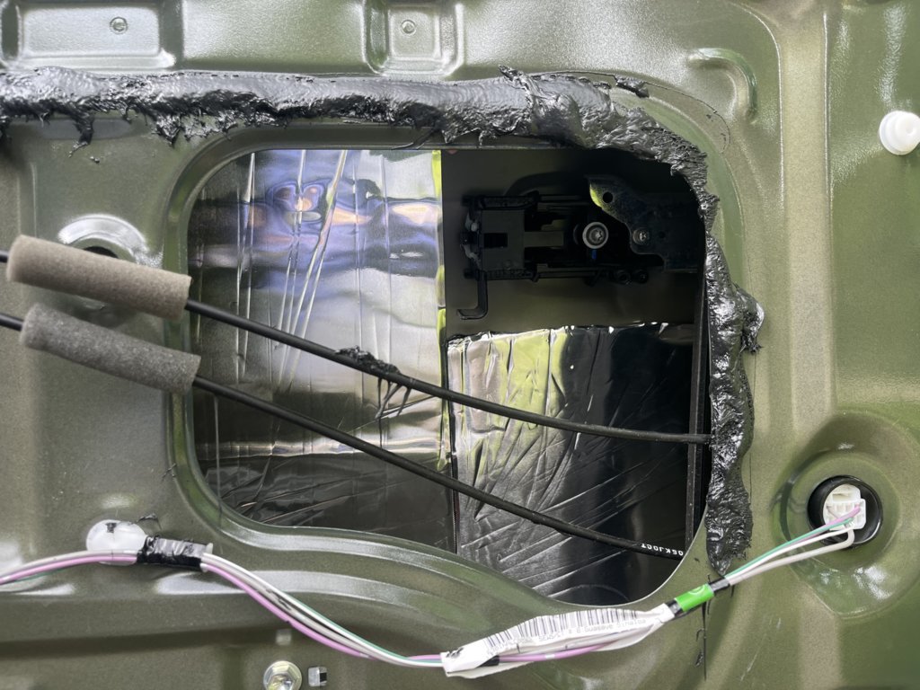

    Used Resonix CLD/sound deadener on all the doors and rear wall:
    upload_2025-9-8_15-37-1.jpgupload_2025-9-8_15-37-1.jpgupload_2025-9-8_15-37-1.jpgupload_2025-9-8_15-37-1.jpg

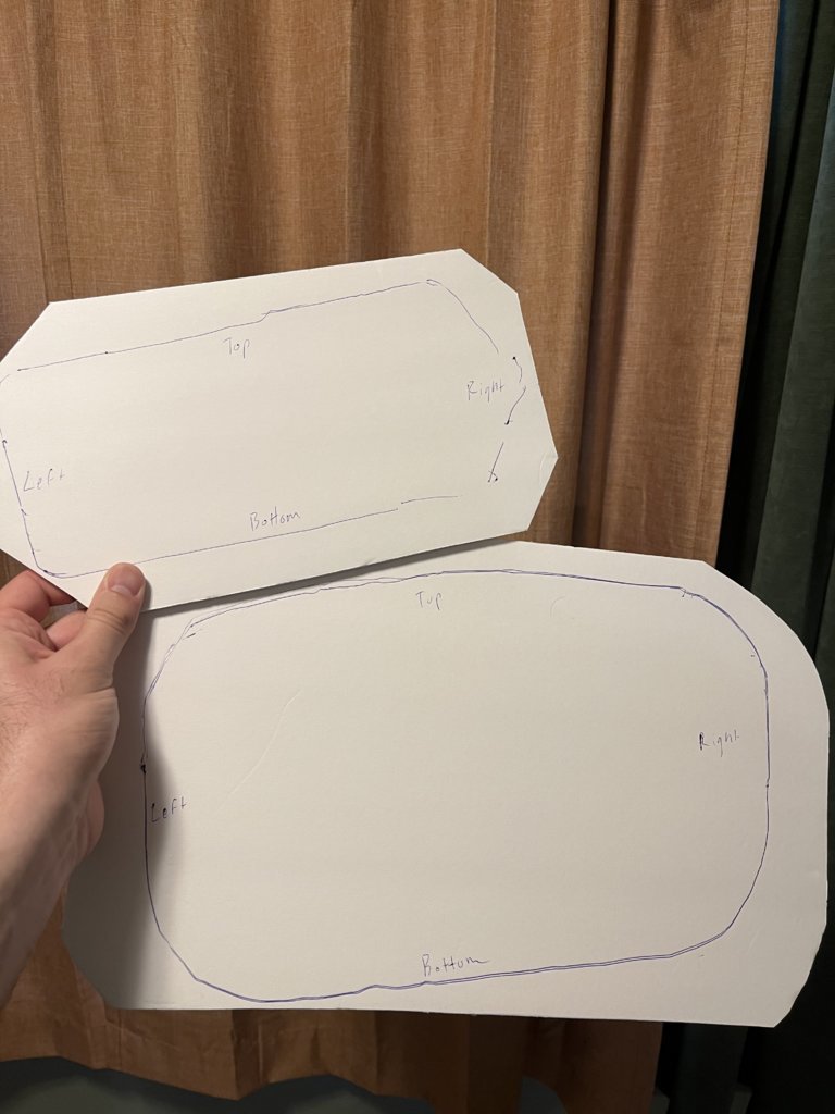

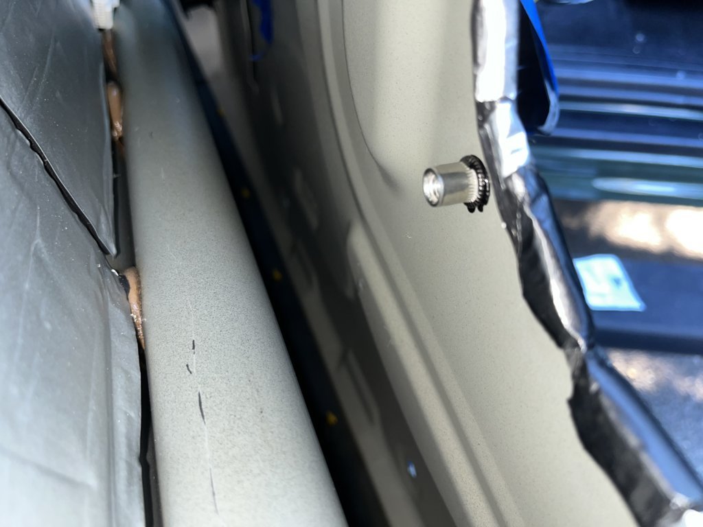

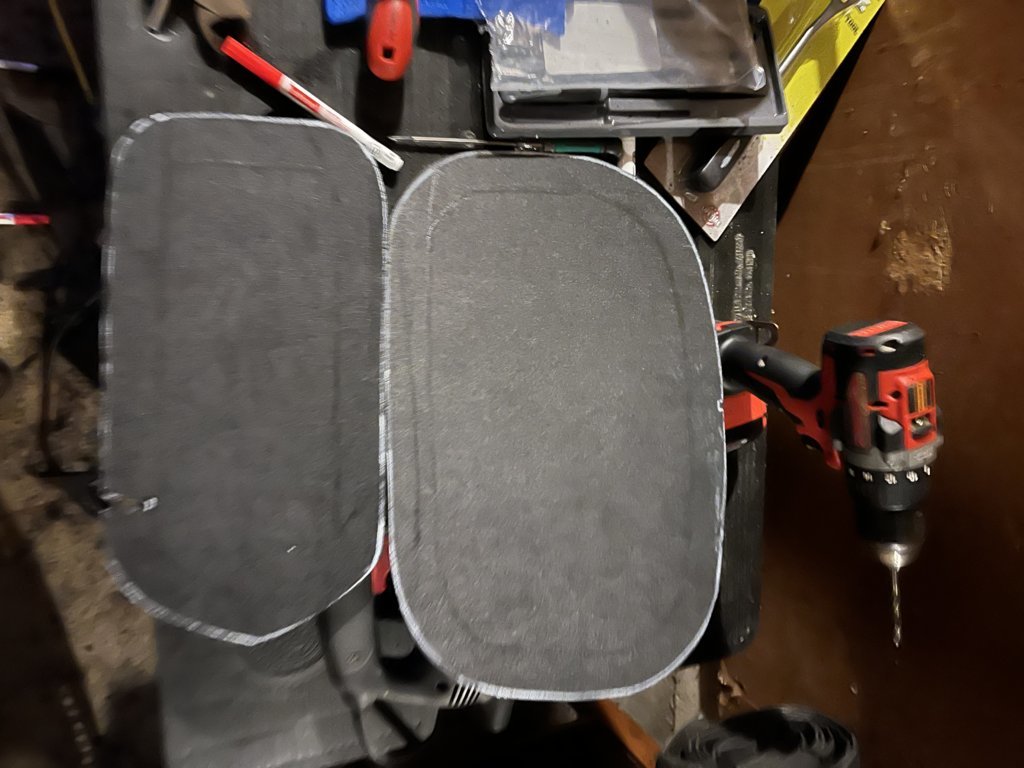

    DIY’d block off plates using HDPE and rivet nuts/machine screws to attach them:
    upload_2025-9-8_15-39-6.jpgupload_2025-9-8_15-39-6.jpgupload_2025-9-8_15-39-6.jpgupload_2025-9-8_15-39-6.jpg

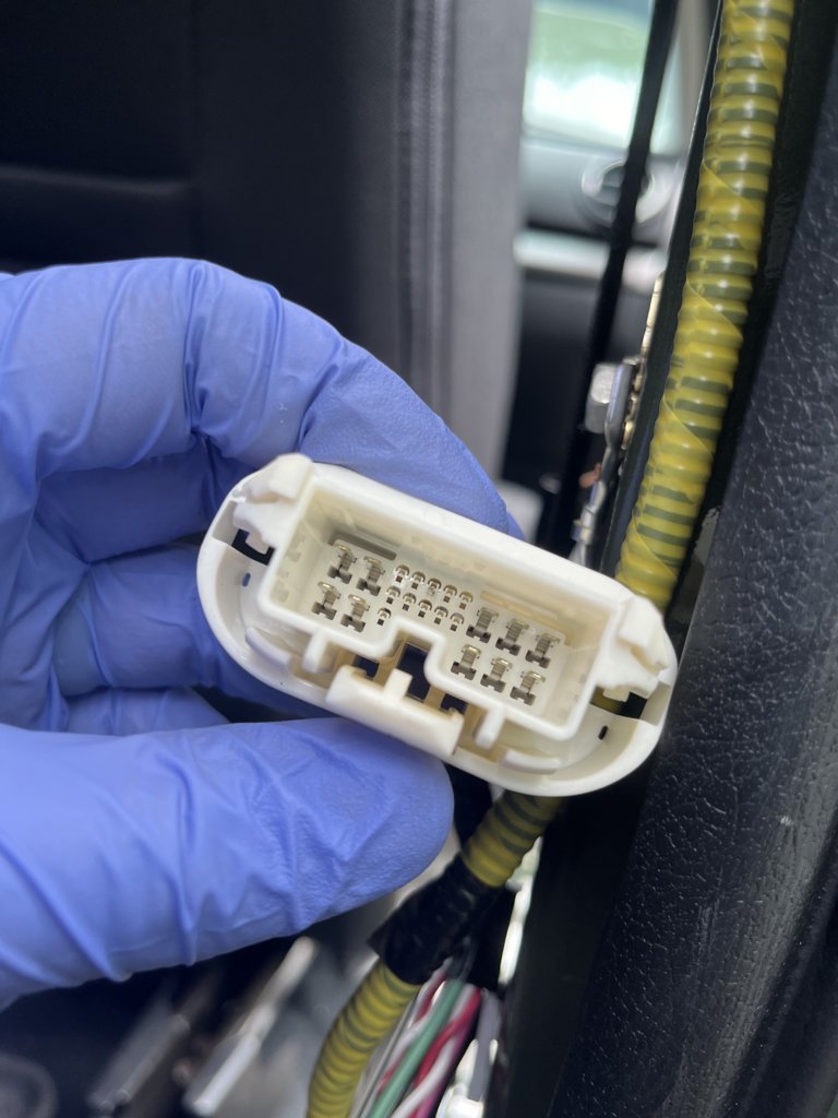

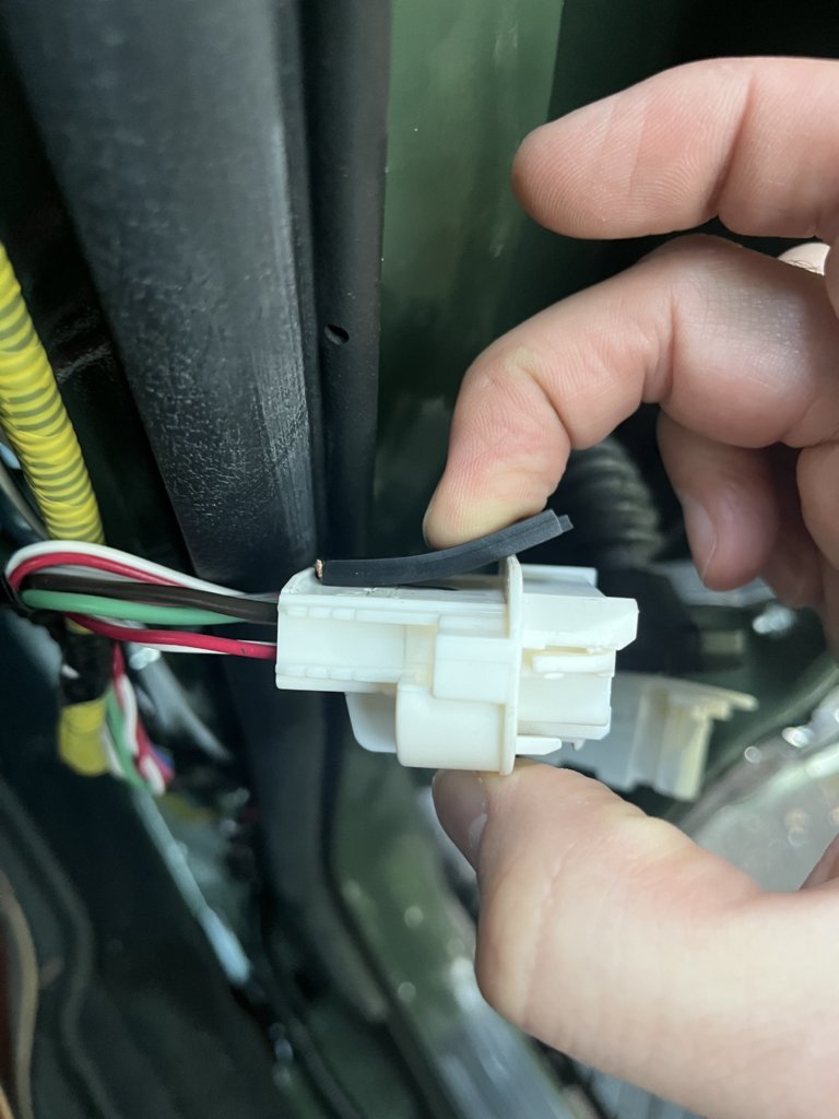

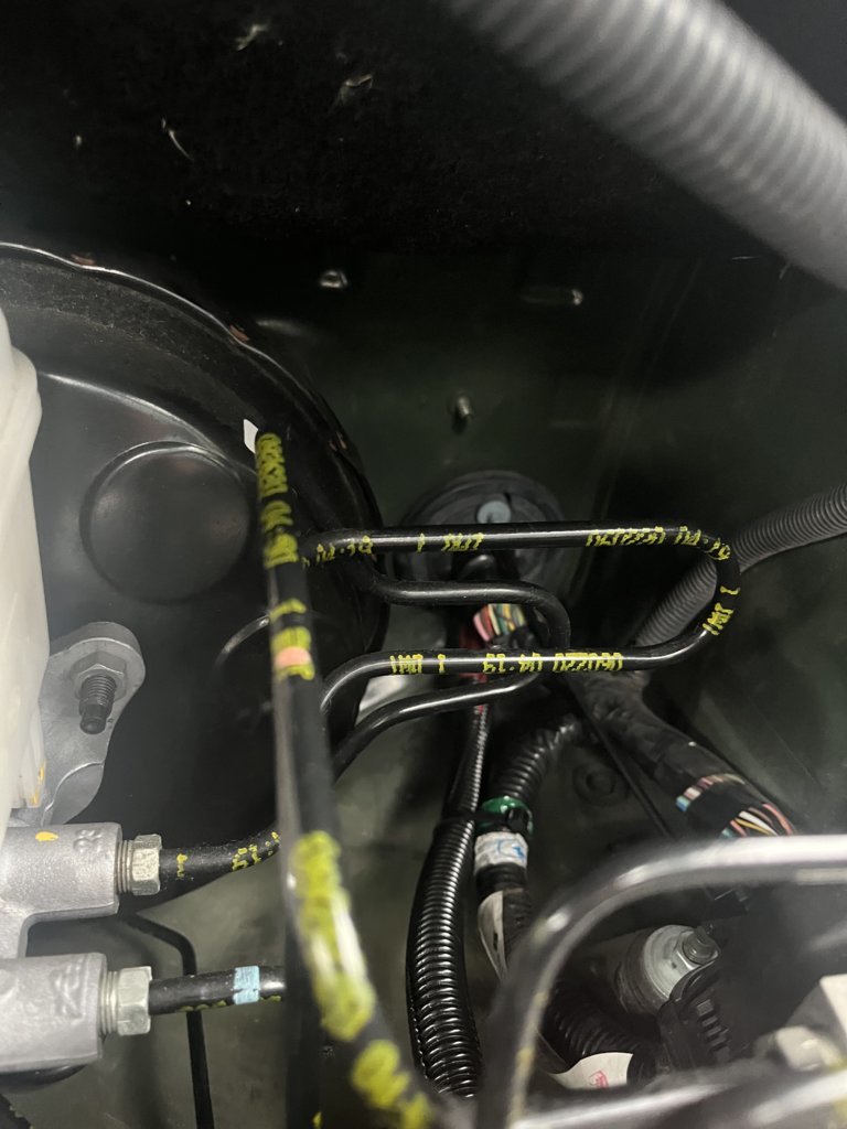

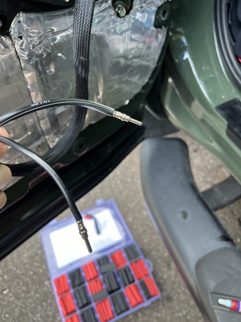

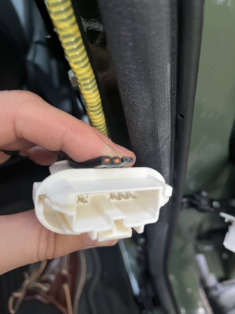

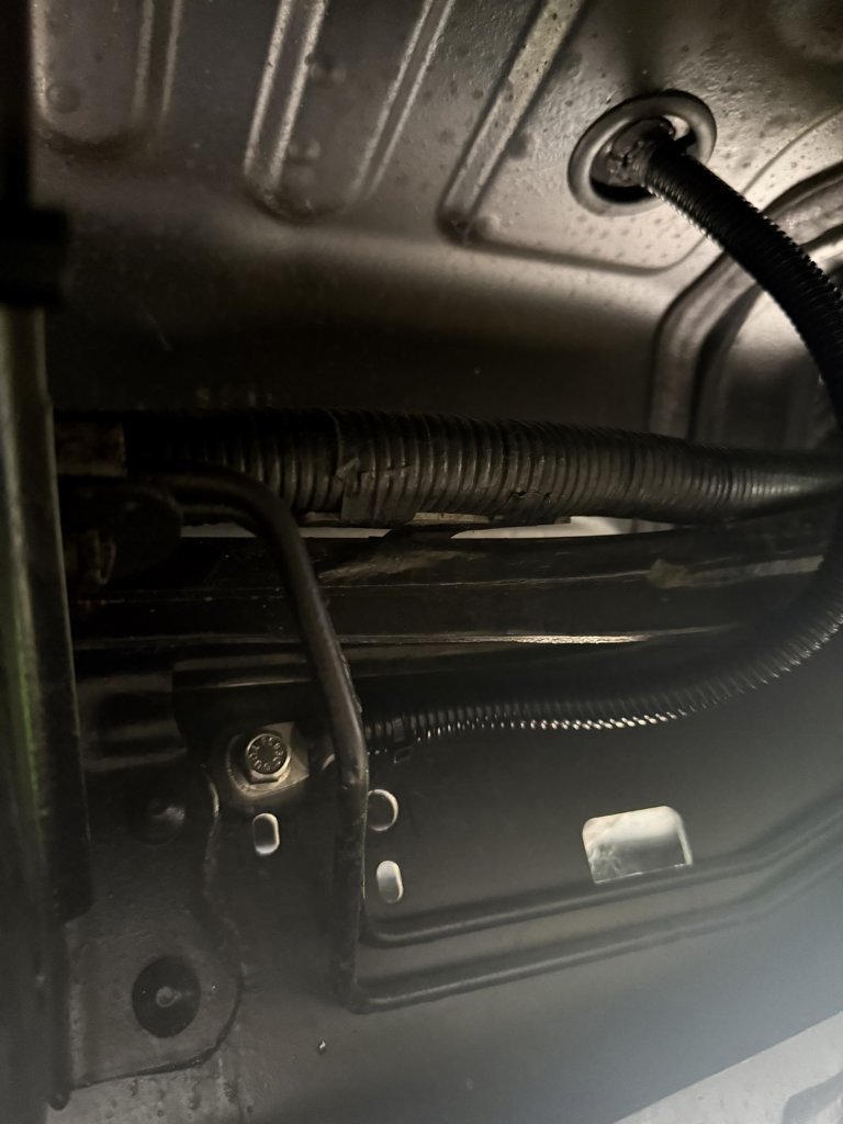

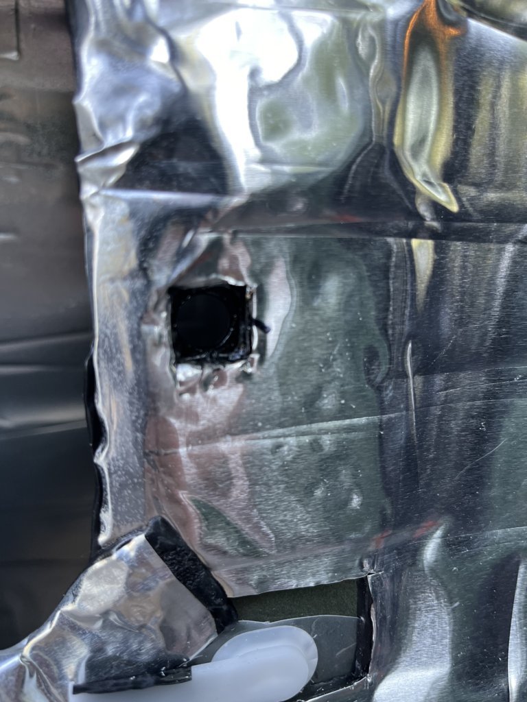

    Ran new wiring to each door, fronts were the usual grommet to door, but the rear doors/drilling out connectors was both nerve wracking and a pain.

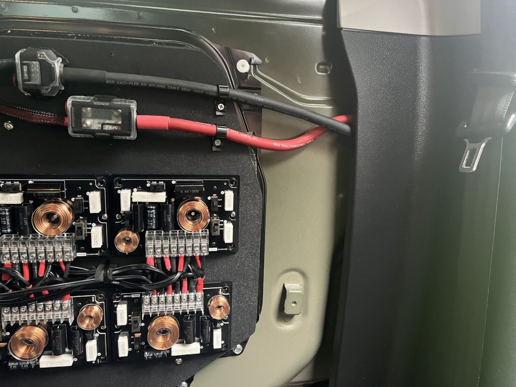

    For power, I originally had a single fuse holder on a janky diy hdpe bracket. I’ve since added another power cable going to my center console for 4 heated seat circuits.

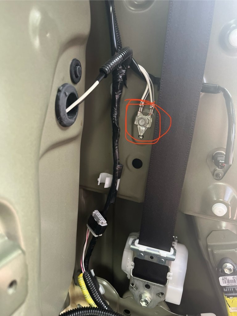

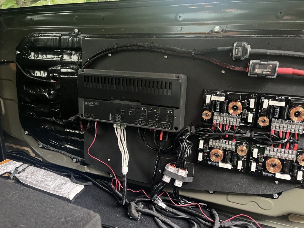

    This was my original amp rack, grounded to a factory ground point behind the driver’s side c-pillar trim. I’ve since tested and moved to a frame ground for less resistance (pics further on)
    upload_2025-9-8_15-46-6.jpgupload_2025-9-8_15-46-6.jpgupload_2025-9-8_15-46-6.jpgupload_2025-9-8_15-46-6.jpg

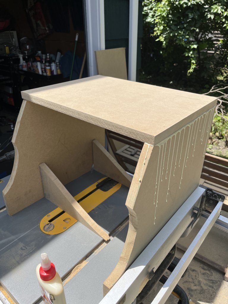

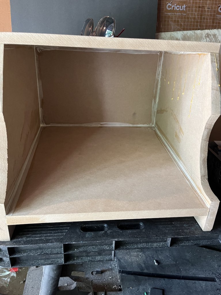

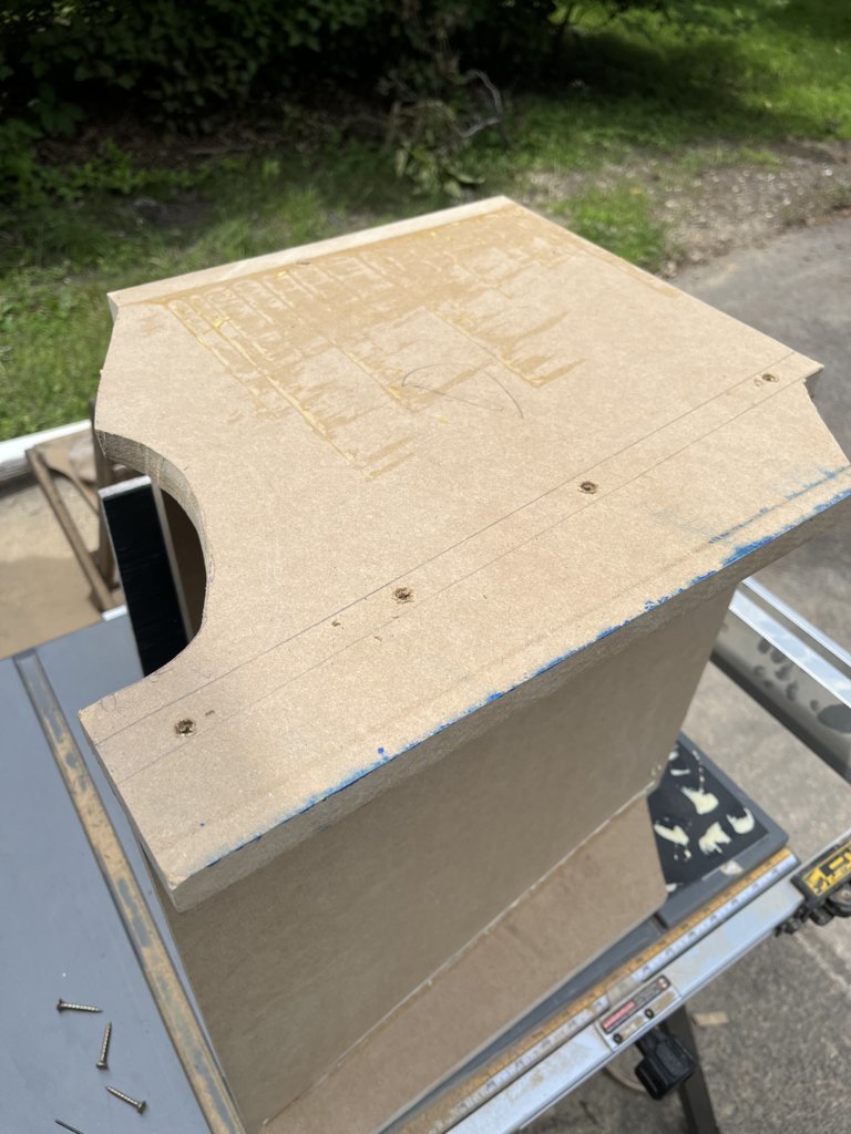

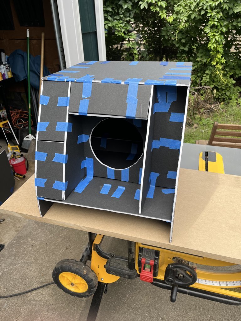

    I wanted to re-use a JL 8W7 I’ve had for a few years as the sub, so I built a center console extension box, mocked up using foam board from the dollar store, big fan/proponent of that stuff.
    upload_2025-9-8_15-50-37.jpgupload_2025-9-8_15-50-37.jpgupload_2025-9-8_15-50-37.jpgupload_2025-9-8_15-50-37.jpgupload_2025-9-8_15-50-37.jpgupload_2025-9-8_15-50-37.jpgupload_2025-9-8_15-50-37.jpgupload_2025-9-8_15-50-37.jpg

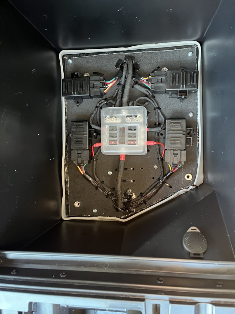

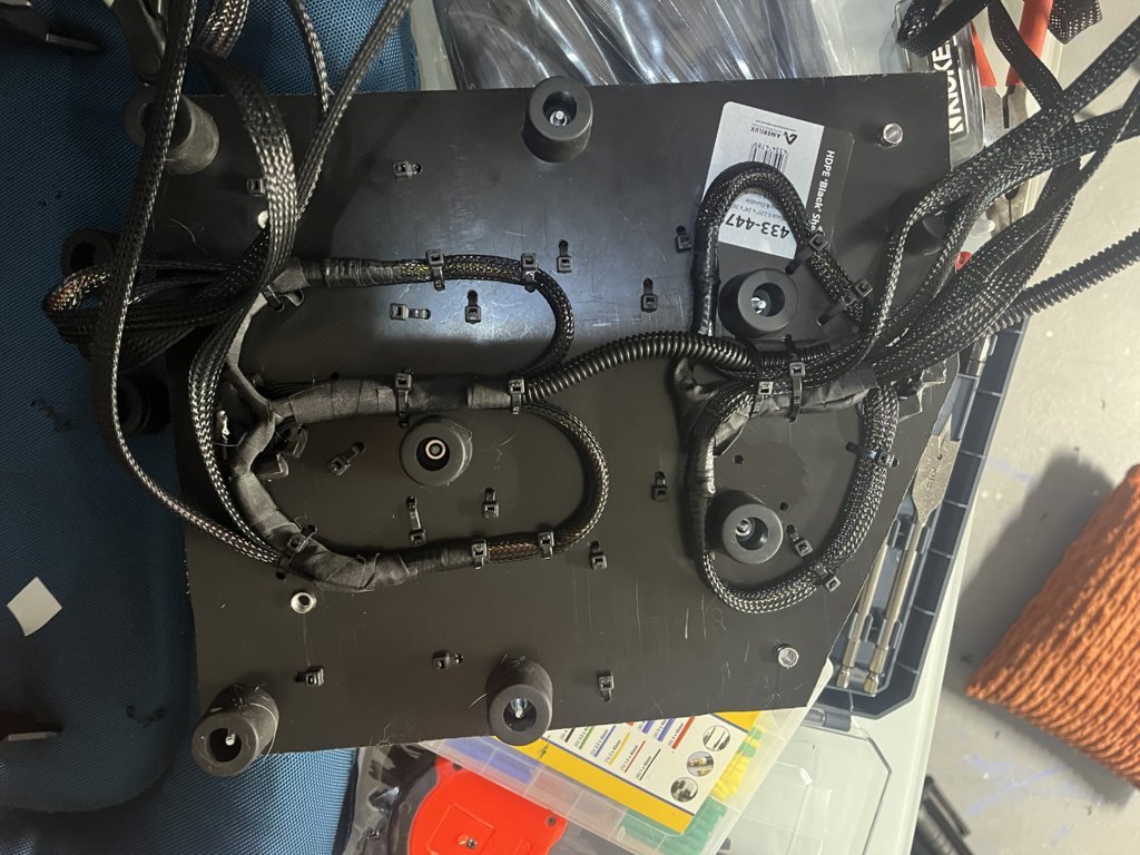

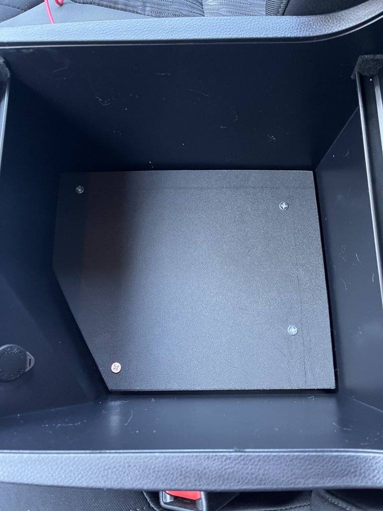

    Semi-related center console heated seat stuff, but also going to be mounting a digital audio converter here. HDPE panel that sits on rubber feet in bottom of the center console with a sandwich lid, essentially lose a couple inches of depth to do this.
    upload_2025-9-8_15-52-52.jpgupload_2025-9-8_15-52-52.jpgupload_2025-9-8_15-52-52.jpgupload_2025-9-8_15-52-52.jpgupload_2025-9-8_15-52-52.jpgupload_2025-9-8_15-52-52.jpg

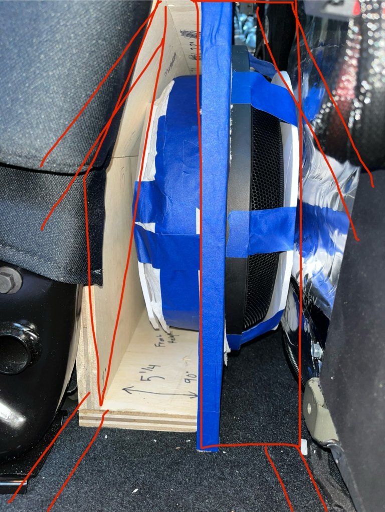

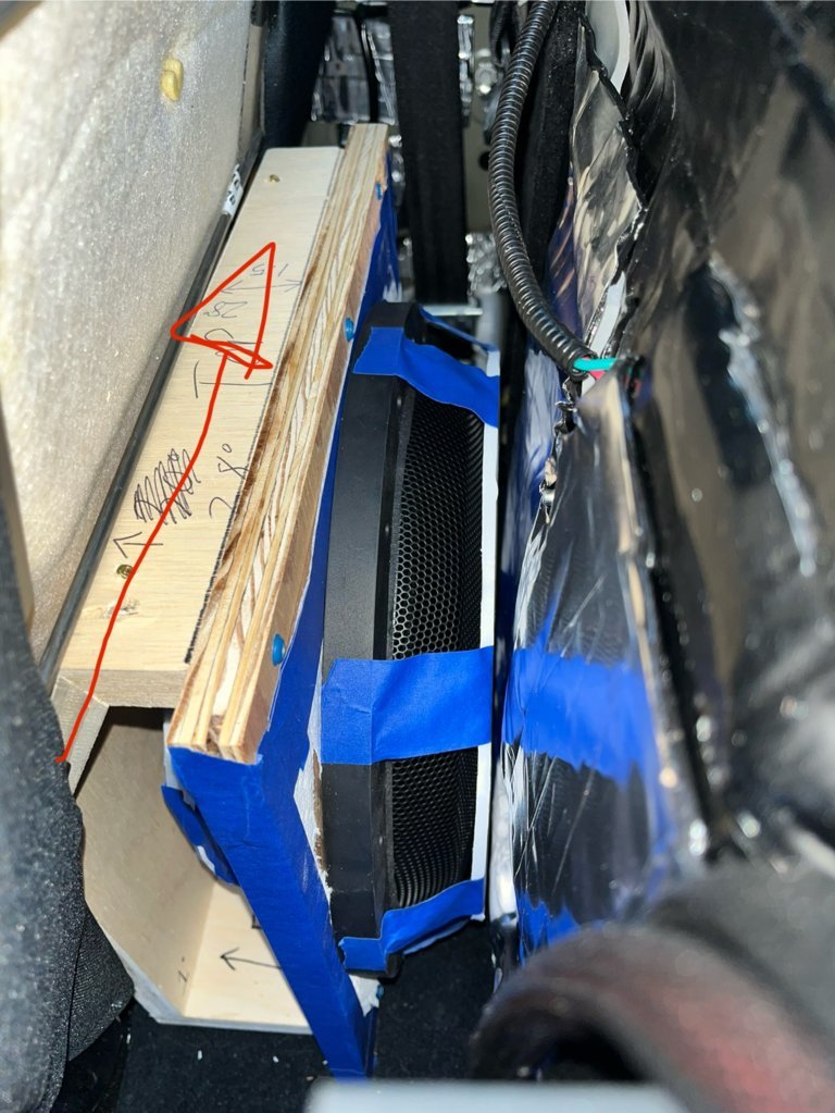

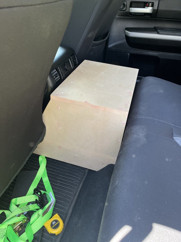

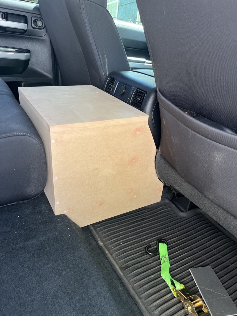

    Really wanted to fit an Audiomobile Encore sub and removed the rear seats, threw some leftover deadener from other projects down, mocked up the sub and couldn’t find a way to make it fit. Opted to go with a Wavetech thinPRO 12 rear firing similar to the JL stealth box.

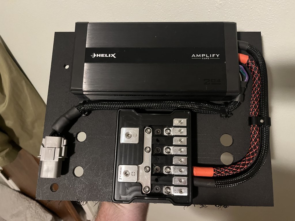

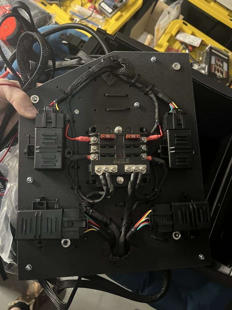

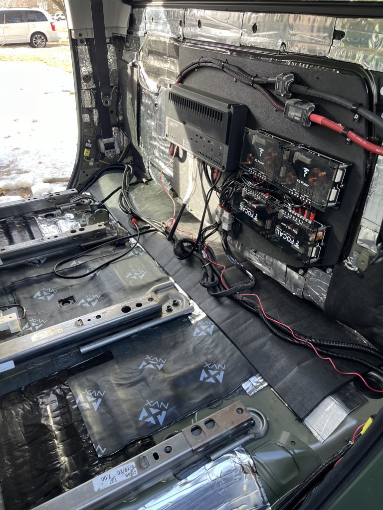

    For the new amp rack since I’ve got 3 amps going in, I opted to get the ESP Truck Accessories underseat locking storage box. Holes drilled in the box and hdpe panels with grommets for wire pass throughs. Amps etc. are mounted with heat inserts in the hdpe.

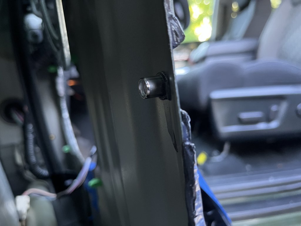

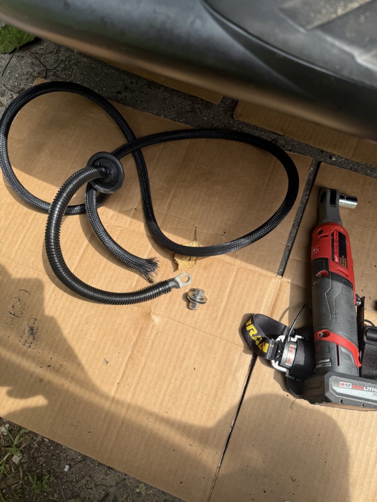

    Did a frame ground for less resistance than anywhere inside the cab after multimeter testing multiple locations.

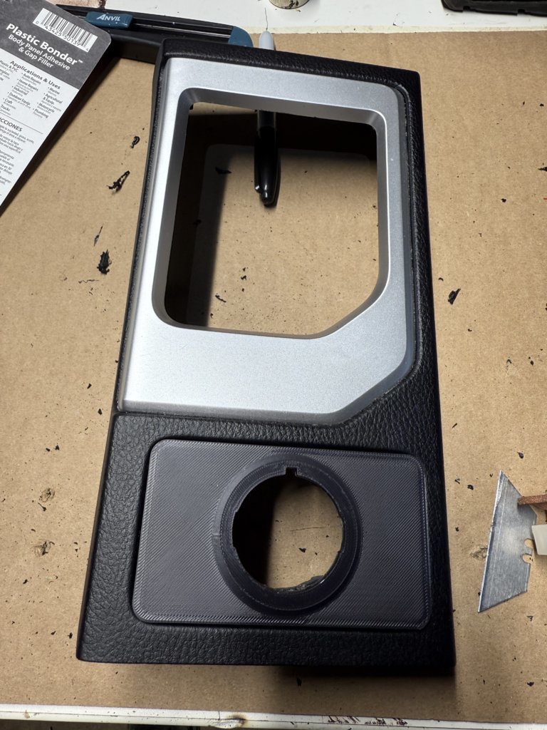

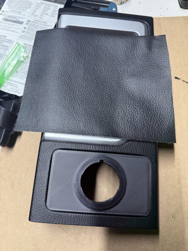

    Helix conductor switch with a 3D printed top panel glued onto @RainMan_PNW’s switch panel for the shifter area, waiting on DAP la day delivery to finish wrapping it in vinyl pleather

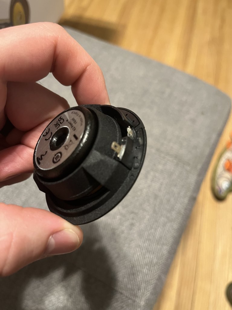

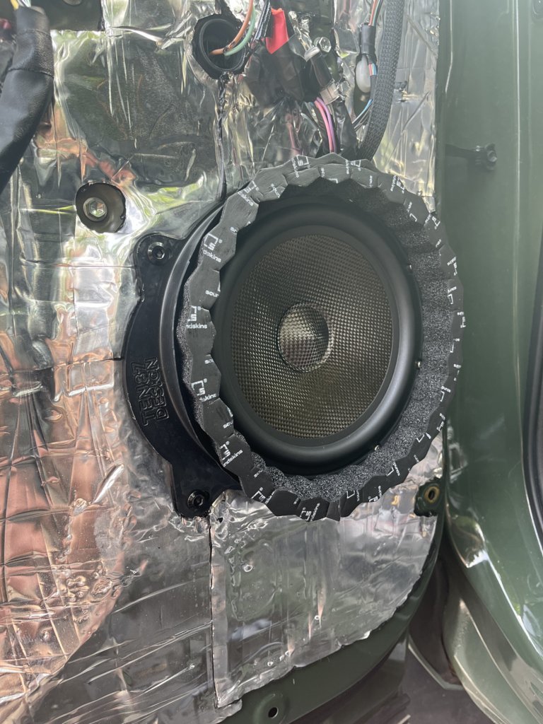

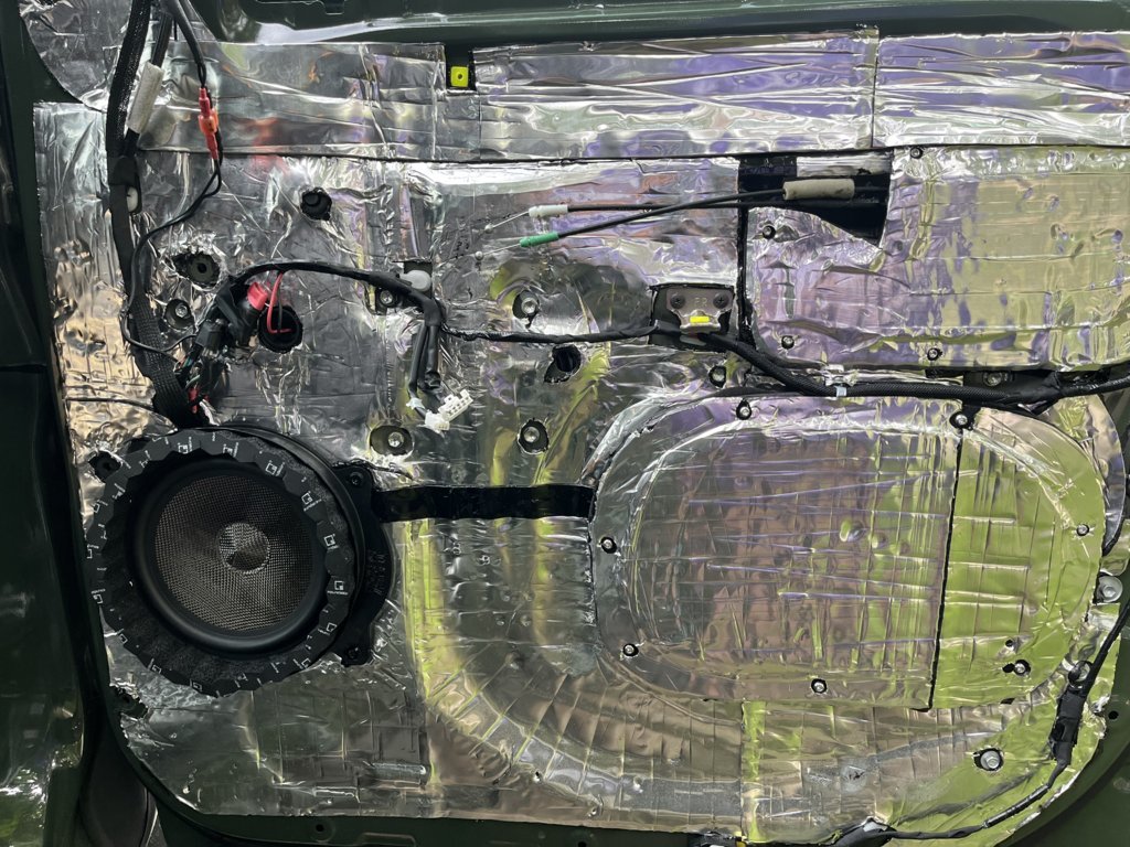

    Added fiber mat to the front doors along with more CLD and butyl rope while I had the door panels off to mount the new front midbasses.

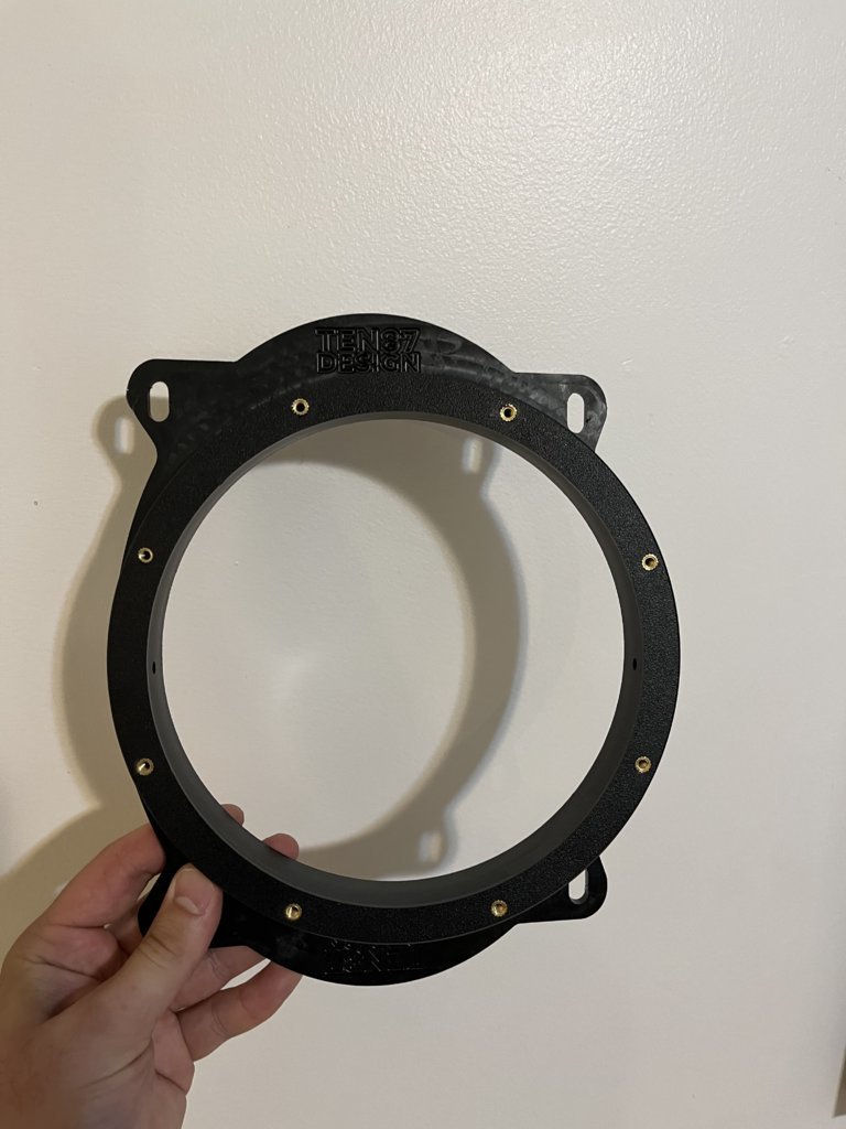

    Ordered 8” brackets from the awesome guys at Sounds Good Stereo and added heat inserts for mounting. CCF rings to help channel sound into the cabin.

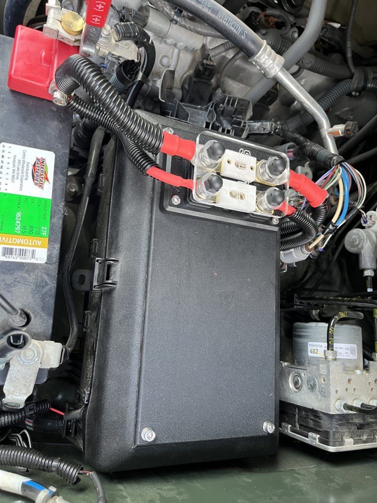

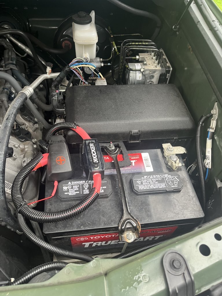

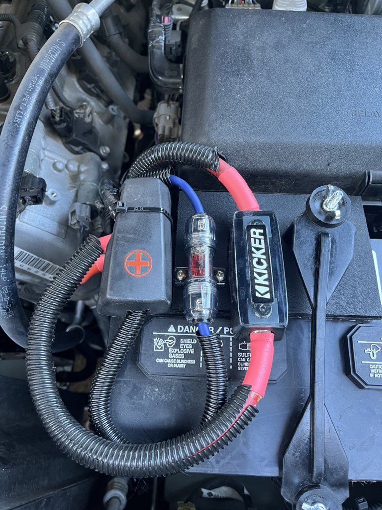

    Added Knu Conceptz battery post terminals and an SMD fuse holder, along with a HDPE panel mounted to the top of the OEM fuse cover.

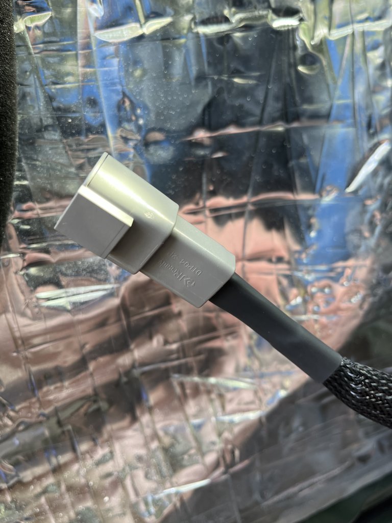

    Some random diy custom cables, big fan of Deutsch connectors for ease of use and quick waterproof connections especially for inside the doors.

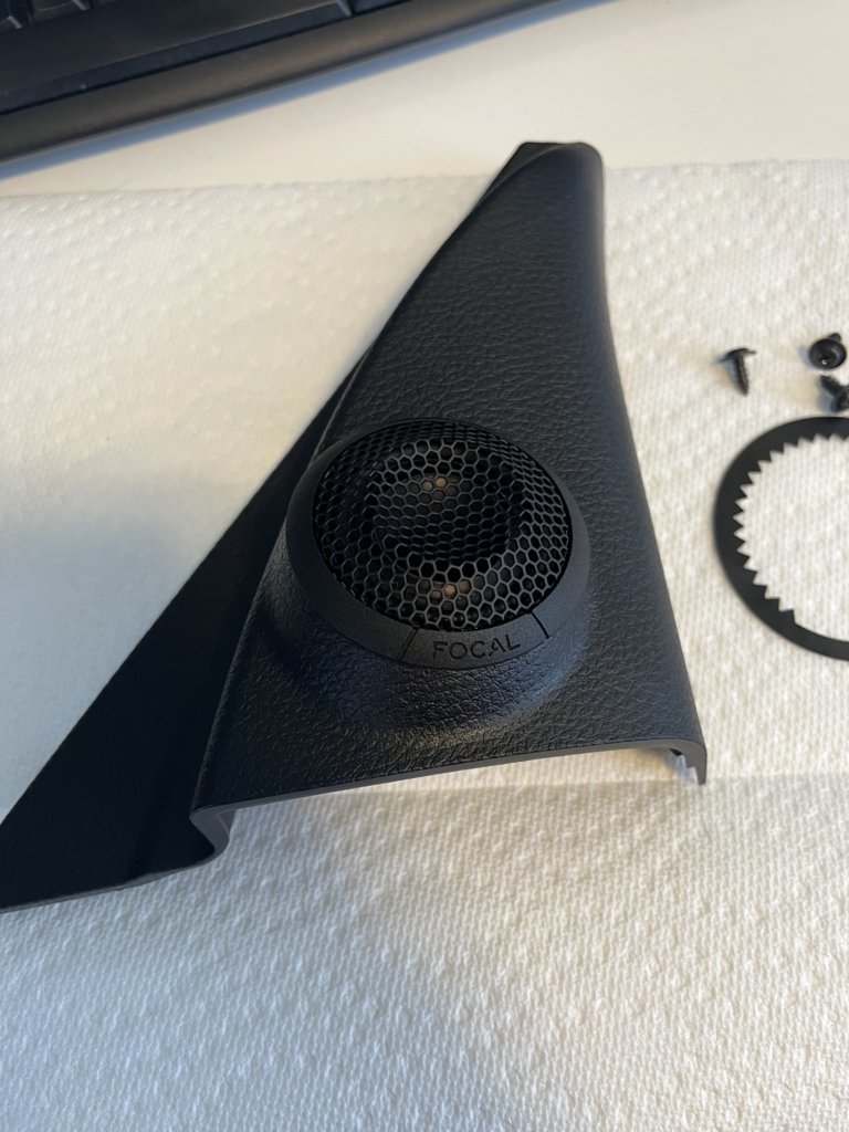

    That’s all for now. Will have more to post in the coming weeks/months as I finish custom mounts/panels for the midranges going into the dash corners and tweeters in the a-pillars.

    What do you think about the block off plates - worth it? I have a large piece of HDPE just begging to be used to build some block off plates.

    Edit: @blenton forgot to answer your question about the block off plates, I don’t have an A/B before/after comparison so I can’t say wholeheartedly exactly how much of a difference they make, but IMO they’re worth it. The midbass I got out of the K2 6.5’s was honestly pretty impressive, obviously they’re midbasses so they didn’t play super low but I was getting pretty impressive output from them, definitely the best midbass I’ve had in a personal vehicle and I attribute a lot of that to the block off plates tbh. I know Sounds Good Stereo makes/sells them as well, but they were a fun project to DIY and learn to use a rivet nut tool. Only thing I’ll say is that be careful how thick you make them and/or the thickness of foam you use to decouple them. I used CCF around their perimeter to decouple them from the doors and create a better seal which worked well but my door panels are exceedingly tight to get back on, to the point I used a heat gun to soften/bend the top ones in a bit. Overall if you want a somewhat time consuming project that’s not too expensive, I’d say go for it!
