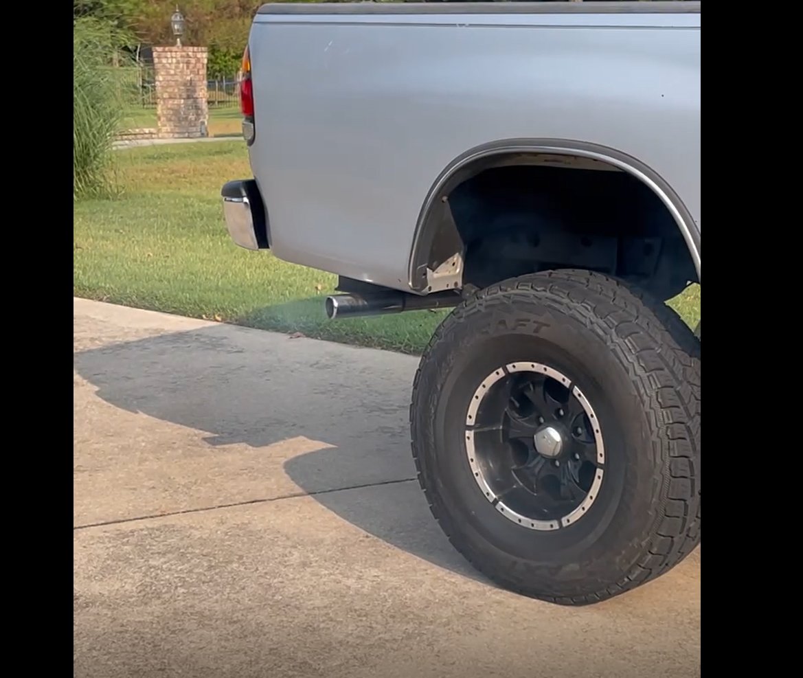

    2000 4.7 V8 Tundra smoking on startup. Smells of gas rather than a sweet coolant smell, but I don't know enough to rule that out yet. Any tips or ideas? Goes away after a short time running, and isn't as pronounced if it hasn't been sitting a while.
    These pics are within 5 seconds of each other (couldn't post the video for some reason).

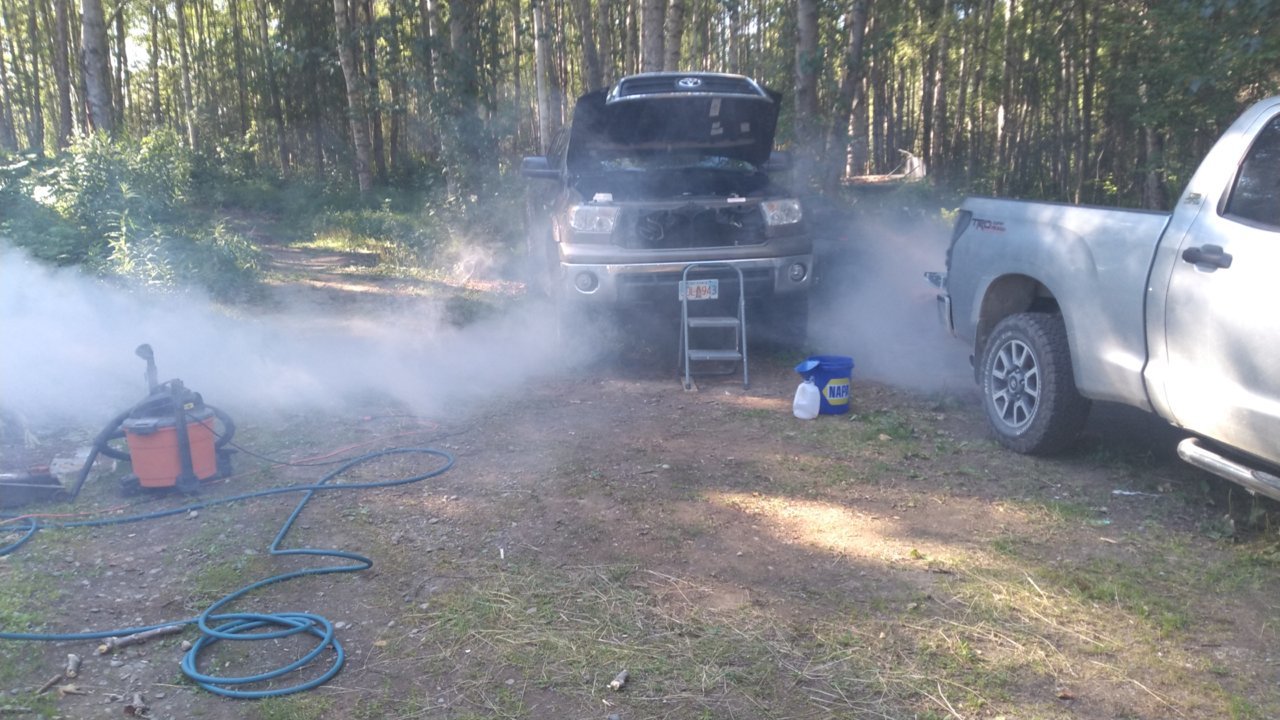

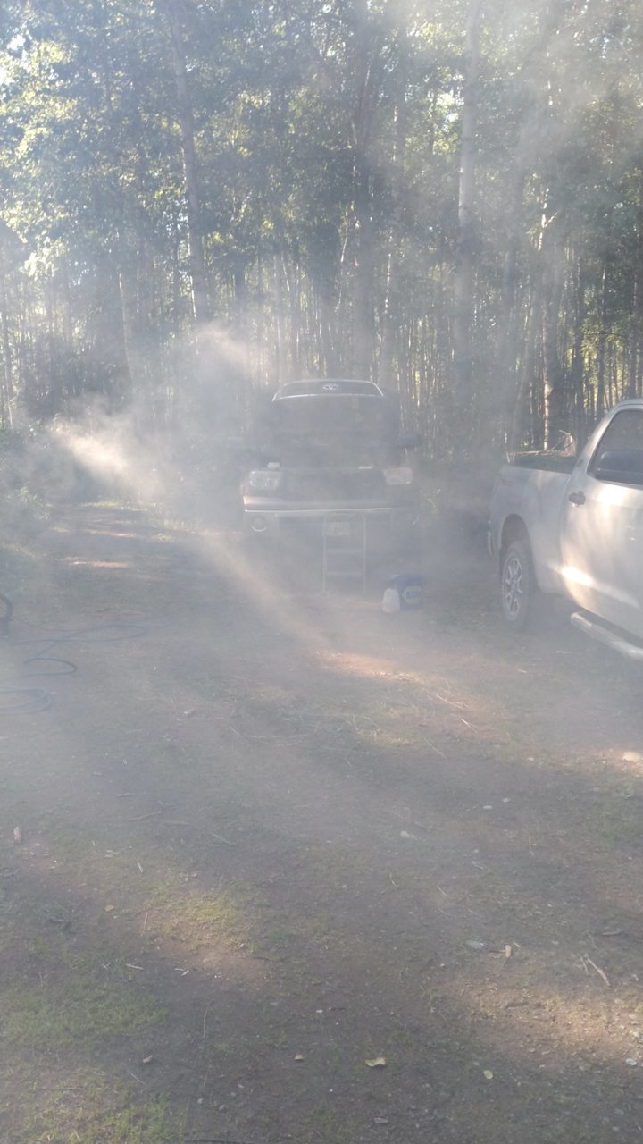

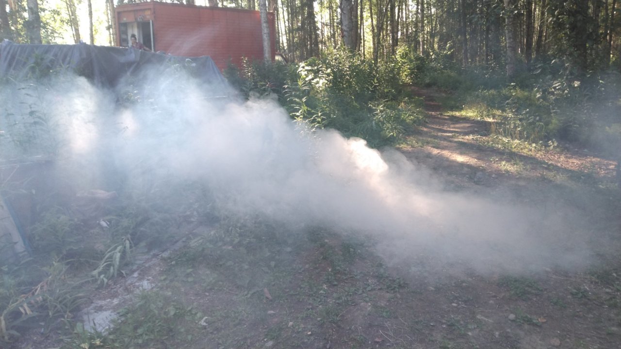

    Looks like oil smoke from the pics, here's my 2nd gen smoking like your 1st gen.KIMG1137.jpg KIMG1138.jpg KIMG1136.jpgthats about 10-15 seconds after start up!

  16. Aug 23, 2021 at 11:54 AM

    If it's oil burning the smoke will be a bluish-white. Yours looks more whitish but it may be the pic or my tired eyes. Lol. So, if it's valve seals (oil-related) the smoke will be bluish-white.

    There has never been a blueish tint to the smoke (to my eyes anyways), regardless of how long it sat between startups. It is that puff of pure white smoke, then clears up almost instantly.

    I'm sticking with oil smoke, OP's pick looks blueish grey just like my oil burner
