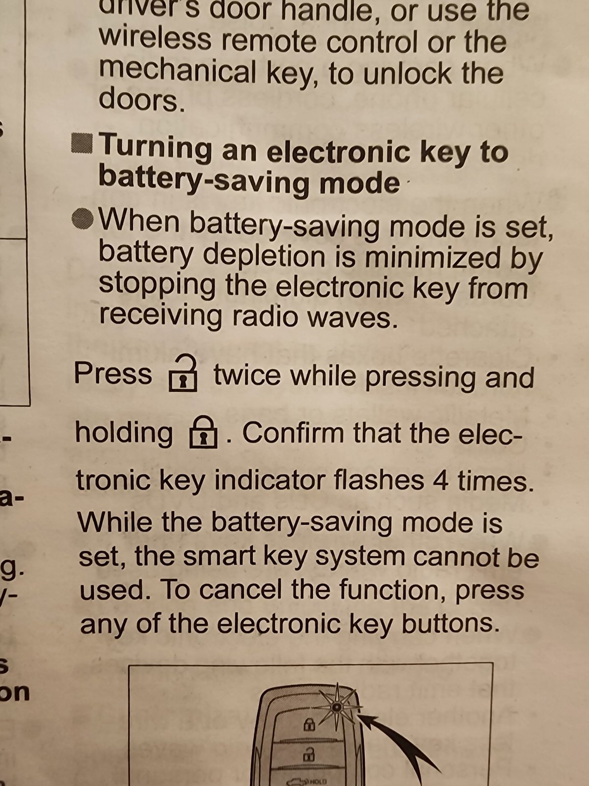

    The Toyota FOB can be turned off to save battery, too.
    So, if you lose your main FOB, and your backup is locked in the truck, you'd rather bust a window?

    How do you turn the FOB off? If my spare FOB was in the truck, the physical key to get in the door would be in my paw.

    The beauty of an owners manual:)

    Indeed. Thank you for that.
    DRP[QUOTED] likes this.

    This is probably more of anti-theft feature. Some of the more enterprising thieves have code capturing devices and most of us hang our keys by the garage so they patrol looking for a nice ride, capture your code emanating from you, duplicate it and away they go.
    Thanks for the screen grab - I just tried it and it works! Have to make it a habit when i come in.
