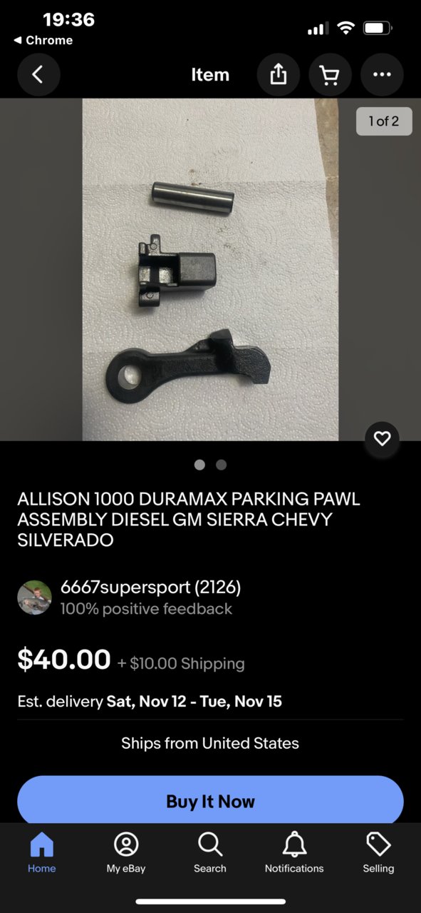

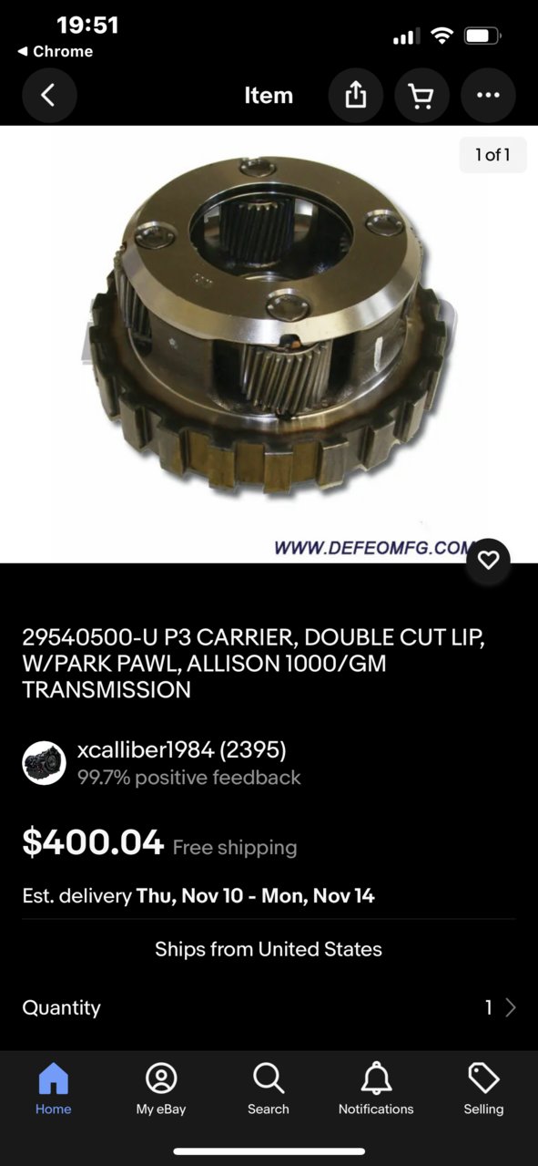

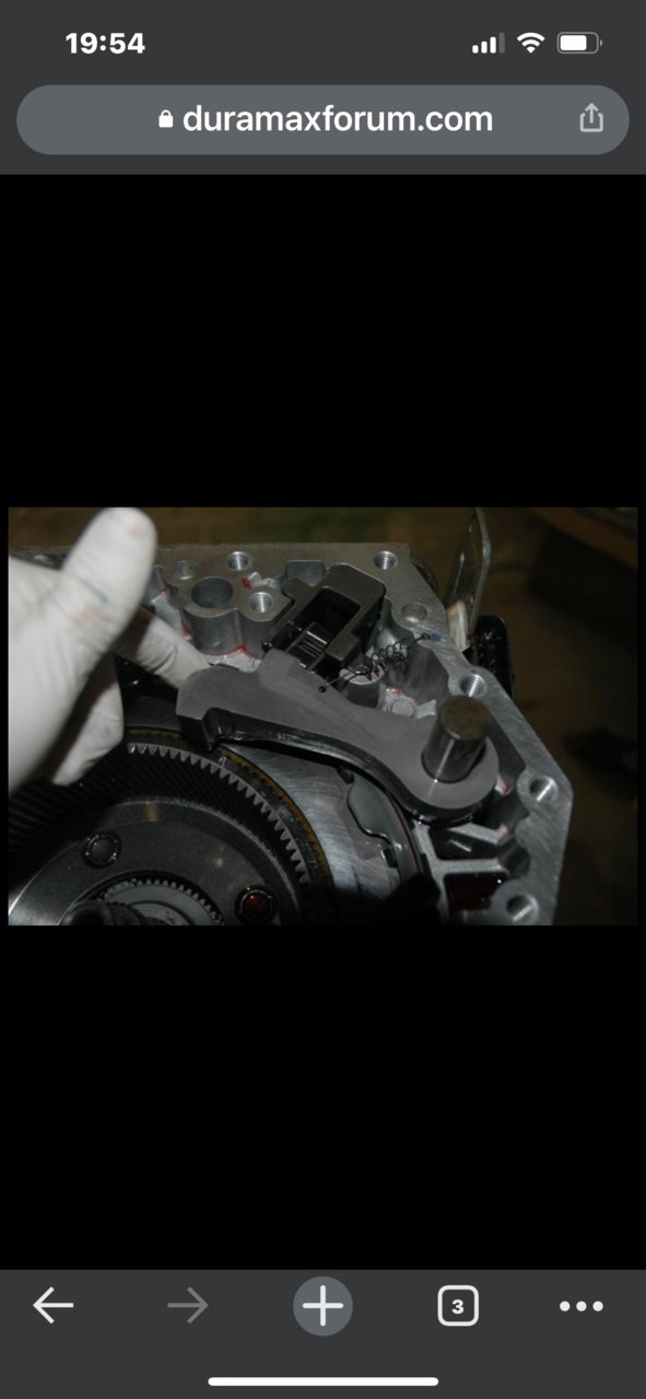

  11. Nov 6, 2022 at 5:37 PM
    ColoradoTJ
    Feb 24, 2016
    #2766
    40,640
    The Allison has a pawl…??

    I thought it did have a pawl and remember seeing pictures of it (never been inside an Allison). This unit is designed to hold 30,000 lbs….which is ridiculous.
    6F5C1EAF-6E82-41B8-8EE8-D8A88FF2378A.jpg F7150CD1-8A6A-471A-9954-4AFF4AC6B3A3.jpg 97D4BB3B-02F7-4865-B4A6-8F89047115B0.jpg
    Black Wolf[QUOTED] and Luckydog like this.
