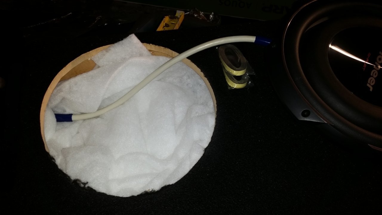

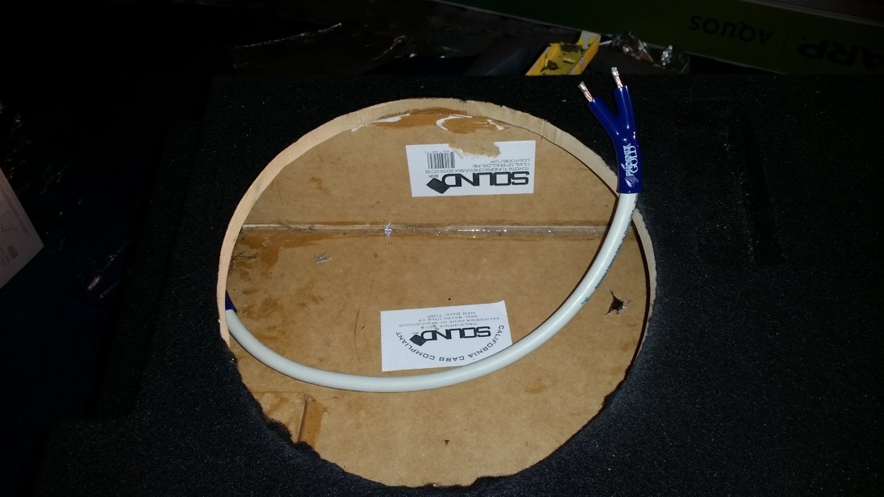

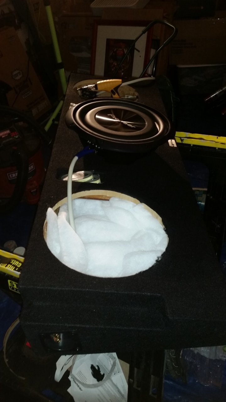

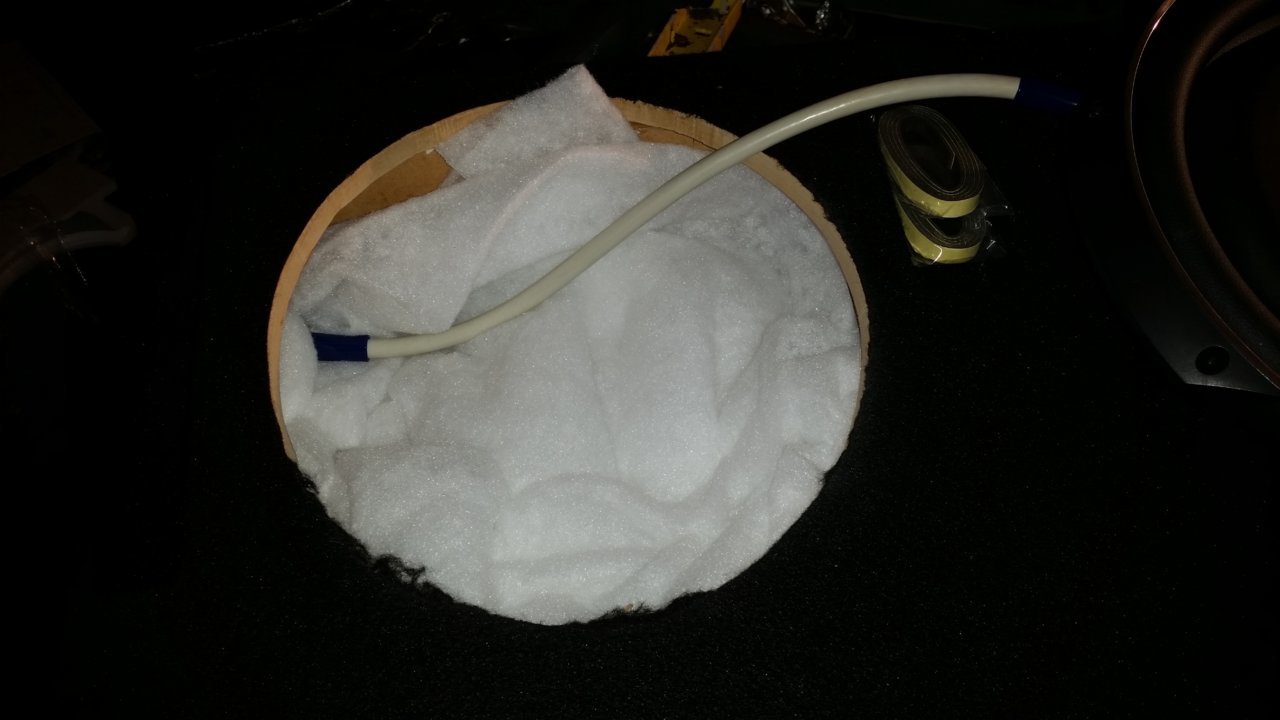

    Sub Enclosure
    Well the past couple of weekends I have been playing around with the sub enclosure. A lot had to be done to get it to where it is. The precut holes needed to be opened up to accommodate the Pioneer subs. The inside of the box was kinda, sorta, almost maybe sealed with a really bad white caulk that was pretty hard. I ended up resealing the entire cabinet on all seams with a clear GE silicone. Filled the cavities with fiberfill to slow the sound wave down and trick the subs in to thinking they are in a larger enclosure than they are. Added some Phoenix Gold cables with pants soldered all the connections and tinned the ends of the cables. Added the foam seal to the mount ring of the subs. Predrilled all of the holes for the screws and then hand tightened all of them to make sure maximum holding power was there without stripping any of the holes out. The subs are fully sealed now and air tight. Unfortunately due to clearance issues between the sub and where Pioneer places the terminals at I had to rotate the subs 90 degrees to allow room for the speaker cable to attach to the subs. So the logos are not how I would have liked them to be. Step 1 complete. The down side to not developing a full custom enclosure. But it was a lot cheaper and less time consuming doing this. Again, not a full competition beauty queen. But you wont see 90% of what is going in the truck. It will look factory or be very well hidden.

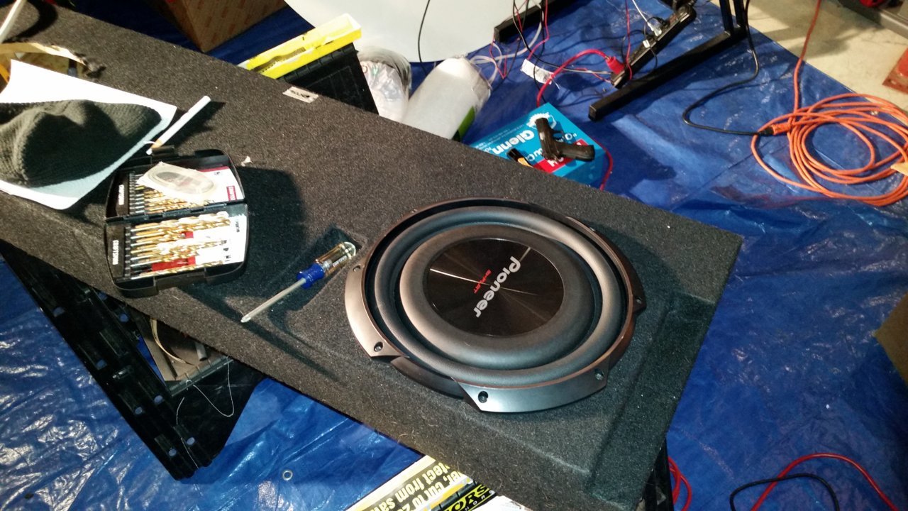

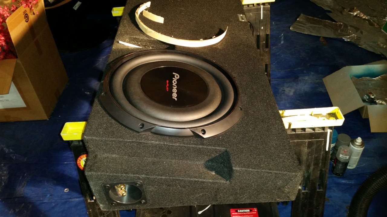

    Front Subs:
    Ok so this past weekend I messed around with front door speaker spacers for the 8" Pioneers. I will still need to completely change these once I have the door panel off and can play with the actual hole that is in the sheet metal to make sure they will fit. But they meet the minimum depth requirements that are theoretically there. So once I can pull the door panels off and make any adjustments necessary, I will build the final set, seal them and then paint them.
