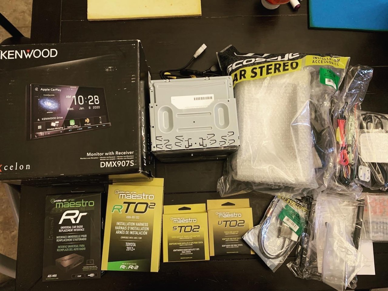

    This all started with a silent auction at a New Year's Day dirtbike harescramble race. There was a Kenwood DMX907s that I snagged for less than half price. I knew the carplay would be nice and one thing led to another and now I've done all of my speakers, added an amp, and will shortly be rounding this build out with 2 ported 10" woofers behind the rear seat.
    To start, I've built about 4 systems in my personal trucks over the years and helped my friends with countless more. With that said, I had no idea how much swapping a head unit has changed in the past 10yrs. I called Tech12v and asked him what I needed to fully integrate this thing and he had everything in stock so I paypal'd him some cash and got all the parts. Super helpful to work with.
    I started this off by taking a Saturday to install the head unit. I programmed the maestro and overall it was pretty smooth. I used all of the outputs from the head unit and wired them into the harness as directed. This is a Metra dash kit and it is decent. I did add some black tape between the headunit and the dash kit surround so no gaps showed. You cannot use the OEM microphone with this head unit (maybe all aftermarket head units?) so I routed a new one. It is mounted in the overhead console and the cord runs along the windshield, tucked into the head liner then to the A-Pilar, then snaked through the dash and dropped under the steering wheel. I then took it back up into the dash right behind the head unit. It wasn't too hard I just wasn't expecting to do that.

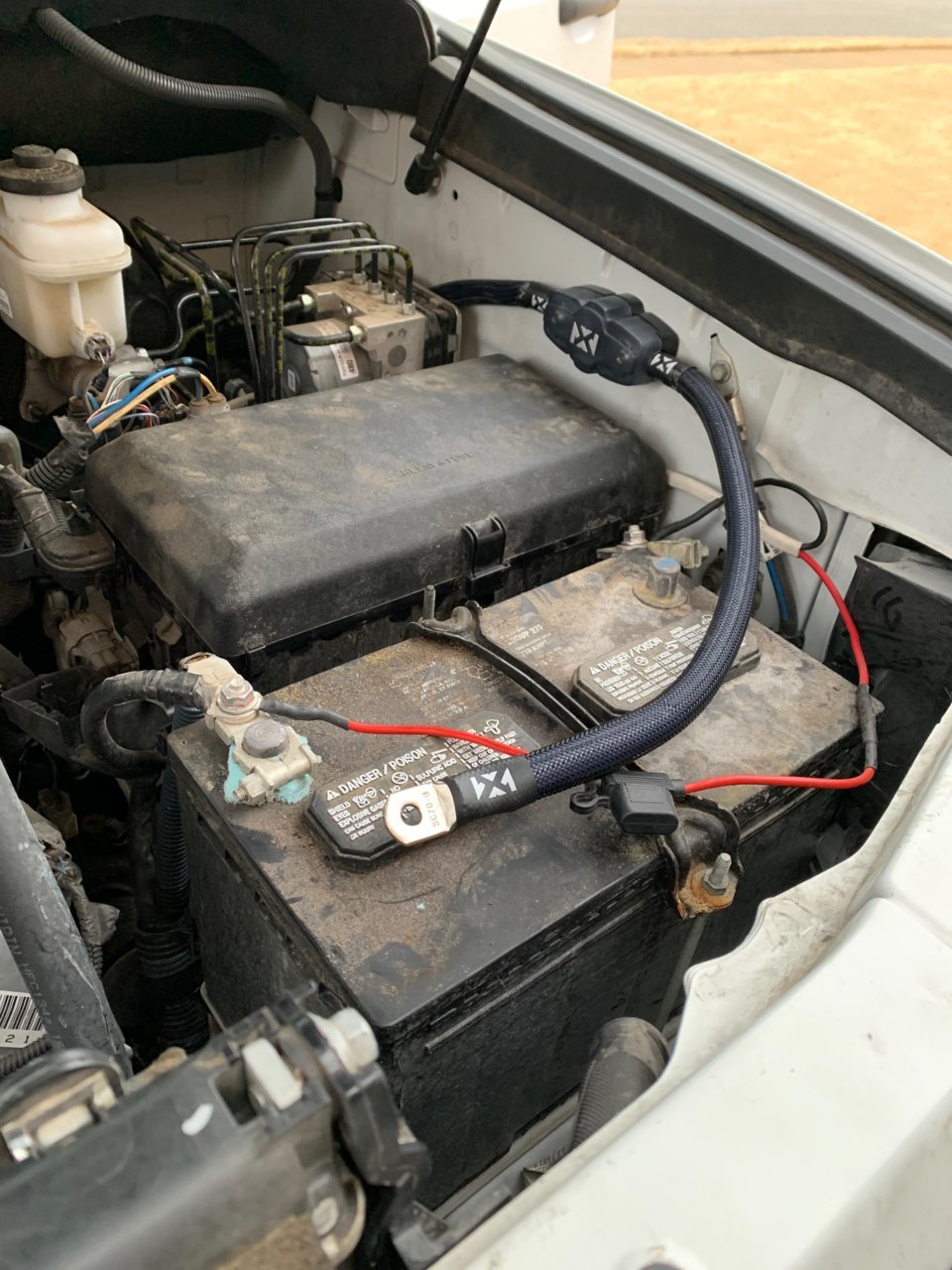

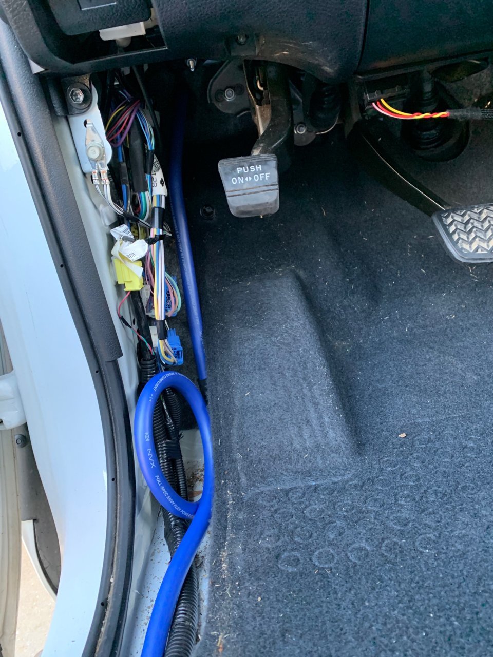

    Next was routing the power wire. Oh boy, I had read so many horror stories on this one. Most people had issues running 4ga wire. I had 1/0 wire which is much bigger. My first step was to dismantle the interior by taking out the seats and the center console because I knew it would all need to come out and it would give me room to work.
    The console is easy, there are 4 bolts in the bottom of it under the carpet. The seats are easy as well. There are four total 14mm bolts for each seat. There are three plugs under each seat as well (possibly more if you have heated seats). The yellow plug is for the airbags. I recommend that you disconnect the battery before you unplug these to avoid throwing an airbag code. I read that if you power on the truck without these plugged in you will get a code that has to be reset by the dealer. Not sure if it's true because at one point I got that message and then it went away.
    Onto the power wire. My plan was to go through the existing grommet in the firewall. You can cut the nipple off of it and then look under your carpet on the firewall and see the hole you just opened up. I took two different sized wood chisels and ran them through the hole from the inside. I sprayed the first couple feet of the power wire with Maxima SC1 (silicone spray) and to my surprise it slid right through as I fed it in from the cab of the truck. I then installed the inline fuse and mounted it in the engine well. I setup the two distribution blocks under the driver's seat where my sub amp will be going. Excuse the dirty engine bay.
    After this I decided to ground with 1/0 to the seatbelt bolt that goes to the frame under the carpet right behind the driver's seat. I used a wire brush to clean the paint off and mounted it. I then ran it back under the carpet to the distribution block. I routed the blue power wire out of footwell area and under the carpet into my power distribution block. From there I ran 4ga wire under the carpet, over the transmisson hump and under the center console.

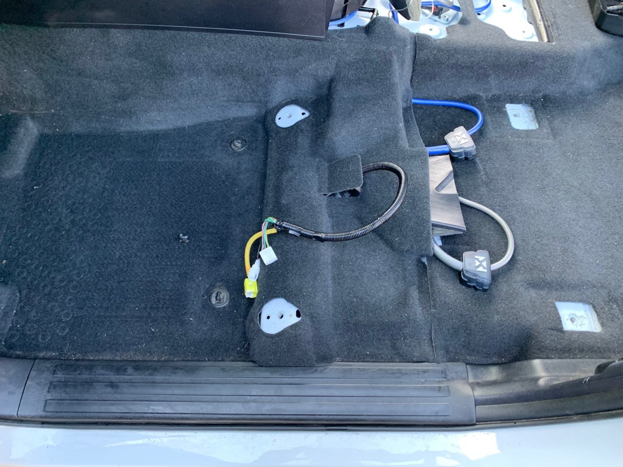

    The RCAs were tucked up under the plastic piece that you see pictured where the cup holders go. The sub RCAs were wrapped, shielded and stuffed under the carpet to exit where the seat wire harness comes out of the carpet. The speaker RCAs were routed over the transmisson hump well away from the power wire to avoid interference and then under the carpet on the passenger seat. The 4ga power and ground wire are also under the carpet and routed away from the RCAs to come out under the passenger seat.
    Here's a shot of the finished drivers side seat area.

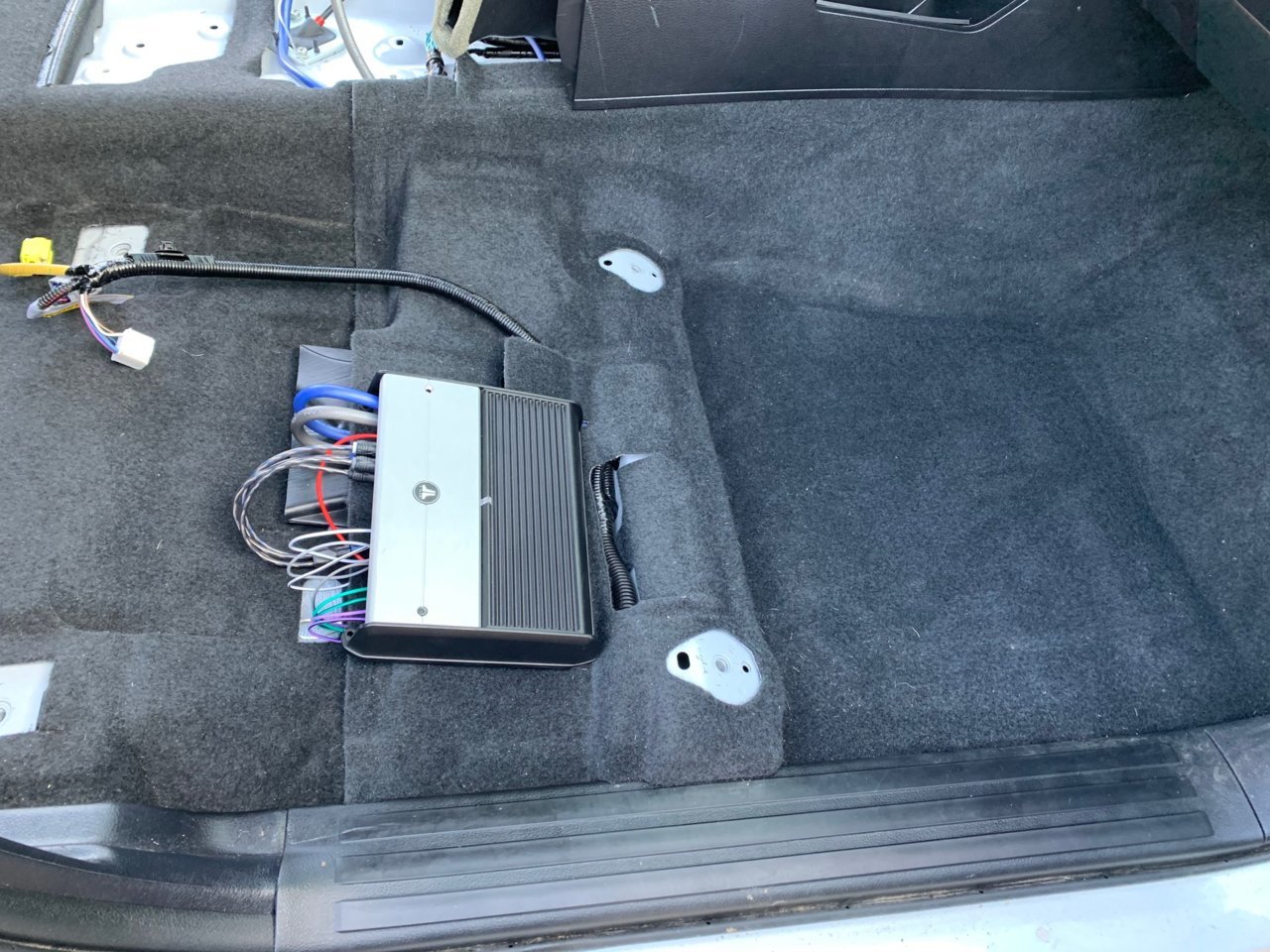

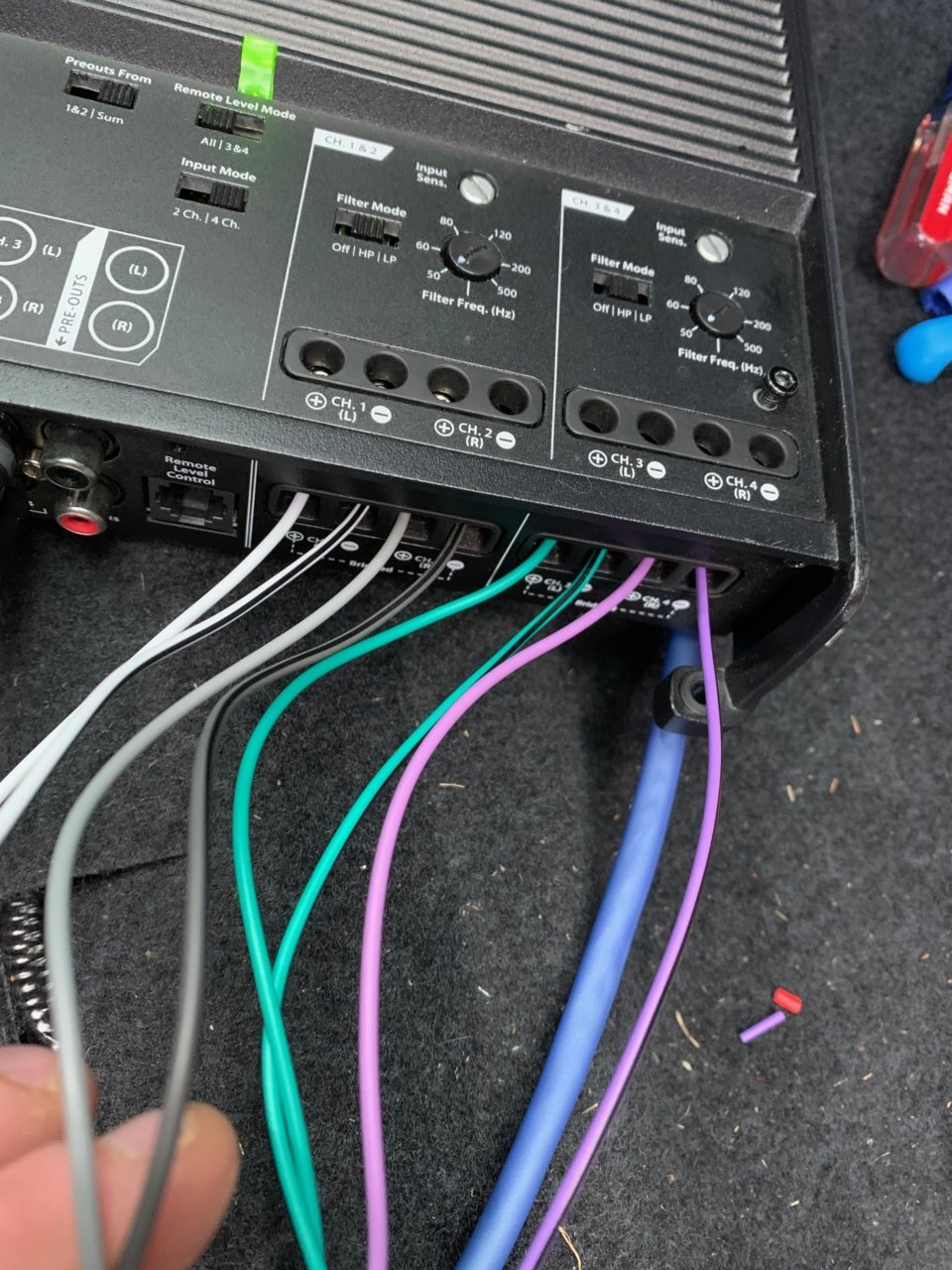

    At this point it was time to start on the amp install. First thing I did was use the harness and figure out which wires I needed and which I didn't. There are both inputs (signal) and output wires from each speaker on this harness. I taped all of the input wires and got them bundled up and then stripped all of the output wires as I didn't want to rewire the truck just to send 75w through it. I did complete a test where I used my own 14ga speaker wire to the speakers and I didn't notice any difference so I continued on my plan to use the stock wires. I didn't have a amp plate to mount the amp to so I used the rigid part of velcro on the bottom of the amp to stick it directly to the carpet. I will build an amp rack for my subwoofer amplifier and at that time I will build one for the passenger side too. But so far so good.
    Wiring in the amp from the Auto Harness House plugs....
    Finished product under the passenger seat.
    At this point I tested it to make sure it worked and I went to bed. This took me much longer than I planned. I was about 6.5hrs deep at this point and my truck was still torn apart.

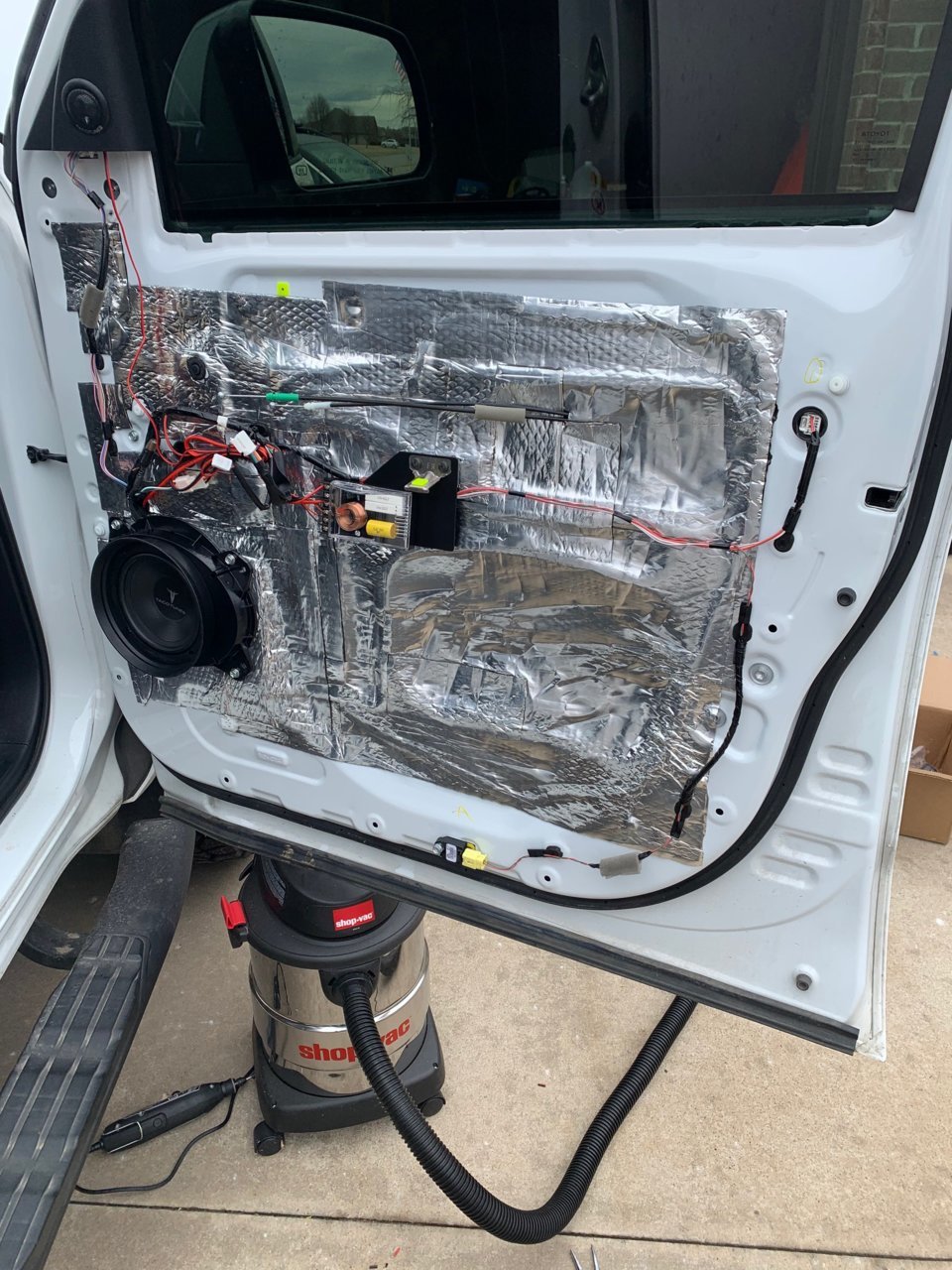

    I didn't take many pictures of this process but I used all but three sheets of the noico sound deadening material on just the two front doors. This took FOREVER to get it completed in the manner I wanted. I ripped the stock plastic vapor barrier out and put as much as I could on the outer door panel. Then I started closing up everything by deadening the inner door panel. The difference is amazing though and I would recommend that product. I don't think there is a better budget sound deadener. It's a SOLID thud on the front door compared to the very tinny and lingering resonance of the rear door that isn't completed yet.
    It probably took me about 1.5hr or more per door to get this completed in the way I wanted to. I was still waiting for my rear speakers at this point so I buttoned up the front and started tuning the amp.
