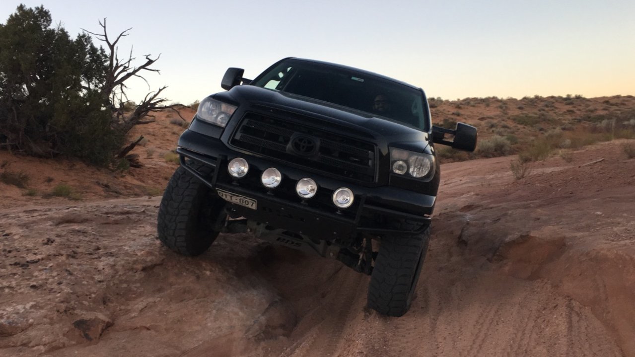

    Driving type: Most of the driving I do is city commuting, paved highway in the mountains, and some dirt roads in the mountains on the weekends. Maybe 10 times per season I get onto some pretty rough dirt/rocky roads headed up to campsites where I engage the 4x4 for a couple miles at a time. Not rock crawling or anything like that and no trailers.
    Question: is it a bad idea to put these 4 tires on the truck? Any suggestions are much appreciated.
    Pic: This is about as rowdy as she gets.
