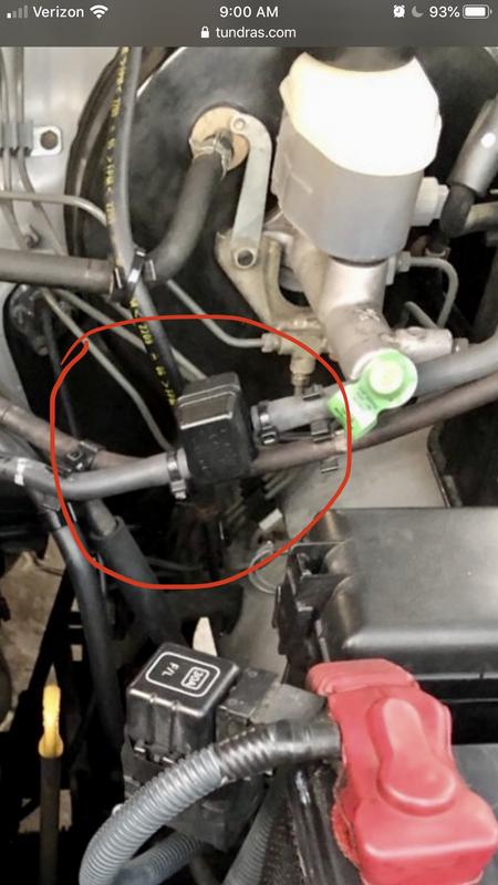

    Yeah. I’ve had a few various lines over the years slip off and the truck basically let me know right away. I would slip them back on and use electrical tape as a back up.
    That area under the hood on the drivers side where 4-5 lines cross over seems to be a culprit. Pays to make sure the OEM clip/stand offs that keeps them organized are still in good shape. Mine were cracked or not holding properly, so zip ties were rigged for extra support.

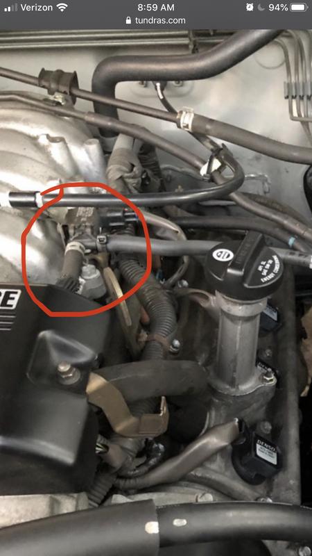

    Thank you for posting those pictures @Professional Hand Model, you are pretty handy.
    I circled what was disconnected on mine, can anyone tell me what they do?
