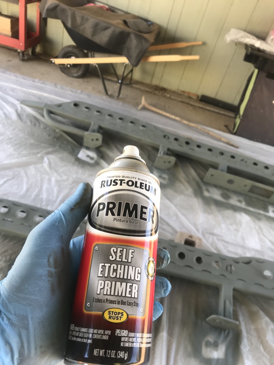

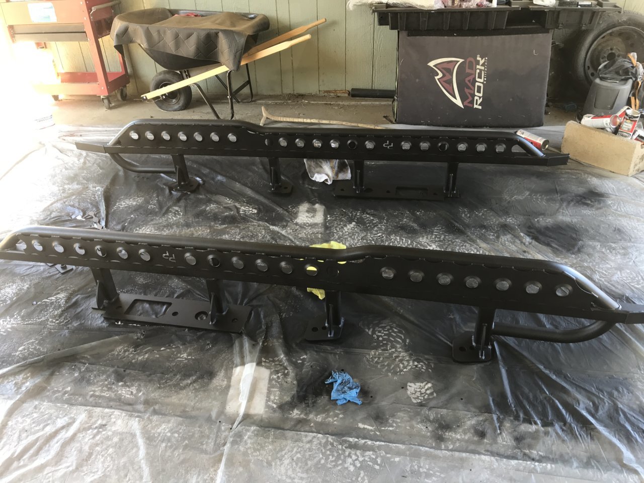

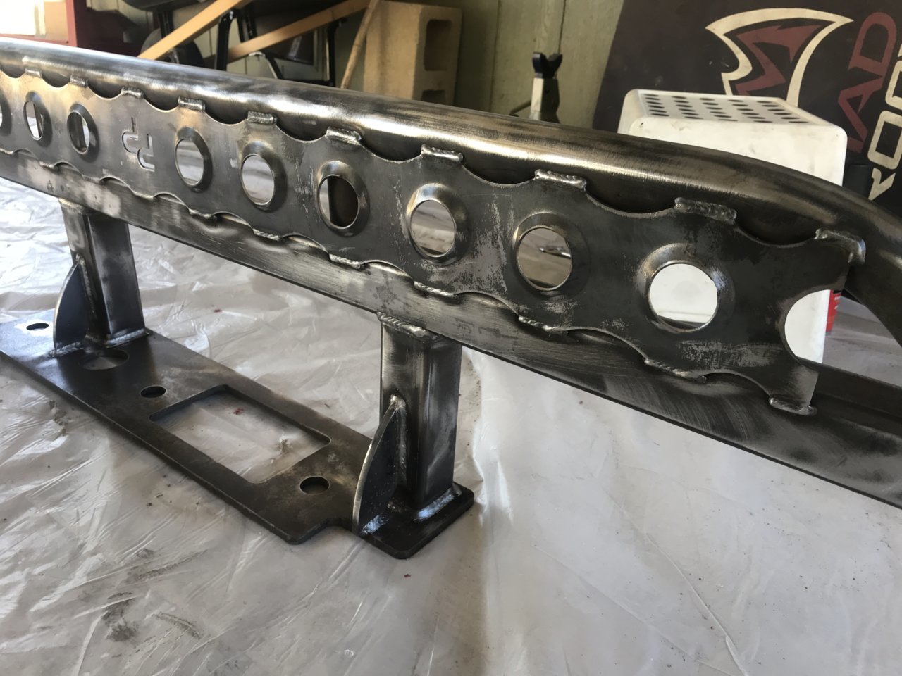

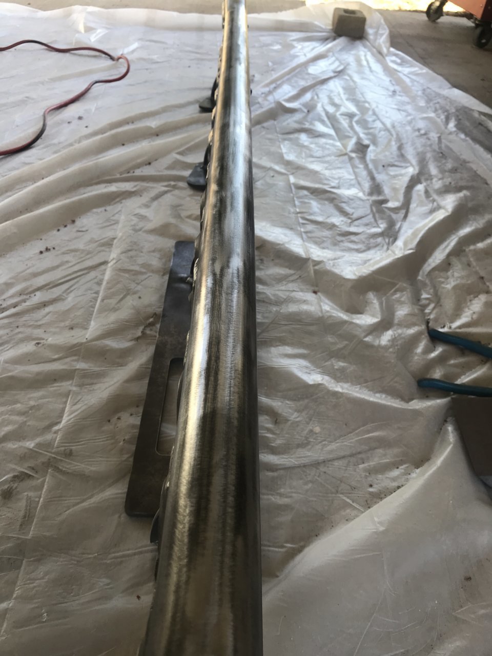

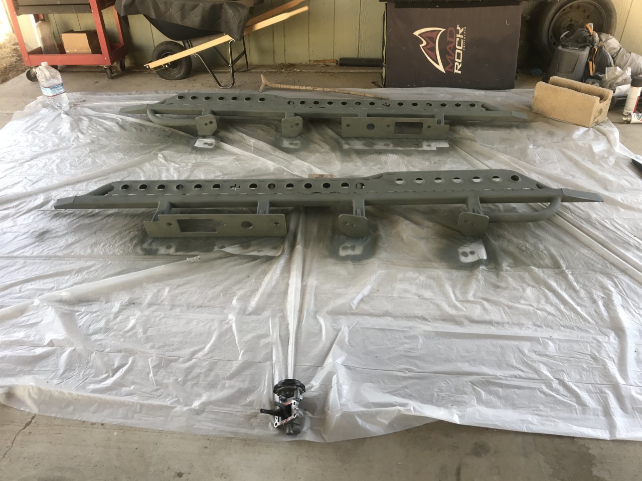

    Hey Y’all! Finally getting around to posting about coating my sliders.

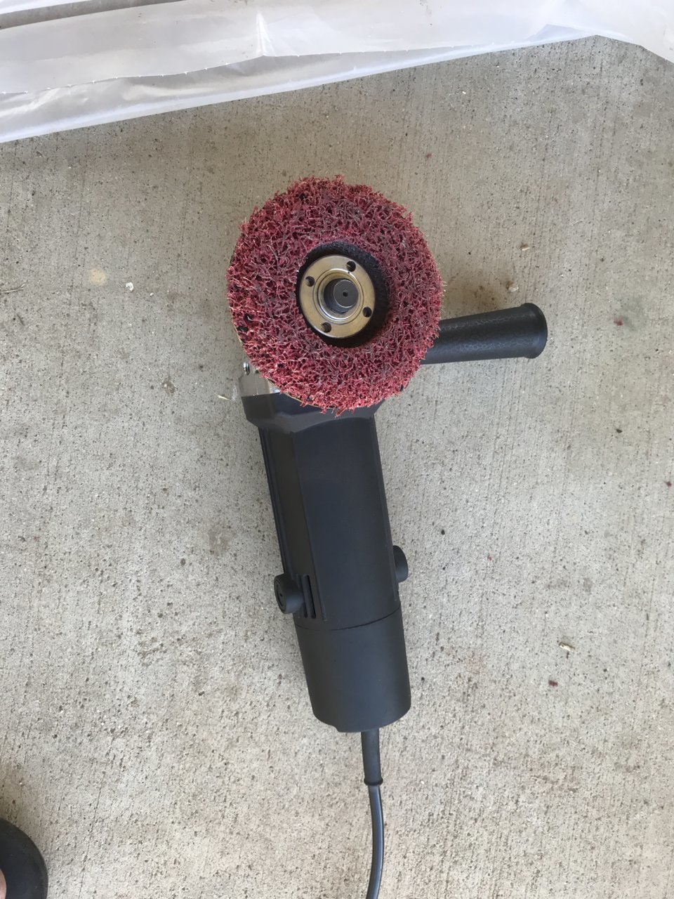

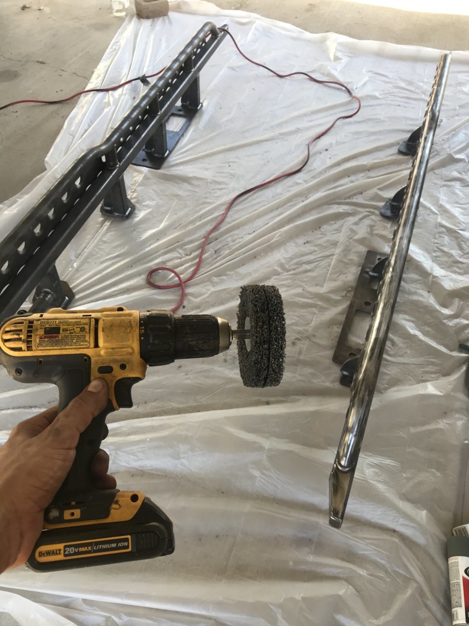

    I bought these cool abrasive wheels from my local dept. store. Made the job go very fast.
    https://www.mscdirect.com/browse/tn...MIgvTyy4W25QIVBR6tBh2NPQ8iEAQYISABEgJZAPD_BwE

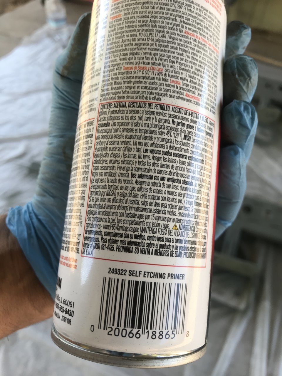

    I used three cans each per slider:
    Rustoleum Grey Self Etching
    https://www.rustoleum.com/product-catalog/consumer-brands/auto/primers/self-etching-primer
    Primer
    Rustoleum Truck Liner
    https://www.walmart.com/ip/Rust-Ole...MIsMHYwYa25QIVkMhkCh3oLgwzEAQYAyABEgJ0BPD_BwE
    I noticed after uploading
    These photos that I don’t have an installed pic but I’ll be home this weekend and post them when I get there.

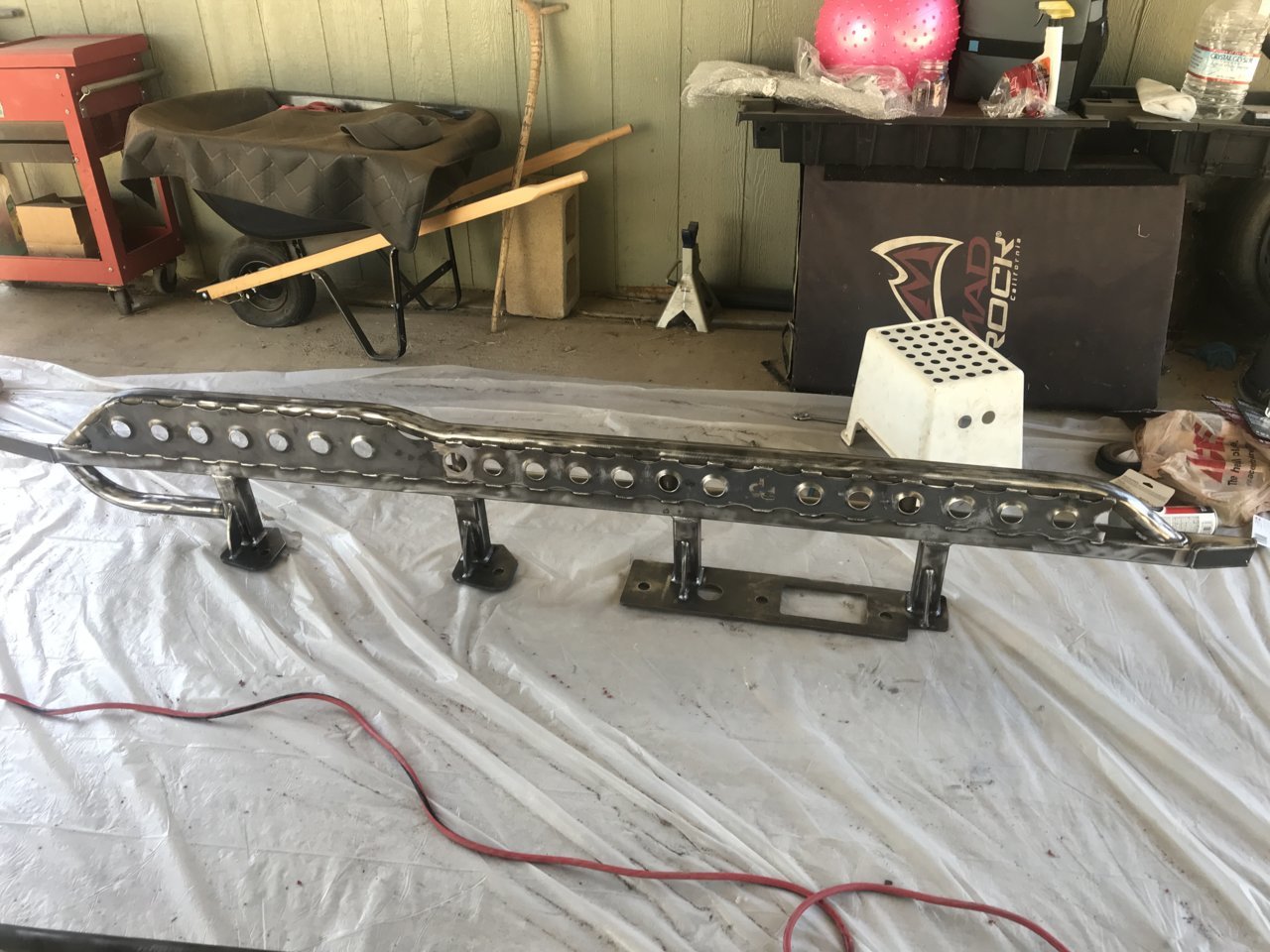

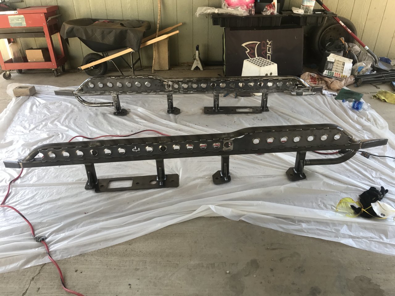

    Sanding the metal was tedious. These things sat on the pallet for a while and had some rust obviously. I sanded all the rust areas and took down any heavy patina that was on the sliders. Wear gloves because that wheel is sharp! I took the guard of for better articulation while sanding around the intricacies of the sliders.

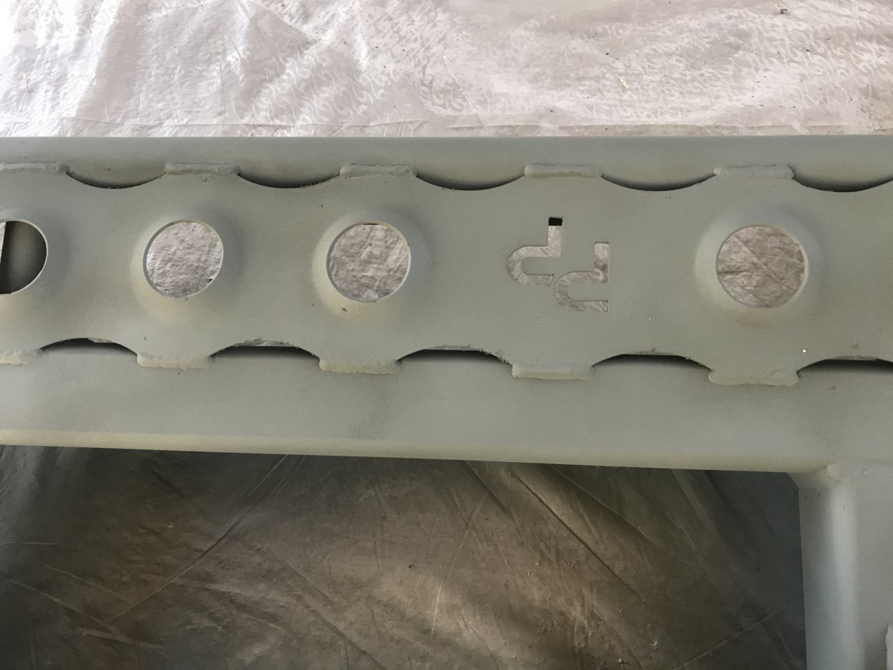

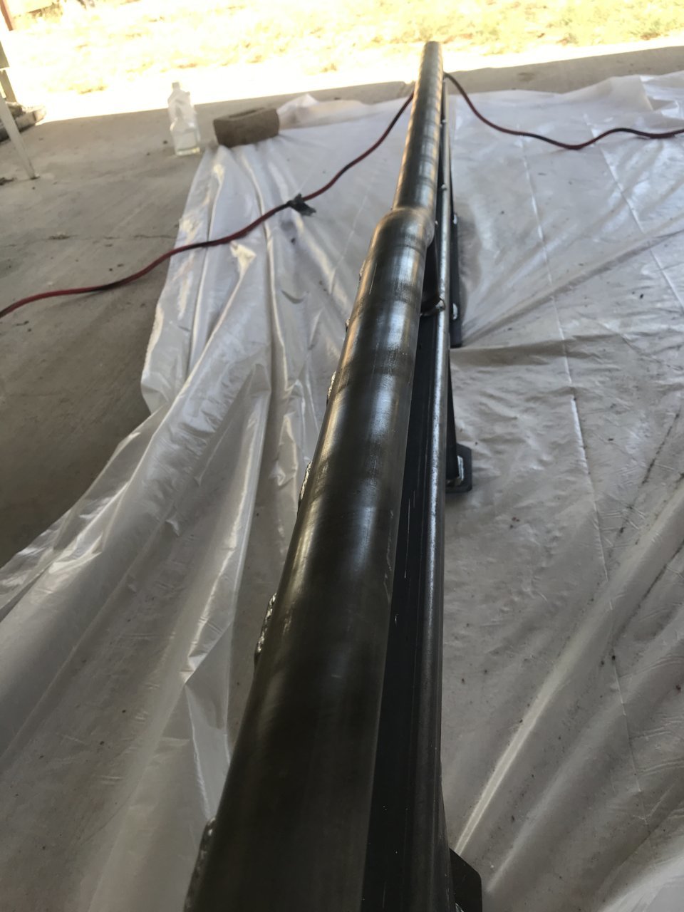

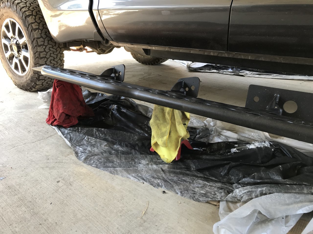

    I then sprayed them
    With primer. Took about three cans a piece to get a nice thick coat that doesn’t show any metal through. A lot is used trying to get all around the sliders since they have hard to reach spaces.

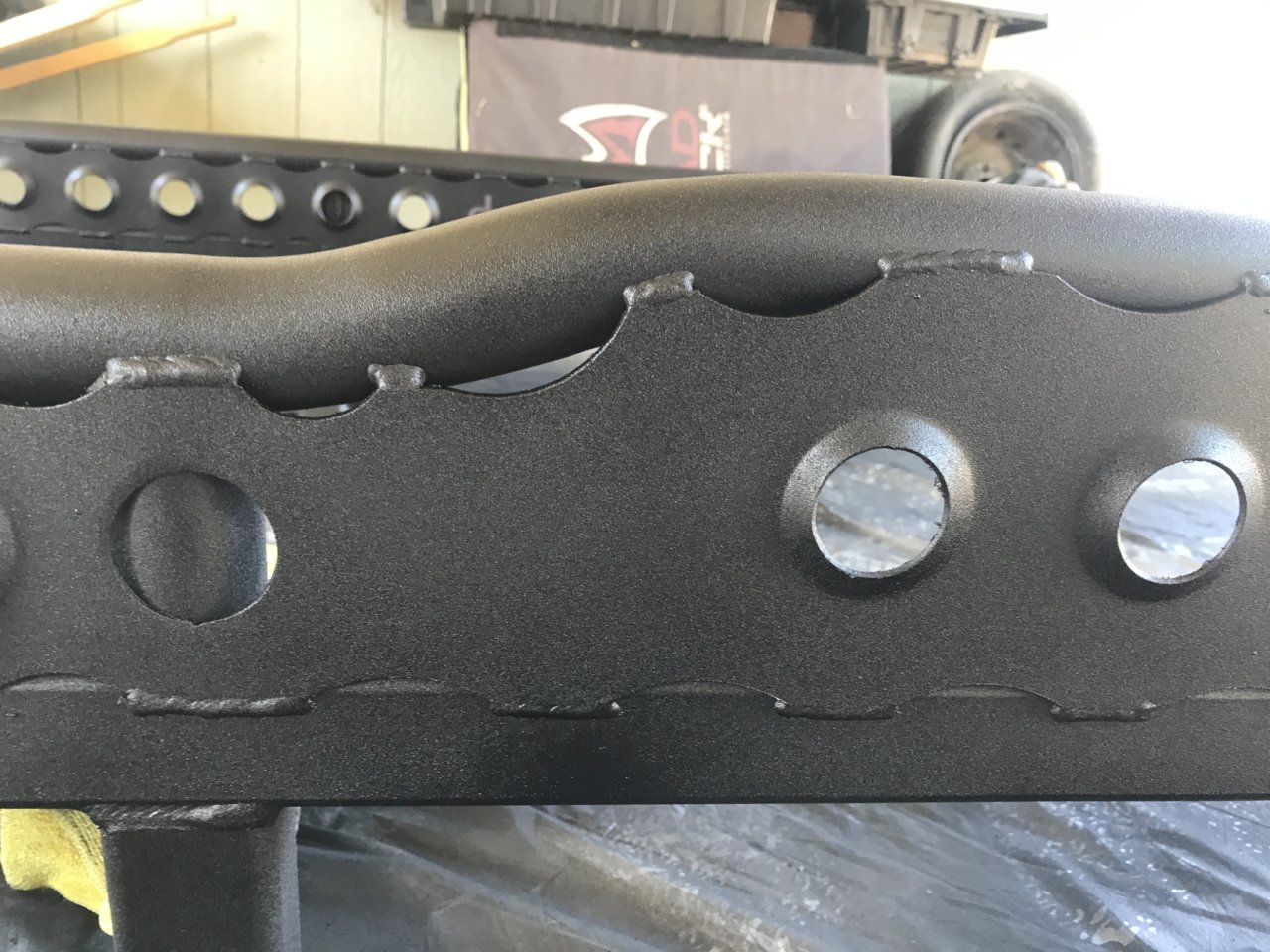

    Lastly I sprayed the sliders with the rattle can rustoleum liner. I love it. It’s not too gritty and it went on very smoothly without lumps or drips. It took about two days before they cured but it’s well worth it. I had them out on some pretty gnarly dirt roads and banged them a couple times and it held up fine with no chipping. Only scratched where it hit the rocks. It’s the perfect texture for grippy-ness but won’t gore you’re leg if it accidentally rubs the sliders.

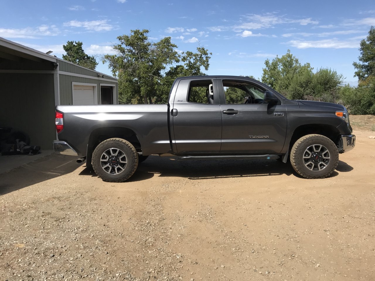

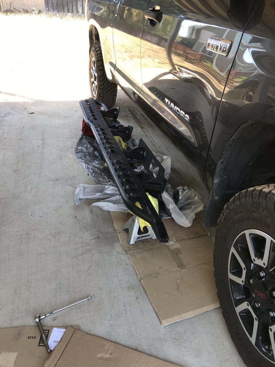

    I used three jack stands to hold the slider during install and I would adjust them up until the slider was in place. Worked very well. I installed them in less then 2 hours. I think I spent around 110 dollars to coat these sliders.
    All in all I’m really happy with the outcome and recommend the rustoleum products.
