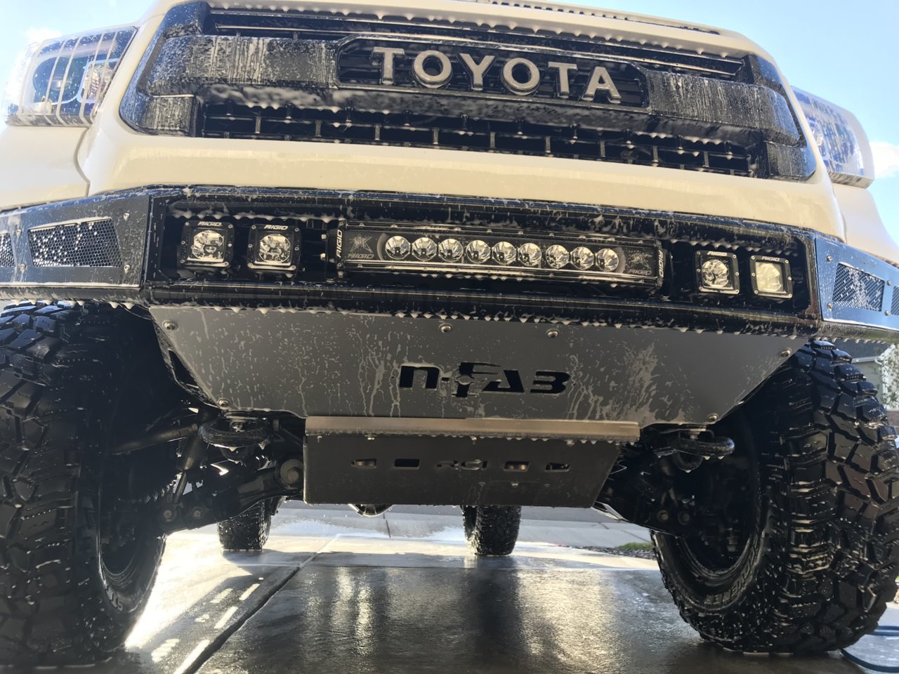

    I got the aluminum ones for less weight but very similar protection

    I went steel, and wish I would’ve went aluminum just for the weight savings.
    That’s badass!
