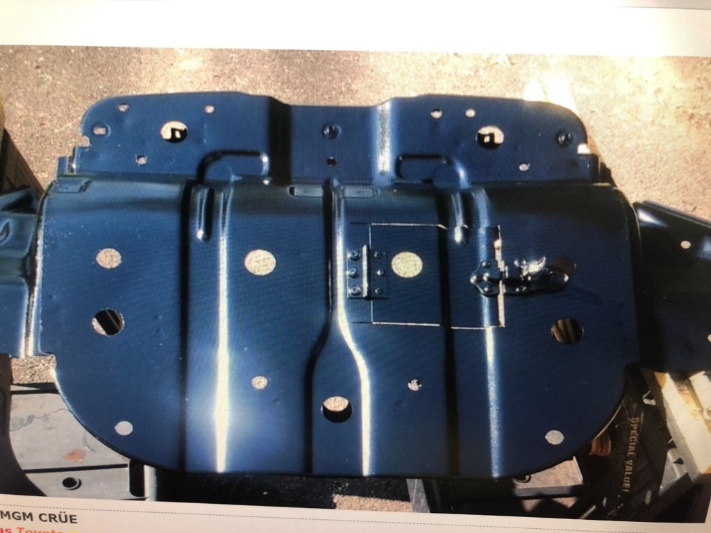

    Angle grinder a door for the oil filter if you don't want to spend money on an aftermarket one.

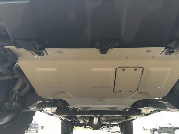

    I modified mine like shown. Cut two slots and only loosen those two bolts (do not remove). Plate is held in place to remove the rest of the bolts. When replacing, slide plate into position and replace the rest of the bolts. Tighten these two last. Works like a charm!

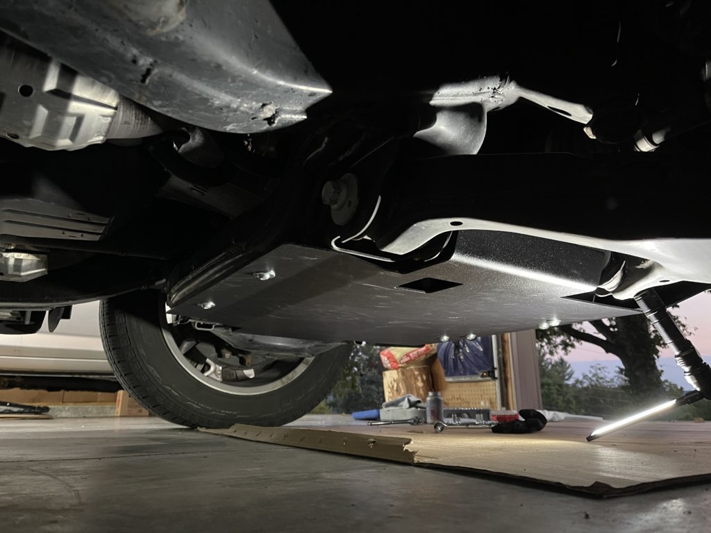

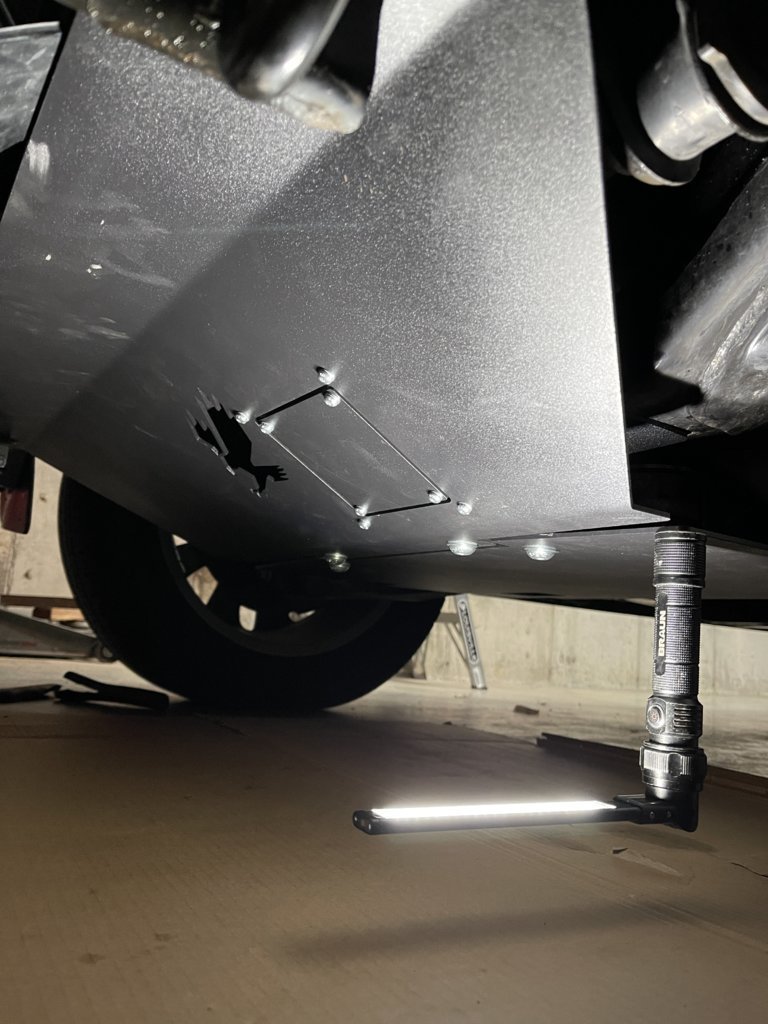

    RCI skid for the win. Before I had it, it wasn't hard to push it up there and zip the bolts on with my M12 ratchet.

    +1 RCI Skid

    This is what I did. For anyone thinking about doing this use SS self tappers on door hinges and latch.

    easier and cheaper just to cut a door and put on hinges and a latch. plenty of ideas out there from simple to extravagant

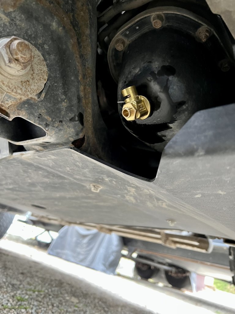

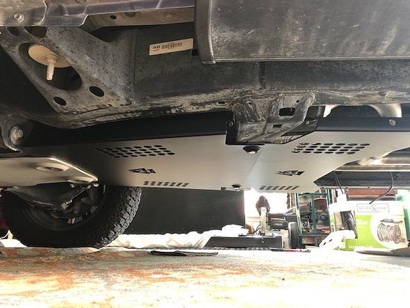

    Installed my RCI plate over the holiday break. Looking forward to my next oil change with that access door. Still on the fence about a Fumoto valve however for even easier oil changes.

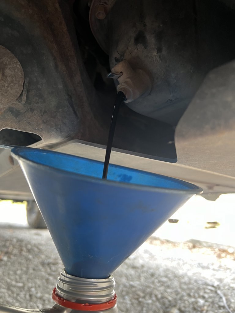

    I also have the Fumoto valve with the RCI skid plate. It may be a little slower. But I’m usually doing something else while it’s draining. It’s up and out of the way too. I thought I had a pic of oil draining, but can’t find it. IMG_4017.jpg

    Best thing I ever did on this truck….

  21. Jan 15, 2025 at 7:56 AM
    Jhon
    Jhon New Member
    Aug 15, 2021
    #66794
    219
    On the Oregon Trail
    2021 SR5 TRD OR
    Just not having to deal with the initial surge of oil getting all over the passenger tire was enough of a push for me. I wasn't going to do it in this truck because the oil gets changed only once or twice a year, but after two messes I ended up doing it. Stick a piece of tube on it and drain it into jugs, no more pouring oil out of pans.

    SAME HERE! My fumoto valve has been installed for the last 7 years or so, without issue. I put them on all my vehicles now. My tundra has CBI skids, my sequoia has RCI. I like the CBI skids better and feel like they have better coverage, but they only come in steel and are HEAVY. But the aluminum RCI skids are sufficient.

    Installed the Fumoto valve on first oil change. Only issue is if you drain into a 5 qt jug you have to switch jugs at some point. I just hang out under truck and work on pulling the filter.

    This is the biggest pro for me. As a DIY, today it goes into my catch pan, and then I put it back into the 5qt/gallon jugs. That process sucks. Going straight to the jugs would be awesome. My hangup I suppose is that what if the Fumoto doesn't close/seal all the way? What if it leaks? It's probably my ignorance likely having never used them in all of these years of DIY on my vehicles but those are my concerns. That said, I also have full RCI skid plates, so the likelihood of it getting bumped off road is probably diminished as well. Perhaps next oil change.

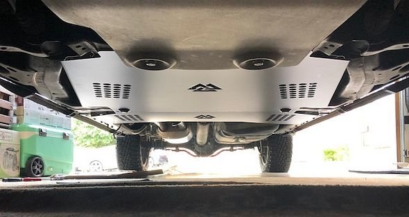

    I have the Talon Garage skid plate.. heavy but worth it . Also using Fumoto valve..
