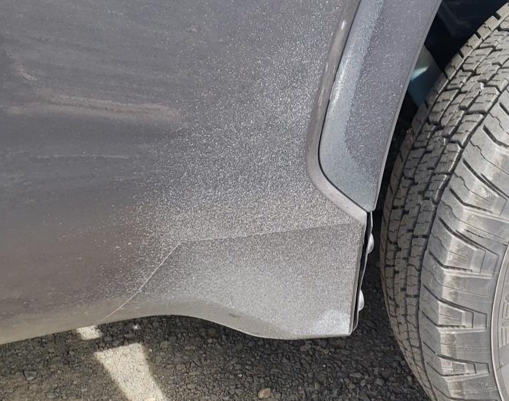

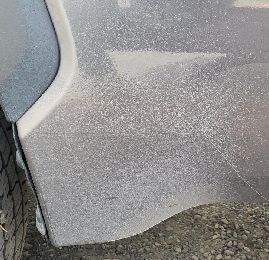

    Not to hijack my own thread but has anyone had trouble with the paint on the truck? I put 10K on my truck to Arizona and back and when I came home (oregon) the paint from the front tire to the rear tailgate entry step was chipped up. Badley! $7000+ worth of damage. Luckily insurance covered the cost. Toyota would not warranty it. Said it was caused by an outside influence...they were right...I drove it down the highway...apparently these trucks are not meant to be driven. This vehicle has never been off-roaded. I'm almost 70 and have owned Dodge, GMC, Ford and several Toyotas...never seen the likes of this....

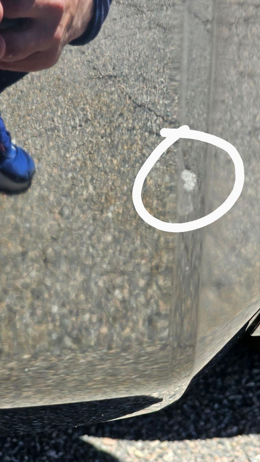

    Not really. I do have a minor chip on a piece under the front driver's side headlight but nothing like you are describing. How hard did you fight Toyota because the way you describe it it is not your fault and a factory defect that Toyota should fix. I'll take a pic and upload it but I would love to see the damage you are describing.

    Here's a pic

    These are just a couple of a dozen or so shots. Both sides of the truck were like this...I went thru three levels of Toyota reps...headed to arbitration on June 12th.

    Oh no. Stay on it and fight. Doesn't look like "road damage" to me. Good luck and keep me posted!
