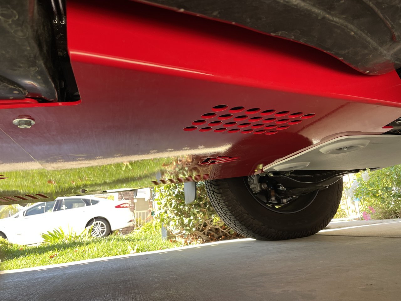

  11. Apr 6, 2022 at 3:04 PM
    TL TRDPro LR
    TL TRDPro LR New Member
    Aug 23, 2021
    #67171
    390
    Troy
    SoCal/Idaho
    2021 TRD Pro Lunar Rock CM
