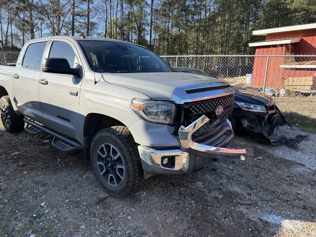

    I bought a used 2018 Tundra in 2022. It already had a lift and shocks on them (Fox 2.0 shocks) but I don’t k Lw how big the lift is. Is anyone able to take a good guess on the size? I’m assuming roughly 2.5~3”.
    Tires and wheels were 275 70r18 if that helps.

    Could you take a pic from further away so we can get a good idea of lift size?

    That’s the issue, the truck was totaled, and I’m trying to replicate size on my new 3rd gen. I’ll see if I can find any more images.

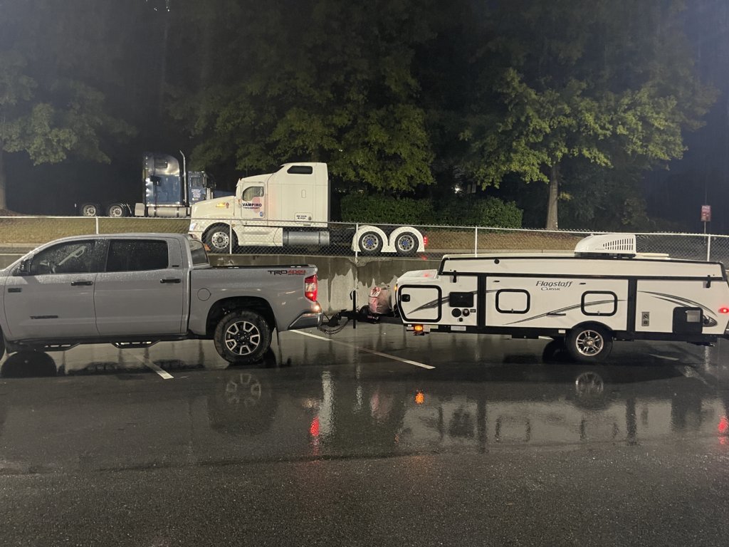

    Here’s another. Sorry they aren’t great. Tires and wheels were 275 70r18 if that helps.

    Sorry man I was just breaking your stones a little. That first pic was nearly useless.
    Sorry about the totalling. Geometry is totally different between 2nd and 3rd gen’s. Wheel offsets and everything come into play.
    I have Fox 2.0 on my 2019 and the fronts max out at 2” lift. Rears (if also Fox 2.0) are 0-1.5” lift depending on if you have aftermarket shackles or blocks. Judging by the first pic I’d say the rear had a maximum of 1” lift.
