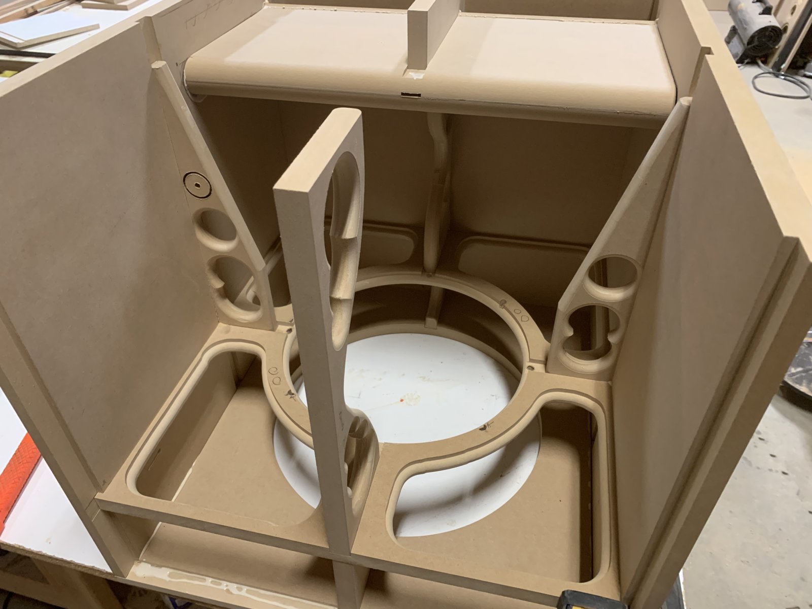

    So… 99% of the time I am a fan of vented boxes. I’ve built piles of them for home and car audio, measured even larger piles of drivers’ TS parameters, and modeled a bazillion drivers in WinISD, SoundEasy, etc. Usually, a modern driver wants a vented box.
    However, neither my car nor my home theater utilize vented subwoofer enclosures currently. Weird, I know. Vented boxes are more efficient and get you an additional octave of extension as the resonance of the vent is what’s producing bass below the drivers natural rolloff. Above that vented frequency, the sub behaves as if it’s in a sealed box.
    They also come with some inherent issues like the vent itself creating it’s own unwanted resonance elsewhere in the audio spectrum, and phasing issues. The former became a problem with my home theater sub which is tuned to an f3 of 17 hz; the vent length and size required was producing a resonant peak at 110 hz even though the amp filter was set at 80 hz. That clashed with a room resonance at the same frequency and overpowered the listener at the frequency, causing the low bass to actually seem quieter. I fixed it by rebuilding the enclosures to a sealed box and tuning them passive radiators (most of which don’t actually provide useable TS parameters). The box enclosure volume dropped in half and the overall enclosure size decreased by almost a third due to the large vent. And I was able to keep the same f3 tuning of 17 hz without the resonant peak OR phase issues. My DSP changed dramatically and I was able to cut the power in half to get the same output. My Crown XLS laughs at me now. And the subs laugh at the Crown…
    My truck, on the other hand, was having the other issue - due to the extremely small cabin space, the vented enclosure was causing such bad phase delay issues that the lower bass was extremely inconsistent and seemed almost non existent at some frequencies. I tuned a pioneer shallow mount 12” to 25 hz in a ~1.2 cu ft enclosure. I fought it for months; the upper bass was too powerful and almost droned. I had to turn the low pass to 63hz or even 50 hz to get it to flatten out. I was baffled.
    A vented enclosure has extra meat below the driver’s sealed in box tuning frequency (most drivers in a car sized enclosure are going to be around 50-60 hz) so an octave below that is 30 hz. Perfect. Plus, you get cabin gain, which is basically a free bass boost below a certain frequency depending on the size of the cabin. In a truck, it’s usually around 80hz. So the bass should get louder as it gets lower. More perfect. But my truck system sucked.
    A neighbor kid asked me to help them build box and install a sub in their RAV4, so I obliged. They wanted something slim in the recessed floor space. Originally, we were going to go with a vented 8 but I had another pioneer shallow 12 on the shelf that at one time I was planning on adding to my truck but ran out of space, so I decided that would be the ticket. For simplicity sake, I went with a sealed box I spec’d from my own WinISD models (not too far off of factory spec) with some good bracing. That thing THUMPED!! I was blown away!
    That night, I went back to my shop and sealed up the very same box I was using vented (that modeled with an extra 2-3 db of bass from 25 to 50 hz than the sealed box). And guess what - it THUMPED! It was awesome! The vented box was shifting phase so much that I was getting destructive interference between the subs and mains.
    A short while later, I finally swapped in a mono amp to power it rather than using two channels of my 4 channel amp to power it and found that the Pioneer didn’t like th extra wattage. So I went rummaging through my pile of subs to see what would fit under the seat.
    After three subs, two wasted prototype boxes, and a pile of sawdust, I defeatedly pulled out the old beater sealed box that previously housed my Pioneer flat 12 and reworked the opening to fit an NVX SMW12. I didn’t have high hopes for the lowly NVX after trying to shoehorn the likes of Kenwood and he at hitter Subdown Audio into the truck, but I plodded on nonetheless. I wired the single sub to 2 ohms, pushing an extra couple hundred watts from my class d mono amp, thinking if I accidentally blew that sub, it wouldn’t be the end of the world. I just needed some decent tunes. I wired it up a and fired it up and…
    WHOAH. That’s an NVX sub? A FLAT nvx sub?? It sounds great with better musicality than any of the other flat subs I had tried (as a side note, I generally don’t like flat subs except as a last resort, as I’ve found very few that sound musical instead of sounding like a farting tuba in the deep end of the pool). This thing was totally different. And in a simple sealed box, nonetheless. I’ve also cranked it up pretty loud and it hits hard and deep.
    So what wa star pint of all that blathering? For $100 and a little bit of time (if you can build a simple sealed enclosure) try adding some displacement via a larger driver. Usually I recommend the opposite, as a large driver in a small box generally sounds worse than a small driver in a correctly sized box. But in this case, then numbers worked in my favor. And it was simple - almost shamefully simple - as here is what my better home theater boxes look like inside…
