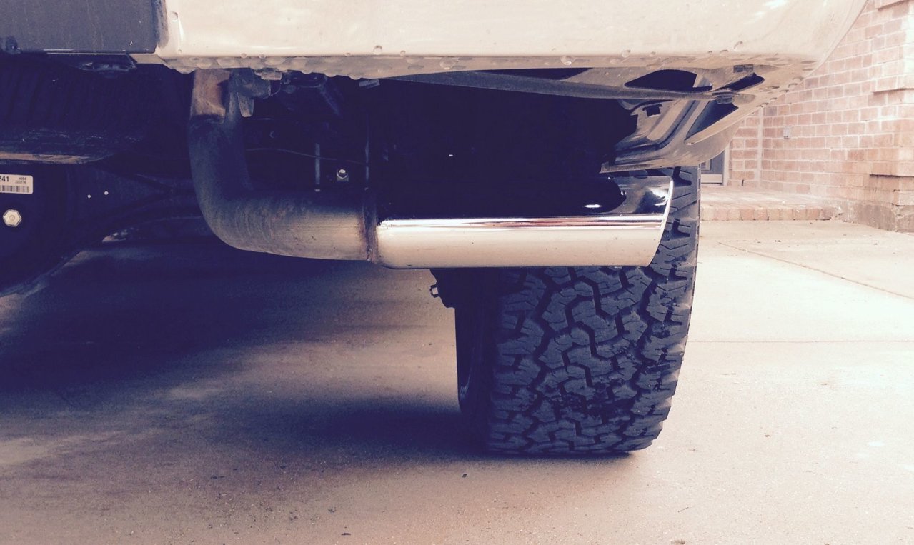

    Honestly, I like the look of a single exhaust with a welded-on tip over duals.
    I've been told my BAM with his resonator sounds better than TRD duals....
    Kieth @dirtydeeds can help you with that as well..
    C7334842-8005-4A77-9154-9B3A5F2530D1_zps_004531b837aa38cb76d9dba542f7511c04f02d5d.jpg
    A67333D4-F68D-451F-8E7F-53CE8DD09AFB_zps_e3f50a0f38d36c6b578dadce53048caba8f9fd5a.jpg

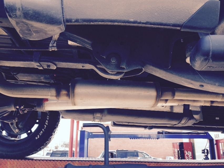

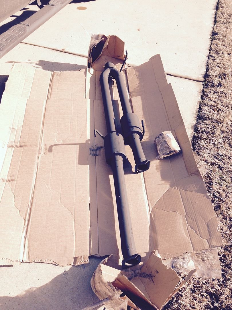

    You can always go to a local shop and have them do a hack job with a Magnaflow or Flowmaster.
    But be prepared for the drone from hell.
    I had that with the 2 in 1 out Magnaflow I first had instilled before I found Dirty Deeds..
    11992450-7BDC-4891-9197-F52F1BF10C3A_zps_f3d9ac4213031cf1b1cf43b48893bdbfb889ea9e.jpg
