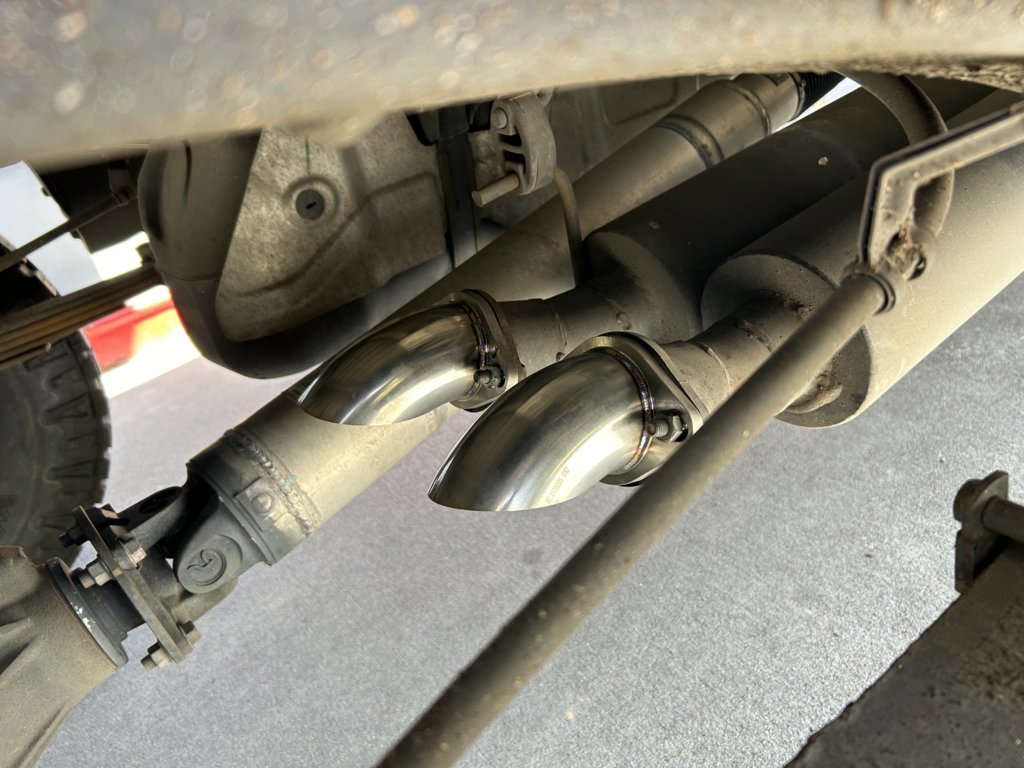

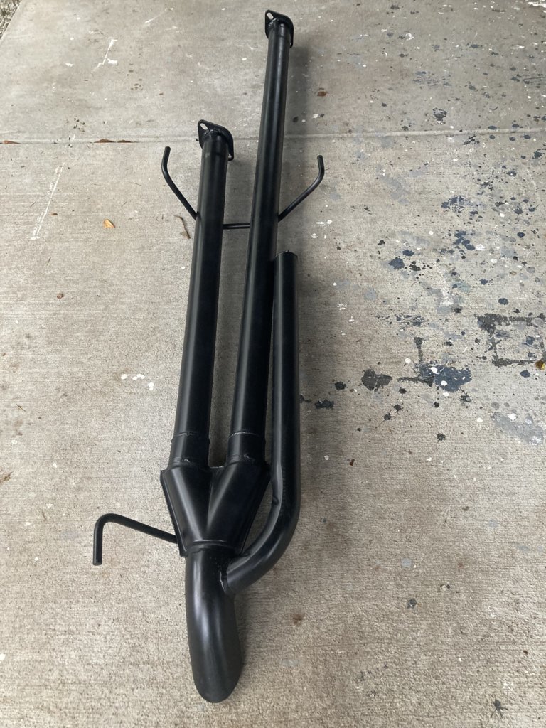

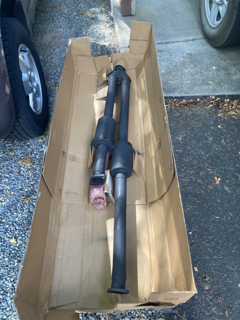

    If you want to hear more in the cab you just order a smaller DD muffler size vs needing a dual exhaust setup. A dumped exhaust will be much louder as well. Duals do require alot more piping (weight and space) and restrict the spare tire size. The exhaust is unlikely to be (noticeably) more restricted in a dual exit setup. I have had DD 8” on a 5.7 and 4.6 with single exit and the Toyota reps thought it was a TRD exhaust by sound. DD Dumped no muffler was too loud for me. If you want the true beast setup you need the DD custom dual 3” (26” twin mufflers) and headers haha:
    8” DD for single exit/stock setup I had for two Tundras:
    Mad max volume level no muffler dump DD exhaust I had:
