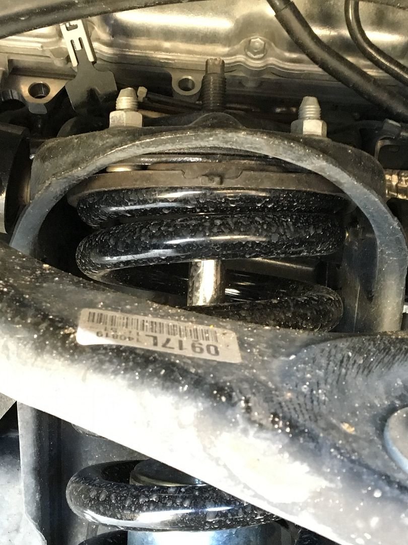

    That 1/4" shim results in 1/2" of lift...
    12E57596-8F7D-4C02-84F3-B12D1190EFC9_zps_908d72ae96f1f7cb8ed6e47b2c63d3056b5f090a.jpg
    Ely010606 and Booney[OP] like this.
