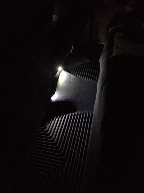

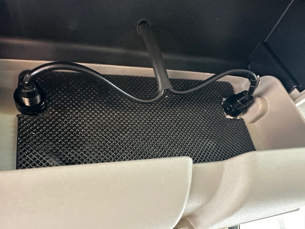

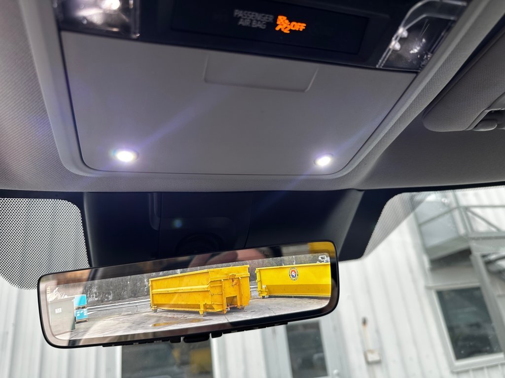

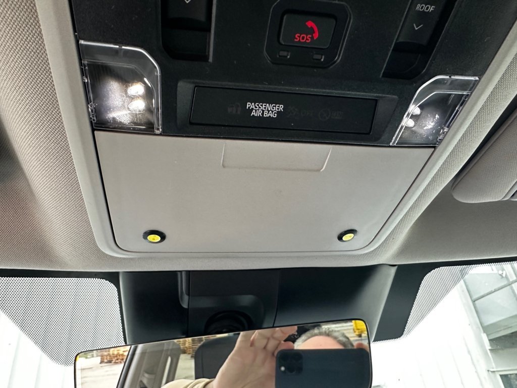

    I was getting tired of using my phone or a head lamp to see anything inside my console, so I added these simple LED lights to the sunglass holder. It works great and I am still able to keep shades in there. Got the LEDs on Amazon and picked up an AOB switch. The LEDs are .4 amps each so it was simple to tap the existing wires on the dummy switch. Under $50

    I looked hard at putting them in that spot on the overhead console, but it seemed like a real challenge getting it to come apart. The glasses holder was easy (and easily replaced if I messed it up).
