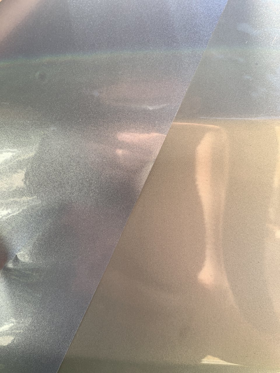

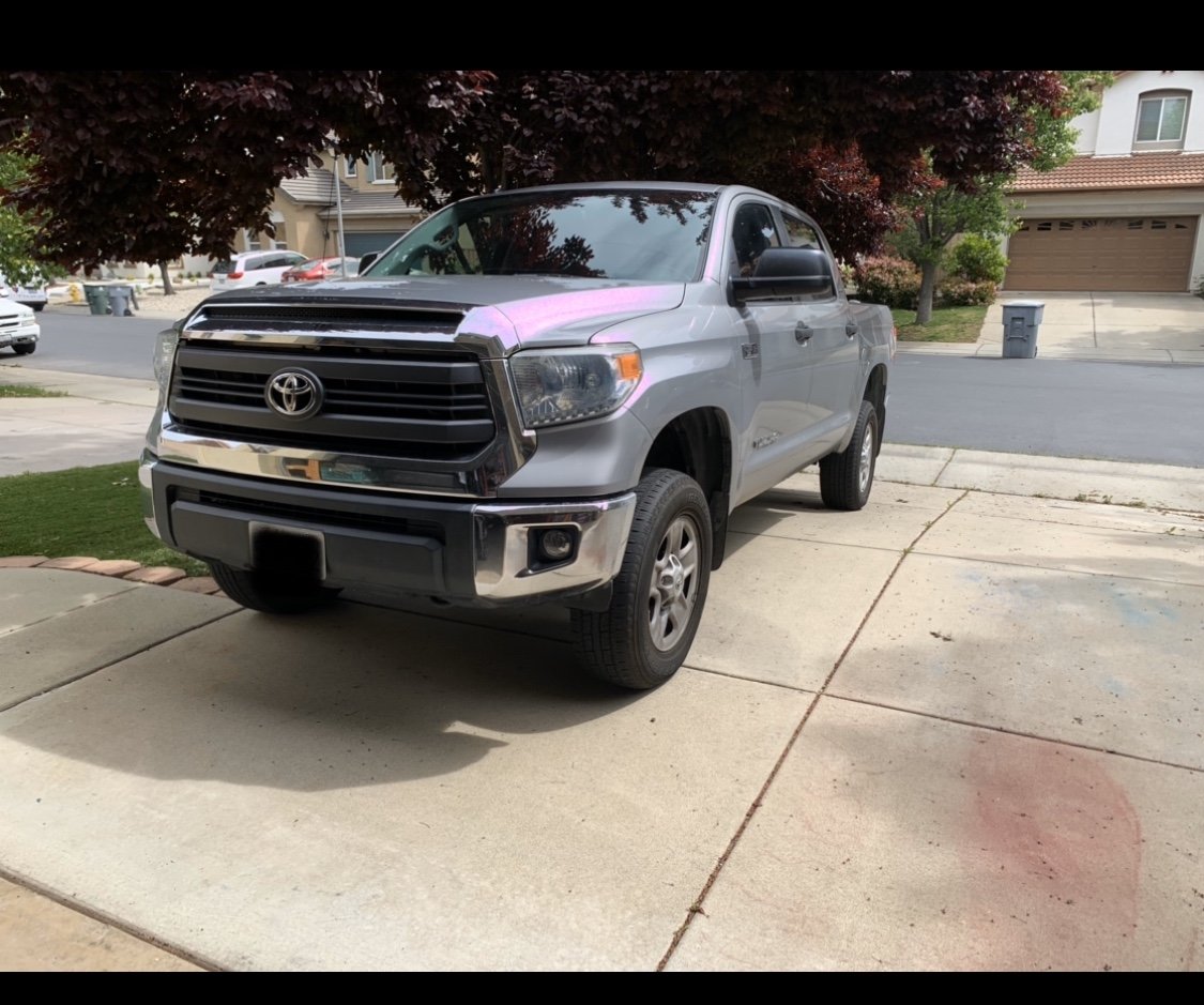

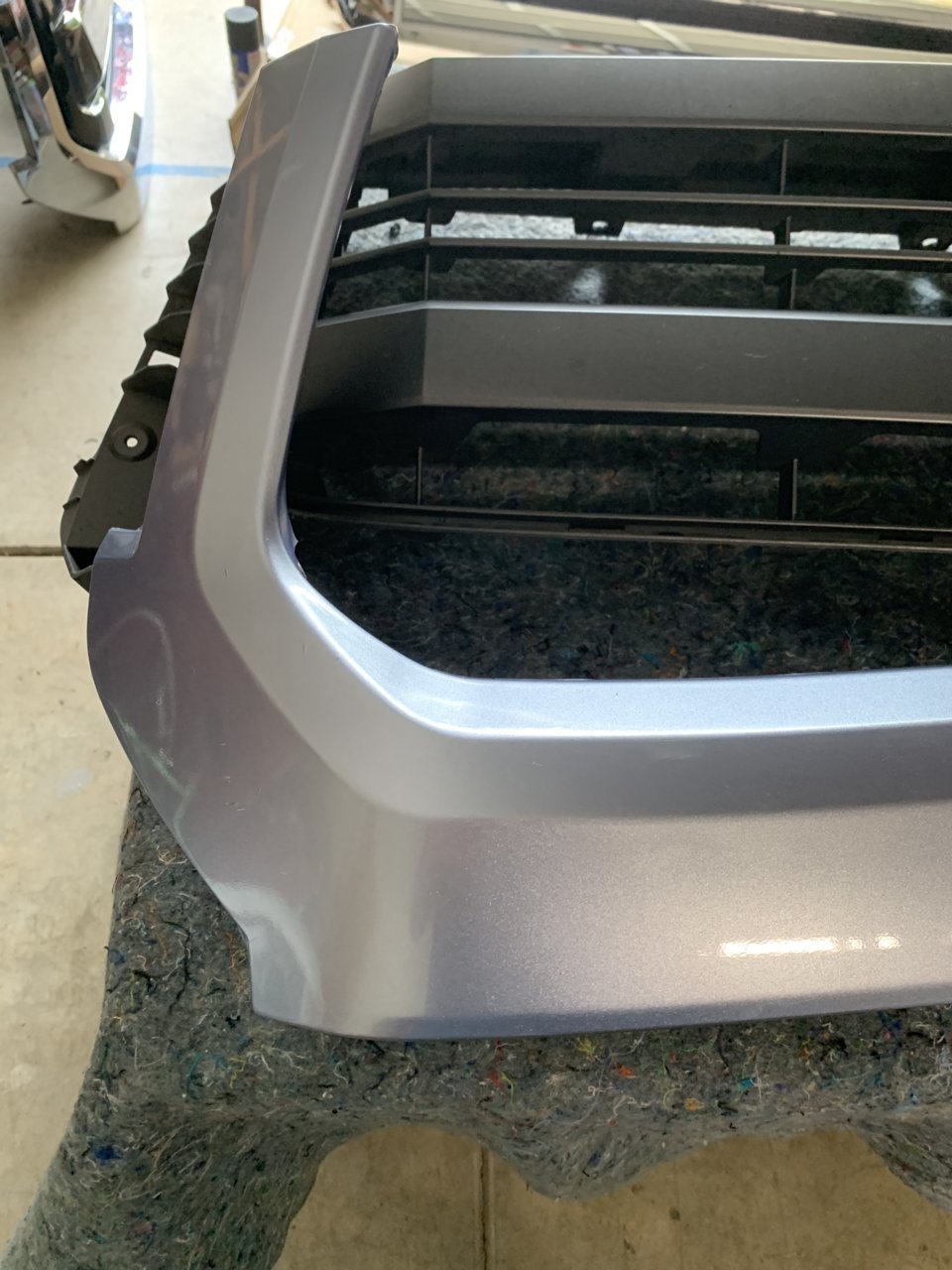

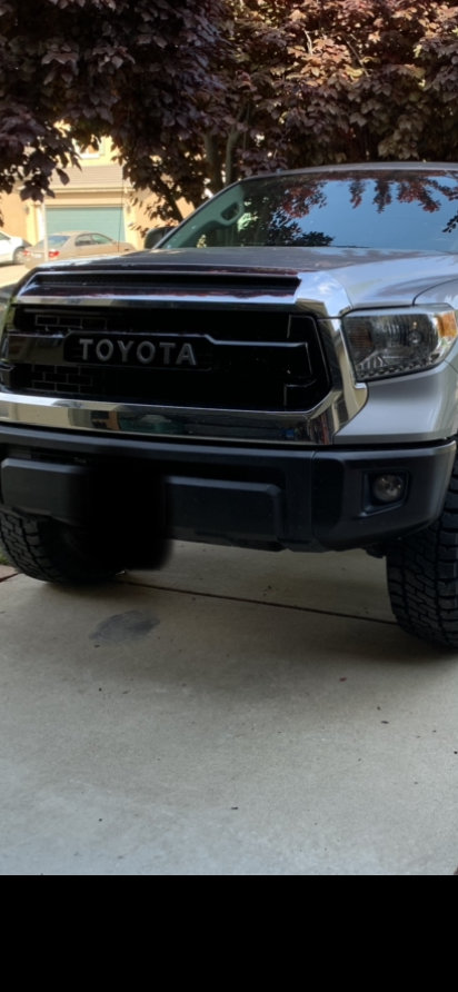

    First I had to get rid of the grille. I had originally bought the pro grille and what I thought was a color matched wrap. I wrapped the grill surround and hood bulge, put it back on the truck, and showed the wife. I thought it looked good but my colorblindness got the best of me. Everyone said the wrap was blue/purple/silver and didn’t match at all. So I took off the wrap and left the chrome on the pro grille for now.

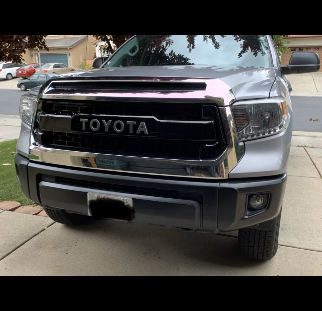

    Still trying to figure out how to post multiple pictures. But this is the grille wrapped and the the wrap on the truck.

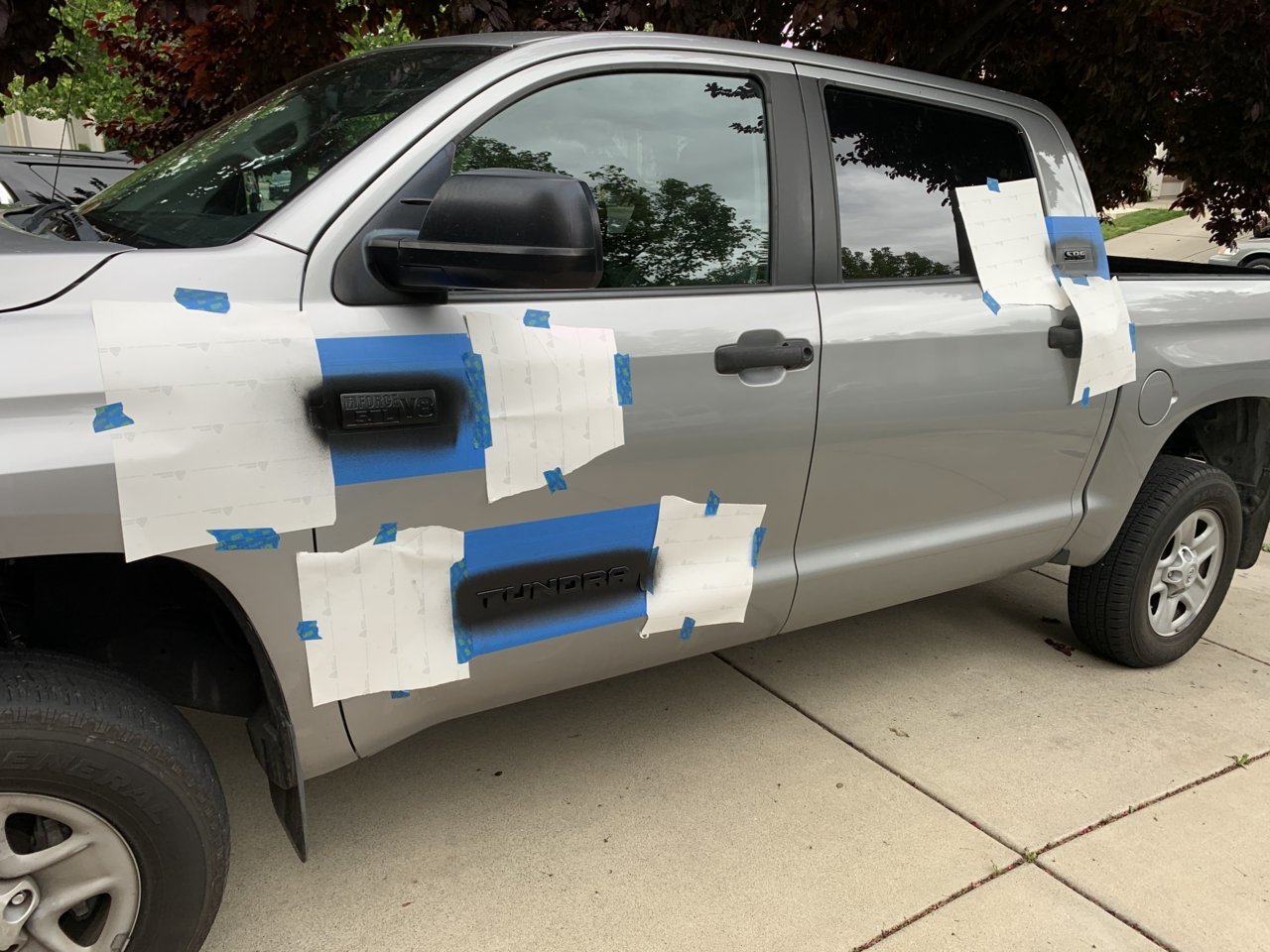

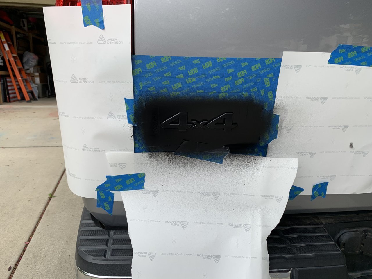

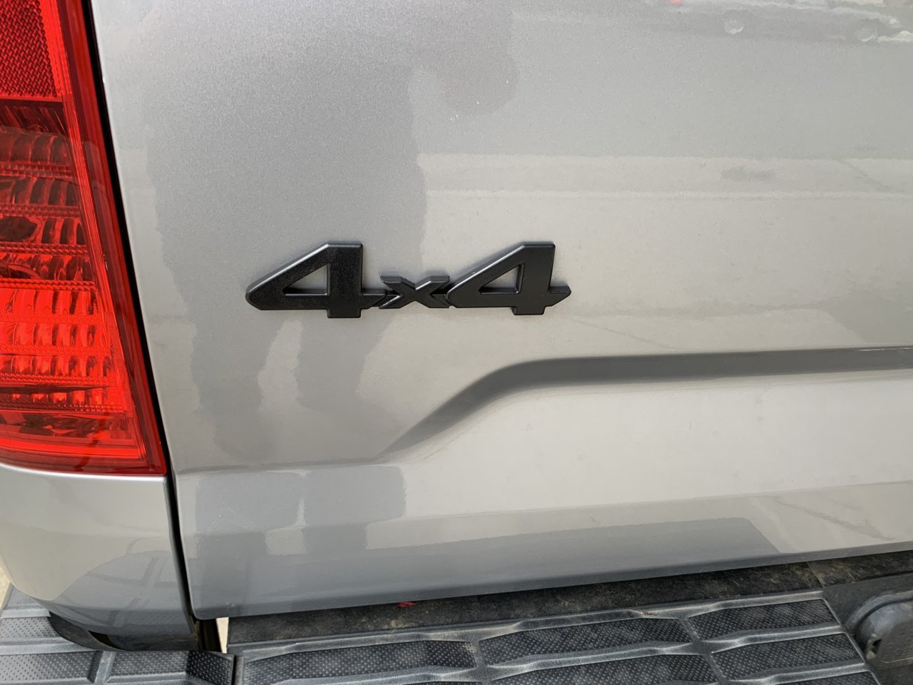

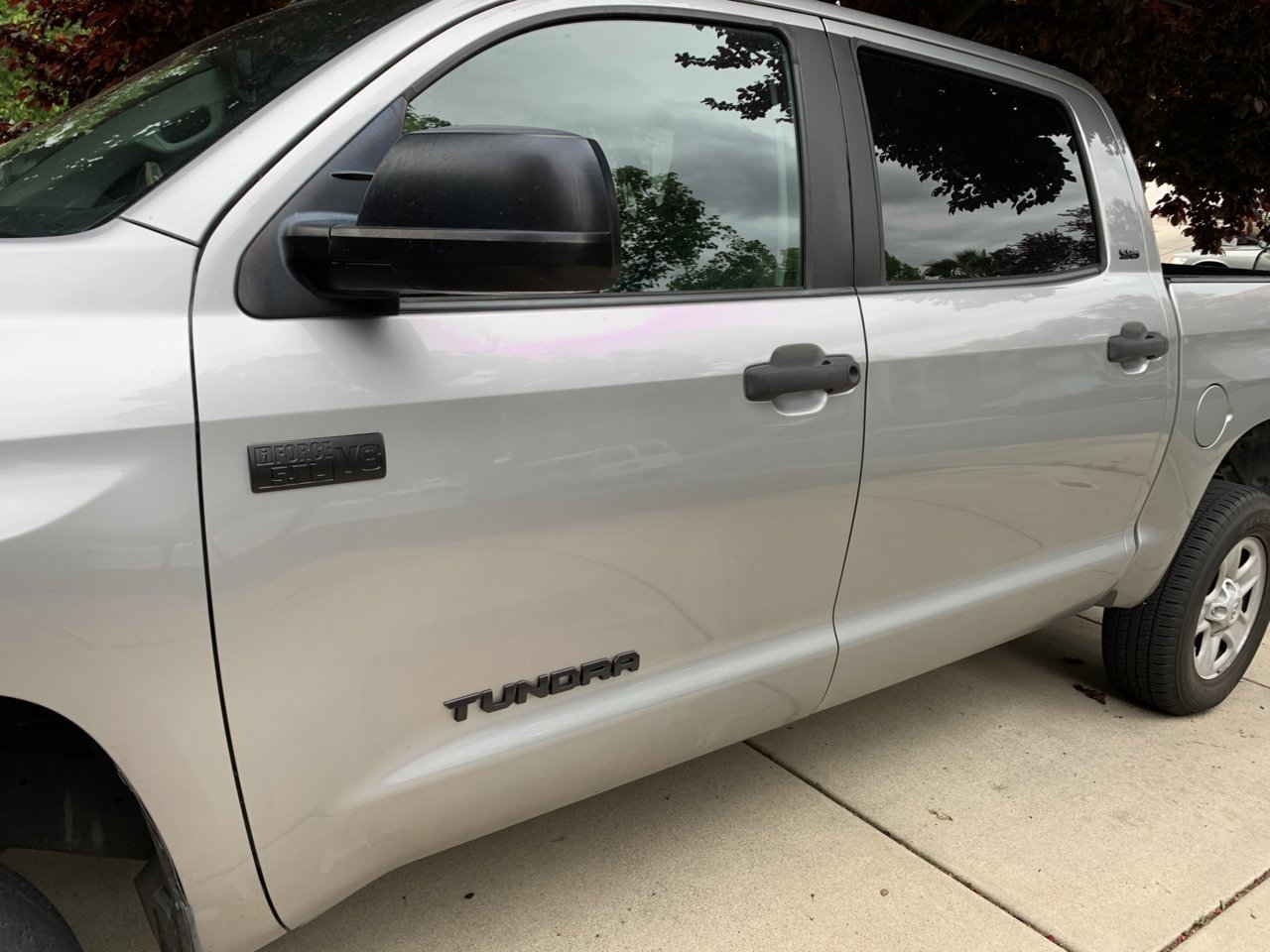

    Got tired of the silver emblems. Had a bunch of plasti-dip just lying around the house. I think it came out pretty good. About 6 coats on each emblem.

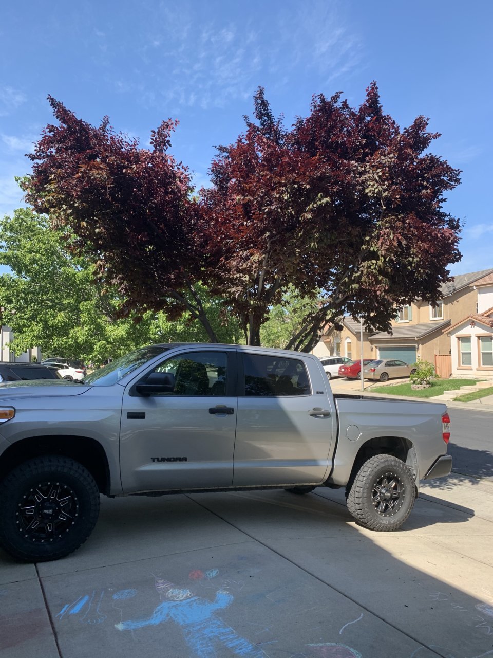

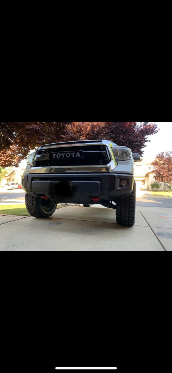

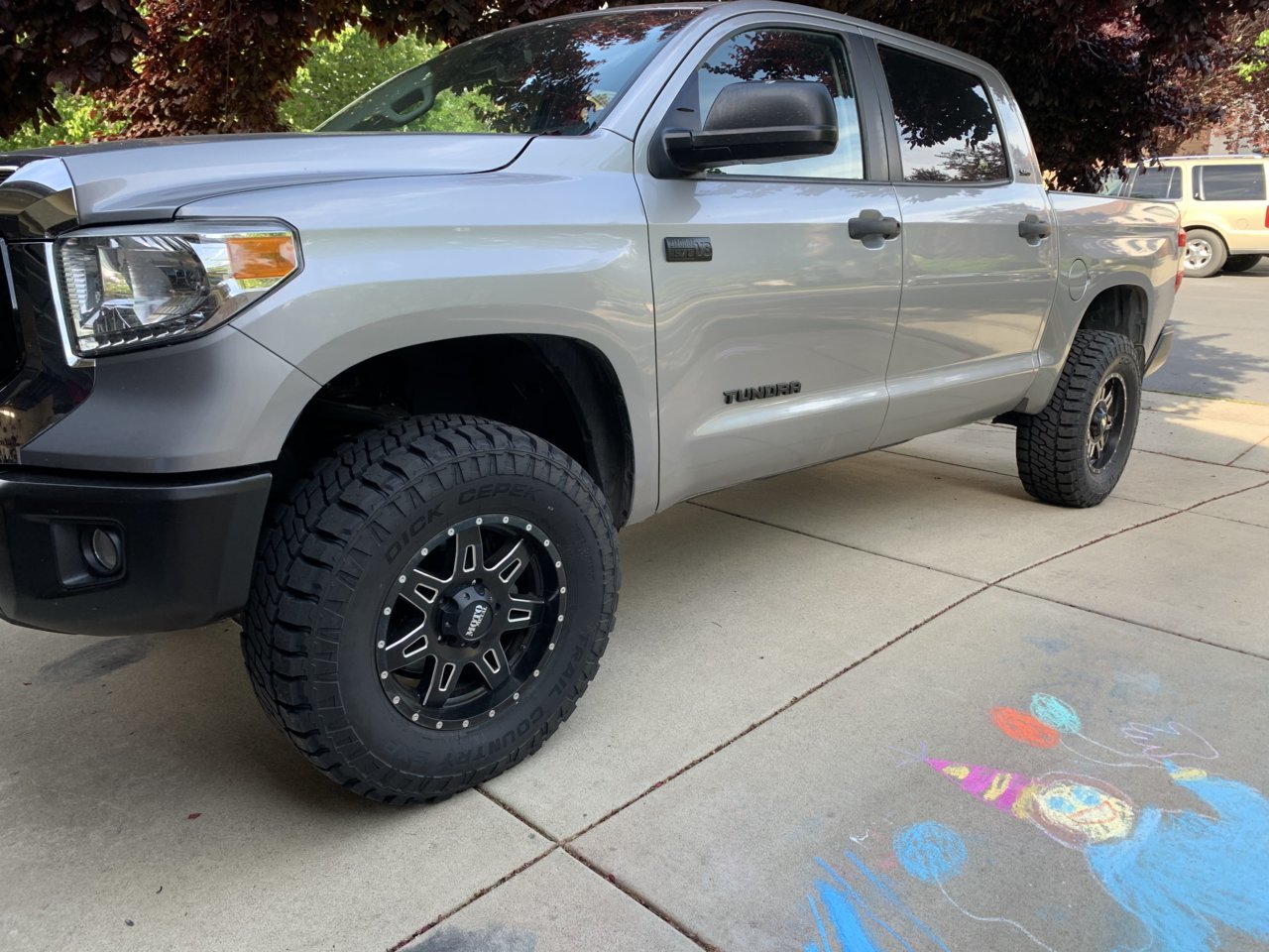

    Newest update...
    -Plasti- dipped the front and rear bumpers.
    - installed 3/2 lift
    - just got tires mounted 35x12.50r18
    - rims are 18x9 with +18 offset that I’ve had in my garage for a few years now.
    - painted the front tow hooks “Toyota trd red” as per local dealer.

    Love the Silver color. How hard was it to mask off the emblems?

    Them emblems were pretty easy. Left about an inch around the emblem of just body and taped around that. Plus the paper to help with overspray. I found it helpful to dip on the body, so when you peal the tape off the excess come with it.

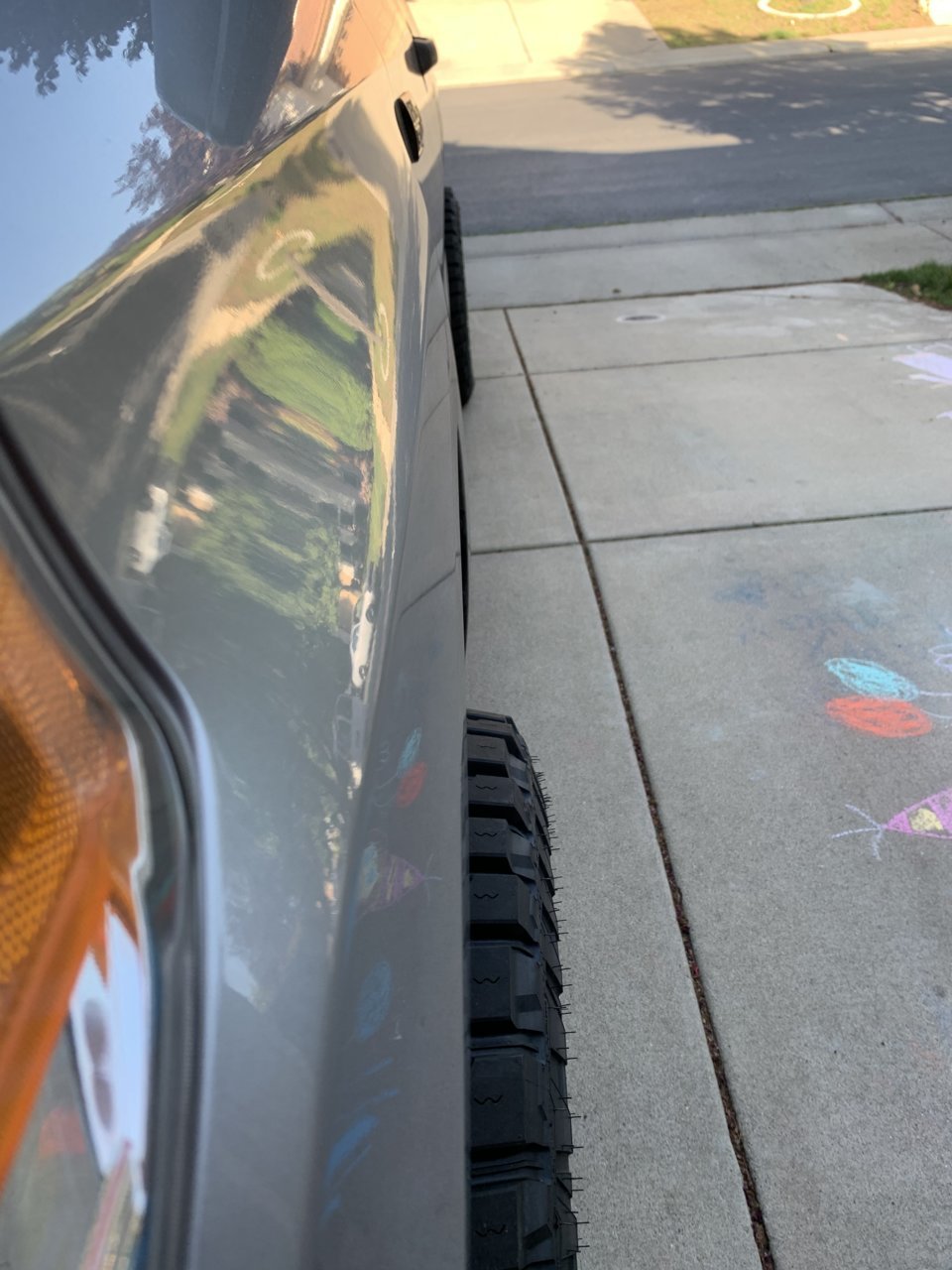

    Which 3/2 lift did you go with? It’s looks higher. Did you need UCAs? No issues with rubbing with 35” tires? Great looking set up, I’m thinking that height would be perfect for my truck.

    I went with a cheaper lift right now. I have the ready lift 3/2. No UCAs needed at this time and no tire rub. I love the look but I hate the feel of the block in the rear. I am currently checking out other options (shackles or leaf packs). And once the front shocks go out I’ll be replacing with a coil over set up.
