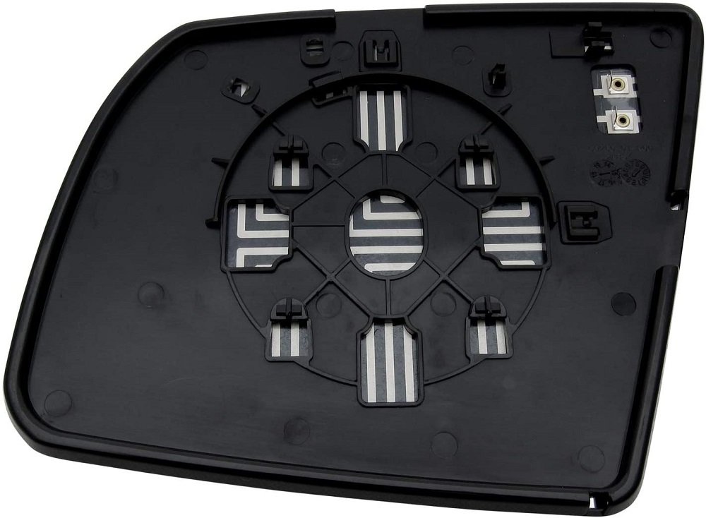

    No, the glass comes with the plastic on the back that snaps into the mirror housing.
    Take a large flat plastic tool, I used the largest tool from a trim tool set for cars, and put it under the mirror. Push up and it should pop off the clips.

    Yeah, I didn’t do that. Just removed the glass from the mirror housing.
    The replacement glass should come with that plastic backing.
