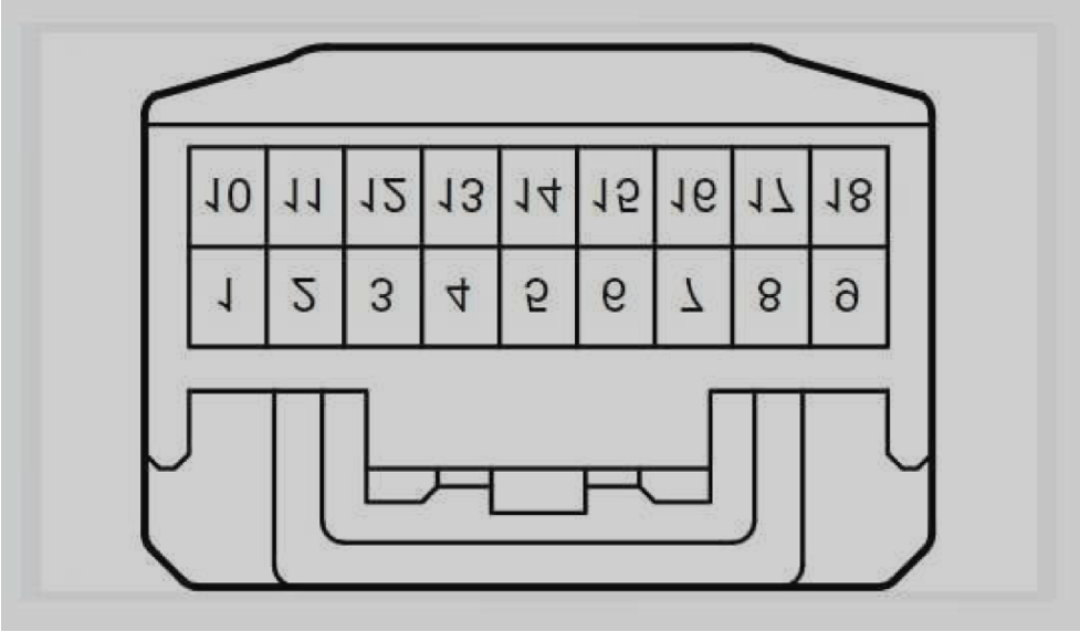

    The harness the plugs in to the side mirror is pre-wired for turn signals but from the harness (mirror side) to the mirrors themselves are not. You will need to run wires to make the turn signals work. Basically, run wires to position 5 and 6 from the harness to the mirrors LED turn signals.
    Here's a pic with the PIN location on the harness (sorry for the inverted numbers).
