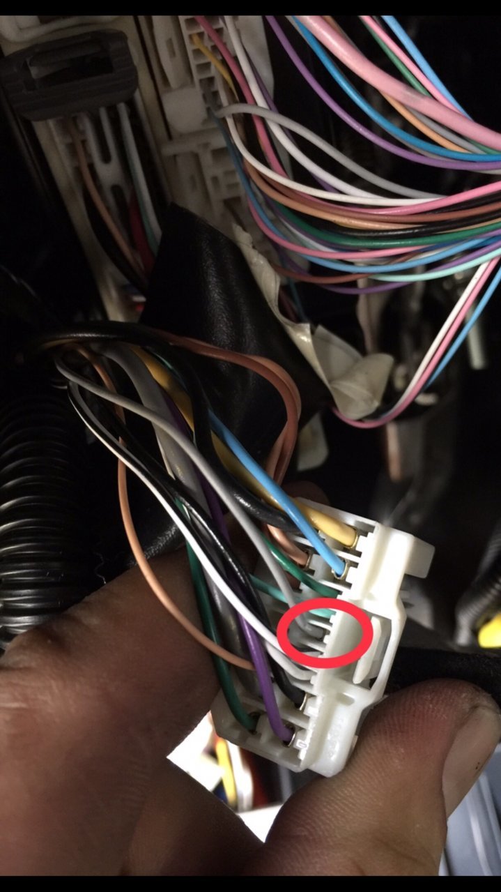

    2 ways
    One way you can get the non drl flasher relay from Toyota
    Or you can depin or cut the gray wire going to the flasher relay and that will disable the drl’s.

    Or simply unplug the drl connector at the headlight

    What if he puts a switch on the gray wire, then he can turn it off and on when he wants?

    I don’t know if mom sr5’s are the same. Our drl is not on the turn signal. The red wire on the 4 pin harness is the wire for the high drl. If you snip it no more drl.

    I’d just unplug it because the low drl will still function.
