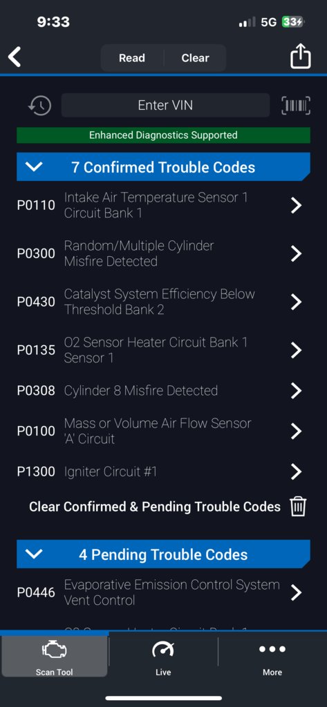

    Well, damn, this is embarrassing....
    My wife asked, 'could the CEL just be burned out'? And I was like....of course not....
    But then I checked and sure enough....no CEL with the key turned to on. Then I ran my code readers......fuuuq......this is an all time record for me.

    I take a look at #8.....and the coil has some writing on it under the dust.....just that coil....
    "Made in China"
    Spark test, nothing, swap with #7, nothing on 7, spark on 8....
    So at least this problem is solved. I will have to dive into the rest. I reset everything, and we will see what comes back. Who knows how old the other codes are?
    Put in a order at the local napa for pickup tomorrow. They had both Denso coils and plugs in stock.
