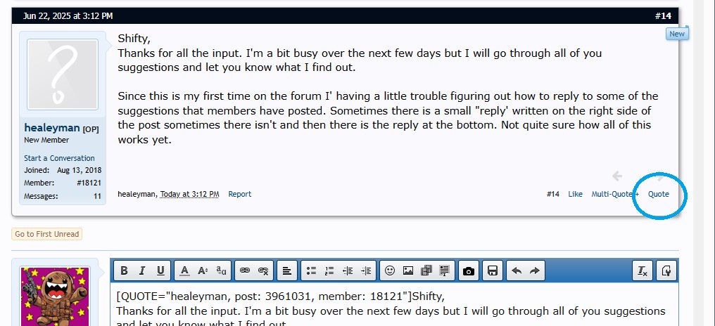

    Since this is my first time on the forum I' having a little trouble figuring out how to reply to some of the suggestions that members have posted. Sometimes there is a small "reply' written on the right side of the post sometimes there isn't and then there is the reply at the bottom. Not quite sure how all of this works yet.

    Easiest thing to do, if you want to reply directly to a person, is to go to the "QUOTE" link at the bottom of their text. It will insert their reply into the message-reply box, like you see here - I clicked the blue quote link, and as you see in my reply box at the bottom, it inserted your text with "QUOTE" tags, which makes it appear as you see above this paragraph. Hopefully that makes sense, if not, I can try to help explain it another way!:
