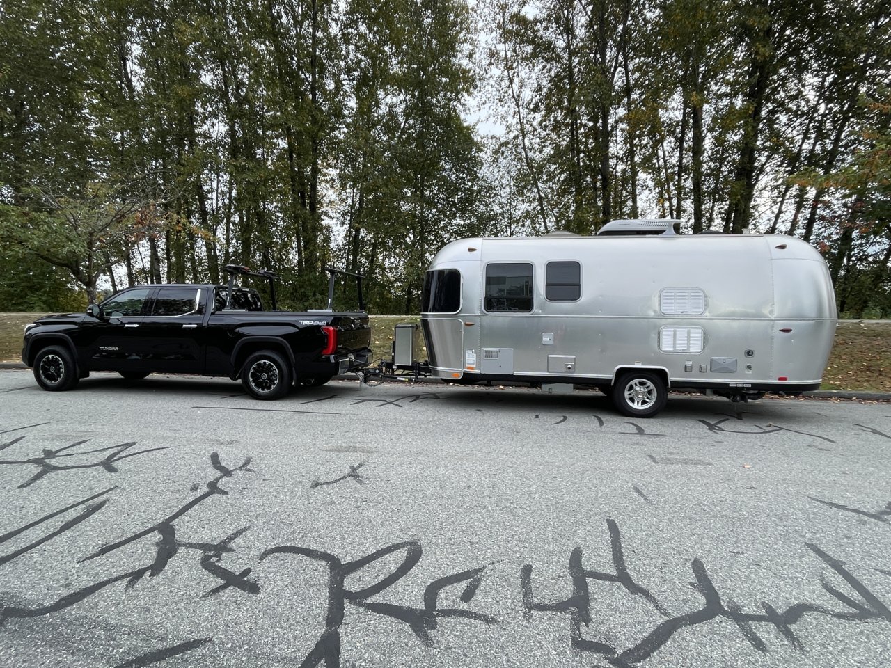

    You may not need it but using one will just make things better and help reduce the squat. Mine squatted over 2 inches with the trailer on and no WDH bars attached. My truck sits level with the WDH turned up and dialled in. Also, reducing the sway just makes for a more comfortable ride with less to worry about. My trailer weighs about 4,100 lbs and has a tongue weight of 500 lbs. The truck has no trouble pulling this trailer but the TRD Offroad suspension appears to be a bit soft to maintain level without help from the WDH.
    It sits pretty level here.
