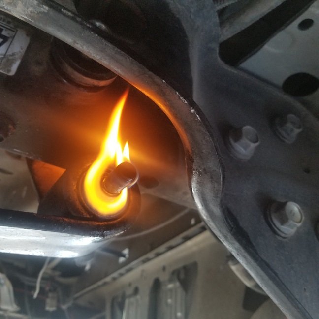

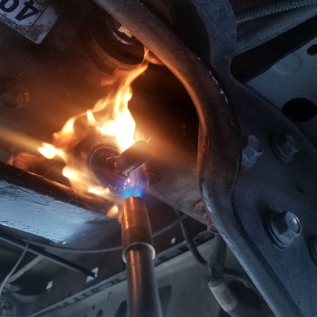

    i don't have a good torch, but i've lit it on fire numerous times with the bernzomatic and pb blaster, i've drilled holes in the rubber, i've tried prying it out while beating it with a hammer. my puller tool is unfortuantely about 1/4" too short to press it out.....f#$@
    i'm not known for my patience...so at this point, i just wanna get my sawzall out and make it all go away.

  4. Jan 26, 2019 at 6:05 PM
    Rica25
    Dec 6, 2017
    #11380
    5,553
    Ricardo
    Tulare
    Rent the press tool from auto zone or oreillys with a good impact wrench comes out like butter
