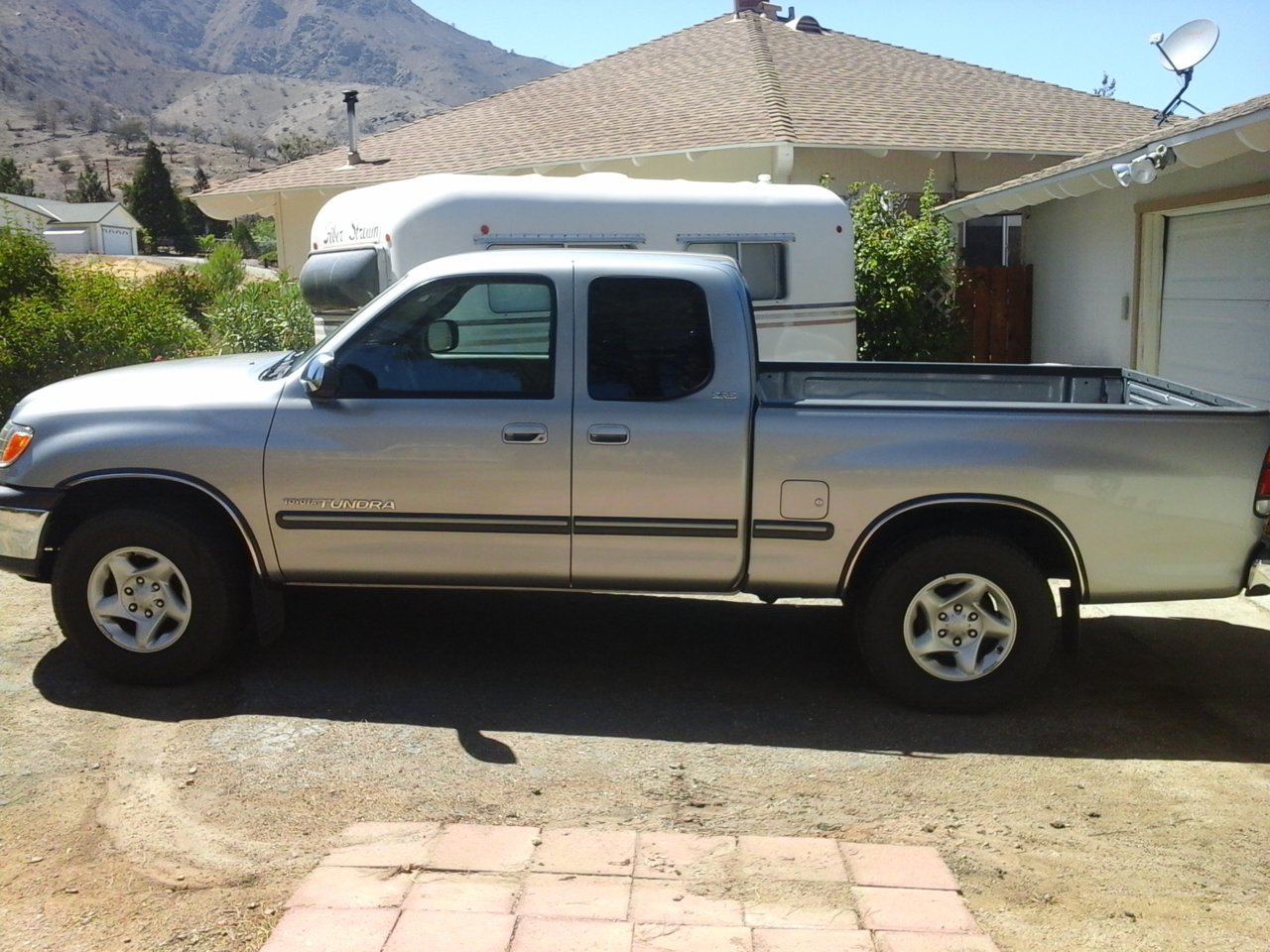

    I would just do some basic maintenance and not replace parts unnecessarily. Since it's a family vehicle you should have an idea how it's been treated for the last 20 years. Let that be a guide going forward. I have a 2001, I bought new, and it has 98,000 miles on it now. It sits for periods of time too. No problems, I've only ever done required maintenance, such as fluids and filters, and 1 timing belt replacement. I think the only other parts I've replaced were the shocks which were shot around 90,000 miles. Pictures or it never happened.:D
