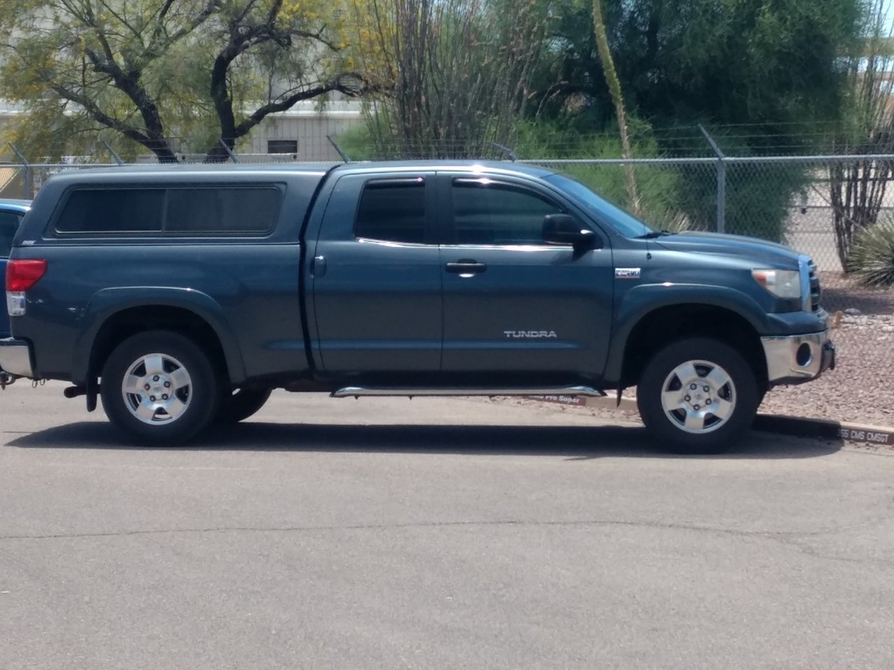

    A while back I noticed a Tundra in the parking lot at work, that I see all the time, had undergone a pretty dramatic lift in the front.
    So, being the nosey neighbor that I am I took a peek underneath and saw the owner had upgraded to 5100's with the spring perches set on the top setting. I also noticed that the perches were mounted upside down.
    I've seen the truck a lot but never met the owner so I go to my office and type up a nice note saying " Hey, being a Tundra enthusiast I noticed you upgraded to some 5100's blah, blah, blah, but I just wanted to let you know the sping perches are installed upside down, which could, potentially, lead to a catastrophic failure of your front suspension. If you have any questions here's my number."
    A few days go by and I finally run into the guy, super nice BTW, and he thanks me for the heads up and tells me how he doesn't off-road and just pretty much DD's and tows his bass boat with it.
    We have a nice conversation and I reemphasize that he may want to get that taken care of soon as it's really not safe to be driving around like that.
    Well, it's been probably 3 weeks since I gave him the heads up and they're still the same.
    Should I just MYOB? I wanted to help the guy out but I guess some folks just aren't too concerned about stuff, even if it could cause an accident.

    Oh yeah, no alignment done. Inside edges are wearing fast and should be hitting the cords very soon.

    Awesome bro lean. A bag of groceries in the front seat should correct it. Maybe?

    After some thought. Does he have uca’s? Probably not, which means there is no way they aligned it perfect with that much lift. So when his tires wear out really fast, he will learn

    No UCA's. So much positive camber the inside edges are already gone.
