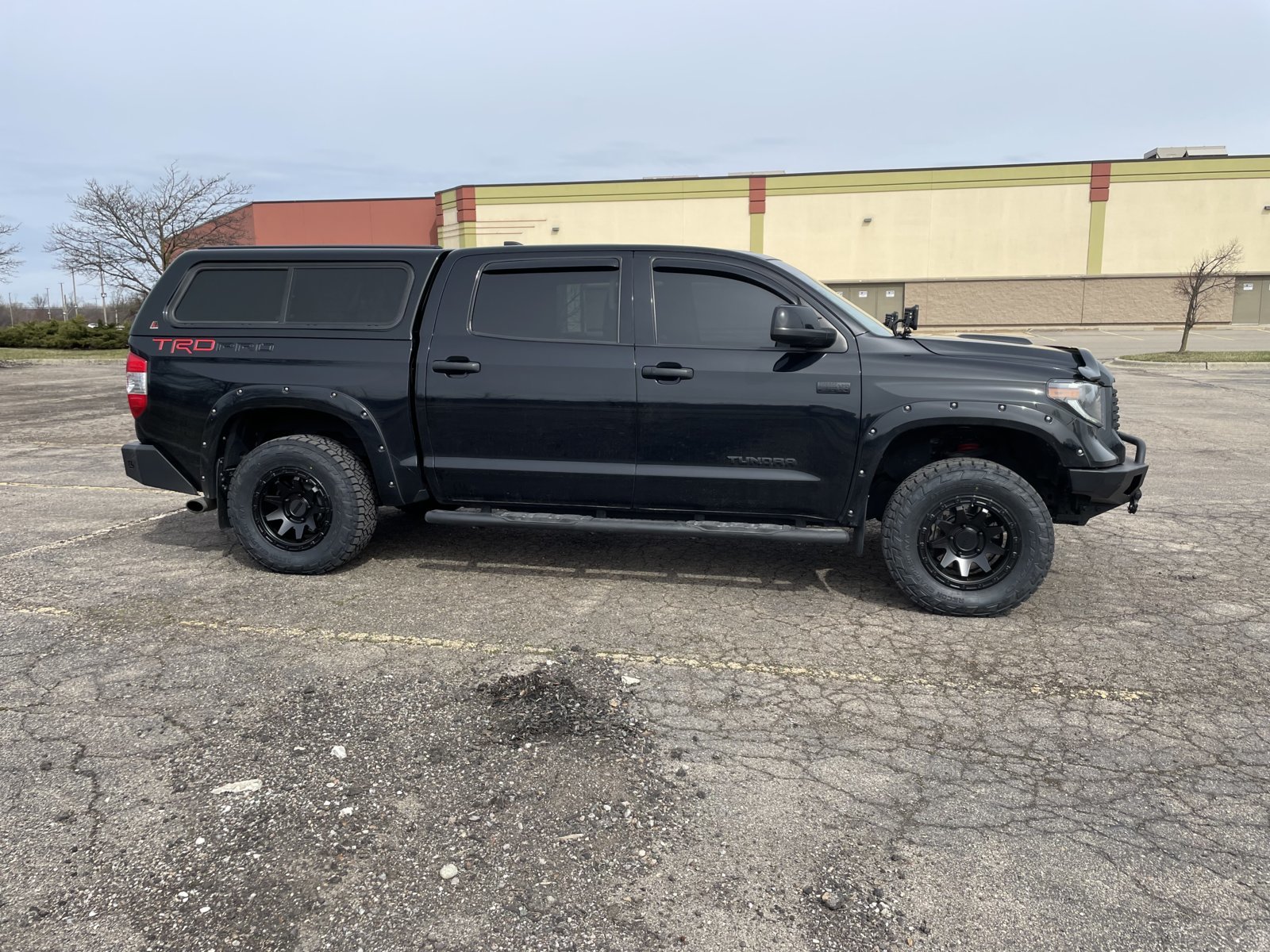

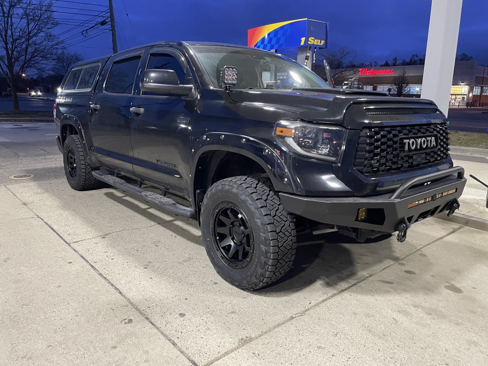

    This is my 2021 TRD Pro. Have c4 over landing series front and rear bumper and the Ekstrom designs coachbuilder trd pro lift/level kit. According to website - Rear 1.75 lift and front 1.00 lift. I currently have 285/65/18 +18 on the wheels/tires. Just wanted to get your opinions if you think I can fit atleast a 295/70/18 on it. Thanks for your answers.

    Based on the wheel well clearance, I think you can easily fit the 295/70’s.
  3. Apr 1, 2024 at 2:52 PM
    b6graham
    b6graham New Member
    Oct 25, 2023
    #105979
    424
    2020 Voodoo 1794 RW Wheels 315/70
    might have to remove the mud flaps, but even with a +18 you should be close to good without a BMC, especially if you pushed the front wheel forward a little with some extra caster

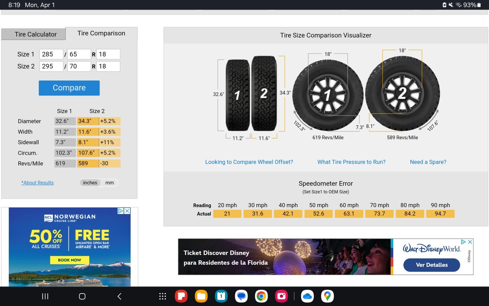

  4. Apr 1, 2024 at 5:20 PM
    Tundra234
    Tundra234 New Member
    Nov 30, 2018
    #22402
    18,030
    George
    Florida
    2020 Tundra DC SR5 Barcelona
    Alot of them
  5. Apr 1, 2024 at 6:47 PM
    biebs96
    Jul 30, 2019
    #33915
    3,298
    PA
    What about 285/75/18s?
    frichco228 likes this.
  6. Apr 1, 2024 at 7:08 PM
    b6graham
    b6graham New Member
    Oct 25, 2023
    #105979
    424
    Those with a +18 might be just as tough compared to the stock +60s
