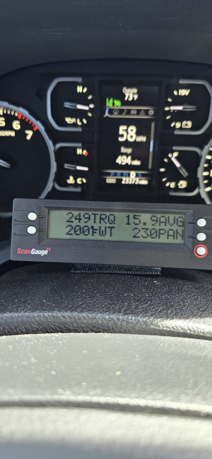

    I have a 2021 Tundra. And temps got way high (imo) without towing. What are your thoughts?

    I'd call that high.

    They took the trans cooler off in 2018. I installed an aftermarket cooler kit from genuine cooling system .com and it hasn’t passed 200 even with heavy towing in 100° weather. Highly recommend. Hardest part of installation is running the OEM hard lines that come with the kit

    I just sent a sample on ATF to Blackstone Labs. I have a 21 and tow. The temps you are seeing for the TC are normal. Sitting at a stop light or climbing a small hill will bring the TC temps up real quick but they drop back down just as quick. I don't like your pan temps. Is that normal? Seems like your WT is higher that mine. 194 is about normal for me.

    With the the cooler kit mentioned I rarely see temps over 200. Temps drop fairly rapidly.

    I see temps around 230 pan when towing my 8000# travel trailer. What’s the details on this drive you were going? Emergency brake on the whole time?

    That temp is still in the acceptable range according to Toyota. The warning light goes on at 300 degrees.
    With that said, I tow a fairly large travel trailer with my 2018 and I will only see that range if I run with a heavy load and use 6th gear going up a hill and the torque converter isn't locked. The highest I have seen even with the factory cooler is 257 degrees.
    In S4, which is where I sit most of the time, the torque converter is locked and the temps balance between the pan and converter at a lower range. Next time you see those drop it into S4 and watch it drop.

    My pan temps have never gone over 230° when towing. I always tow in S4. Torque converter temps will get up around 250° during uphill pulls, but will quickly return to pan temps when leveling out. No trans cooler.
