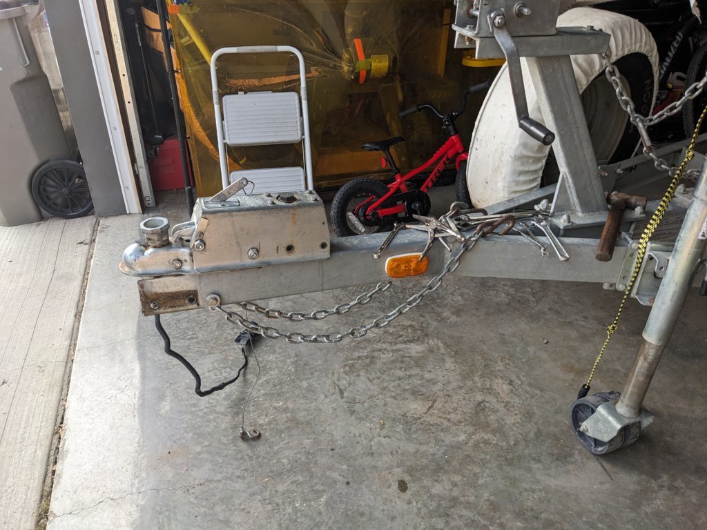

    Alright towing geniuses, any reason I shouldn't cut 17" off my boat trailer tongue so it fits in my garage without having to put the rig on an angle?

    You could also install a foldaway tongue kit. As an alternative.

    Thought about that but my brake lines are rigid. I'd have to completely redo the brake system.

    You will need to put more tow vehicle in the water at launch and load

    Shorter tongue will make it more squirrelly. I wouldn't do it.
    How big is the trailer? Is it light enough to back it onto ramps? Might buy you a few inches the same way ramps in the bed when loading a 4 wheeler can get enough room to close the tailgate on a shorter bed.

    Meh. I haven't even needed to get my tires wet yet at this point. 17" won't make much difference.
    The boat is just under 1200lbs. I'm not putting this rig on ramps in the garage.

    Thought about it, since I would like a dual axle trailer eventually but that's not in the cards right now. Cheaper to install a folding tongue. It appears that if I do that, I would need to install a piece of braided steel brake line. So it's possible, just more of a pain.

    Also have to consider clearance on tight turns at some launch ramps.

    Fuck it, I may as well do this properly. I pulled the trigger on a Fulton swing tongue kit. Gonna have to get a braided brake line made up but it should work.

    You can get an electric over hydraulic actuator for surge brakes if you want to spend some more $$$ and get fancy.
