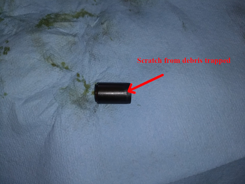

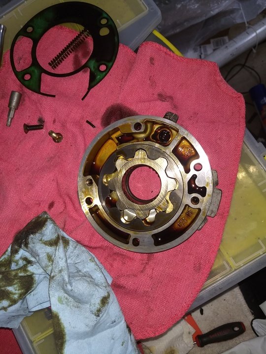

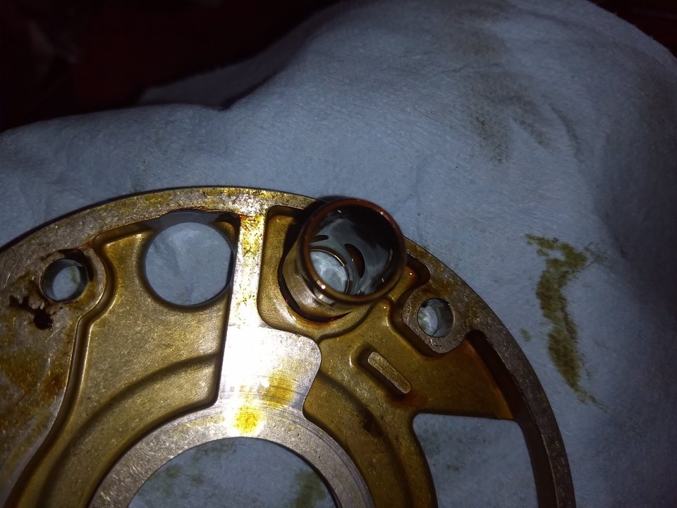

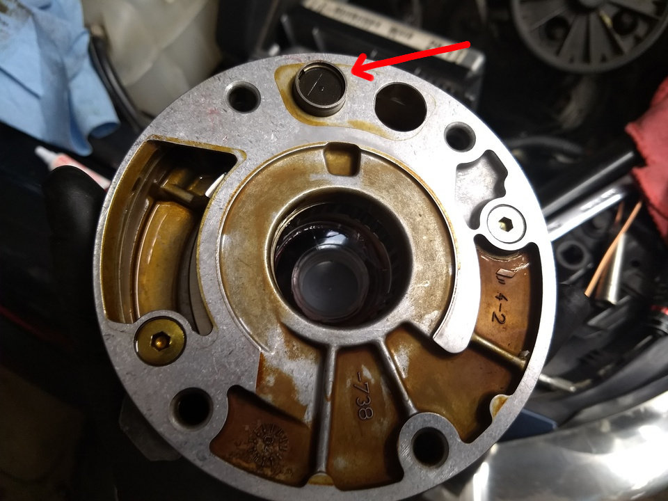

    NS (natural stupidity) answer: machining debris and carbon buildup float in oil all the time and engine does not give a sh*t about it, because this is how it always has been. However, in this new engine Toyota changed the design of oil pump to reduce pump losses. I'm lazy to google it, but perhaps oil pump pressure is electronically controlled. Perhaps, at low RPMs the pump does not build much pressure at all, just to save you 0.001 MPG. Now, it still has a mechanical pressure relief valve. When pressure gets too high at high engine load, the spring-loaded valve is pushed inside the bore and opens drain holes, which allow a part of the flow to simply return back to sump. In the engine oiling system, the pump sits next to oil pickup tube, before the oil filter. It gets all the debris suspended in oil. It happens that debris get trapped between pressure relief valve and its bore. The valve then can't fully close, some pressure gets always lost. When engine load drops, ECU commands pump to reduce pressure in order to save 0.001 MPG. Pump follows the order and drops the pressure to barely enough for the main bearings to survive and let the owner chance to post an MPG supremacy (over prev.gens) comment on tundras.com. But there's a parasitic oil pressure loss now, so the bearings get oil starved and die. Knock-knock!
    Here's an example of a typical oil pump with visible debris marks on the plastic body of relief valve. Note, that this engine model use plastic valve, which scratches, but allows the valve to close fully, even with debris trapped.
    Pump and relief valve location:
    Pump disassembled:
    Bore of relief valve:
    Debris-damaged relief valve:
