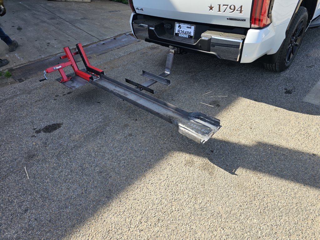

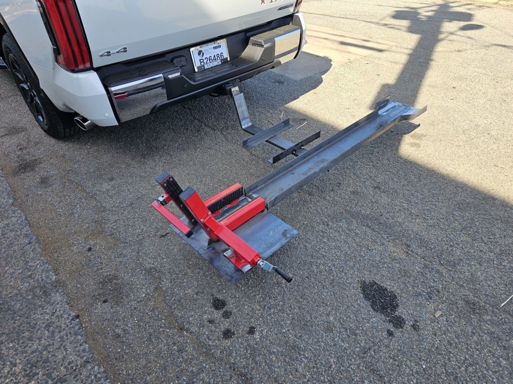

    I hope I can get some answers here. Please help. I shop made a custom motorcycle hitch carrier for my Triumph Rocket 3. The dry weight is 650lb. My carrier is solid bar and channel, my guess is 150lbs.
    My Tundra is 2025 1794 edition TRD Offroad. Can this work?20250430_160130.jpg 20250430_160136.jpg

    Depends on how much you trust the shop. Me personally, my bike is my life, enclosed trailer all the way for transport. This setup though, your rear might sag a lot and any bumps you will surely be scraping. I’d figure out what the weakest link is and go from there. Specifically the welds. My saying is it’ll hold until it breaks whenever someone asks me about my welds.

    Let me clarify: I made this in the shop where I work. The welds are A+. The solid bar is 1×3½. It sits at 8" off the ground, but I was considering raising it up some. My concern is the class 4 hitch, can it handle 800lbs on a hitch carrier?

    Thanks for clarifying, I’m assuming you mean the hitch itself, not the hitch receiver? The hitch should have a rating for its maximum tongue weight it can safely handle, generally a maximum of 750lbs for welded ones and higher for forged ones.

    I'm worried about overloading the receiver and damaging the truck. The hitch carrier itself is OVER built.

    You won’t damage the truck. I’m more worried about your bike than the truck. Check your door sticker and find the maximum load your truck can hold and that is your maximum weight your hitch receiver can take, including your own weight in the driving seat.

    Ok, this is good. I'm going to raise the carrier another 4" off the ground. That will rest at 12". And with a total weight of roughly 800# the receiver and truck can handle that no problem?

    Attempt at your own risk. This is very unconventional way of transport for a very heavy bike, so long as you’re within your weight limit for the payload of the truck, everything should be fine. Why not load it in the bed?

    Not true at all. You have to worry about the hitch rating, not just the payload. Then there is the leverage that having it sit that far out will put on it.
    Not a chance in hell I'd try to carry a bike that heavy on the hitch @Jthamblin1 . There's a reason the after market carriers don't approach the weight rating of a bike that size. I wish it were safe to do as I have a big fat bike as well, but it's just a bad idea.

    This info might be of use. https://www.tundras.com/threads/2022-tow-hitch-receiver-ratings.104156/#post-2679082
    According to that the hitch is rated for 500 lbs dead weight without a weight distributing hitch. You're way over that. You risk bending or breaking something on the truck. Maybe it'll be "fine" for 100 or even 10,000 miles, but so was the Ram that broke his frame in half because he was overloaded. He made it 20K miles before the failure because these kinds of overloads don't usually have immediate consequences. It takes time for the abuse to add up and really screw things up.
    You're best bet is to get a trailer for the bike.

    Why is the bike so far away from the truck? Were you not able to mount it closer? There's a lot of leverage going on there. And why not add a gusset where you bent/broke the main bar?
    https://joehauler.com/ Maybe send Joe an e-mail and send the pics. Get his opinion on it. He's a good dude and might give a word of advice.

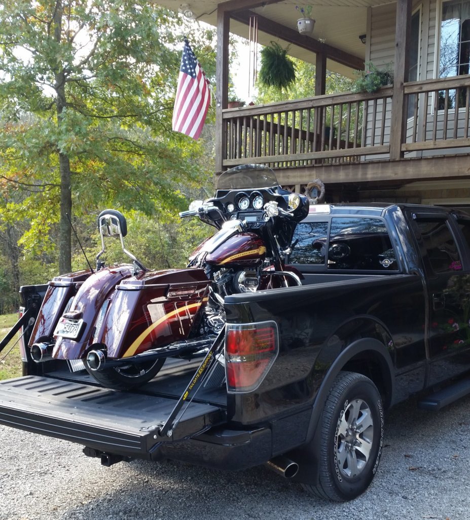

    I'd recommend a long and wide ramp and load it in the bed of the truck. It'll be much safer. The leverage on that + the hitch weight wouldn't be ideal. I see you mentioned raising it up as well, as it sits you'd likely drag it on driveways from the change in angle and how far it sticks out.

    That’s 800# max right at the hitch receiver. Your pushing it back a few feet which multiplies the torque and effective weight at the receiver. Think of a torque wrench. I think you’ll be way over and the bike is going to bounce like it’s on the end of a fishing pole. Sorry man. I wasn’t happy with one that was only a foot back. Way to much bounce and twist.

    Gusset on that first bend for sure, if you do risk the weight.

    Whats the small rack in front of the the bike rack for?
    Thats a lot of weight hanging that far out.
    If it were a static load It would be fine but add in the crappy roads out there i'd be concerned.
    I'd try and find some numbers of a store bought unit and see how they compare.

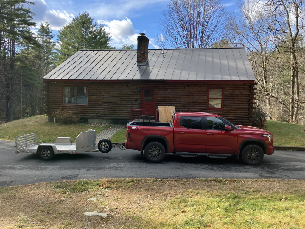

    I would not trust that for a bike like the Triumph Rocket. As mentioned, that is too far from the rear of the truck putting strain on the frame and receiver beyond what it was designed for. You have an expensive truck and bike and I wouldn't risk it.
    Before I retired to our former vacation cabin in Vermont we lived in Florida and I made many trips back and forth hauling bikes on my trailer with my old 2nd gen Taco. This trailer only weighs 375 pounds and is rated for 1500 and cost $2500.

    There's a reason no one sells a carrier like that. Regardless of weld quality, the hitch or carrier will fail at some point. Too much load cantilevered too far from the connection. Trailer.

    800# is too much! A couple of good dips in the road will make 4x that load!
    not to mention that you only have 8” between the bottom and the road when unloaded. Not much room for travel.
    take you and three friends and jump on that thing. I am betting you will feel the same after experiencing that.
    Nice looking fabrication work. You did a great job.

    I make no claims of being an engineer, and there are plenty of those on here, so someone check to see if my math is mathing:
    800# located (guessing) 2 feet away from fulcrum point is creating 1600 lb/ft of torque (not even factoring in acceleration due to gravity) attempting to twist the hitch off the back of the truck.
    Get a few good bounces going and something is going to give.
    Short answer, as already stated: Too much weight, too long of a lever.

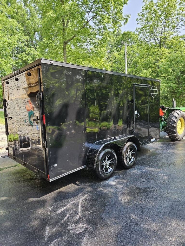

    So, just my personal opinion…. If I take a bike somewhere with my truck it’s either in the bed or preferably on a trailer. That’s specifically why I purchased a larger enclosed trailer a few years ago.. to get both my bikes in it if need be. A hitch receiver is designed primarily to have a hitch and ball or shackle hitch installed and the weight is designed to be carried from that specific location.
    Companies make all sorts of racks and attachments to slide into hitch receivers for whatever reason.
    Do whatever you’re comfortable with I guess, just remember there’s other people on the roadways besides you that your poor decisions may affect..

    A couple people are correct (terminology might be a bit off :D ). The issue is not the the straight vertical load (shear), but the bending moment (essentially torque) on the receiver. I'm not sure how much moment the receiver is designed for, but we can make some assumptions since the truck can handle about 1000 lbf of tongue weight with a ~12" hitch, that's 1000 ft-lbf of moment. Someone above assumed a 2 ft lever arm for your setup, which sounds low to me, but 800 lbf @ 2ft is 1600 ft-lbf so already substainally higher than a "possibly normal load from a trailer". Of course there are factors of safety for everything, which is why people have done this and been fine, I'm sure there's a factor of safety of at least 5x or higher.
    However, looking at your contraption, it looks like it's solid 1x3 for the primary load path to the hitch? That's a moment of inertia of 3*1^3/12 = 0.25in^4, which is then a bending stress at our assumed 1600ft-lbf of 38,400psi. Normal A36 steel has a yield strength (it becomes to bend so far it becomes permanently deformed) of 36,000psi (thus the 36 in the name A36). So that little 1x3 flat bar will permanently be bent just with the bike statically loaded on it. Usually you want factors of safety against yield, even though you wont catastrophically fail at yield you usually don't want an object becoming permanently deformed. That means your setup----just with the bike sitting on it and not bouncing around----is at least 5x undersized. Additionally you will see massive deflection, even if it didn't yield that bar will deflect multiple inches just sagging from the weight.
    All of that to say, I have no doubt it can work, at an absolute minimum you need to brace the primary structure and I'm not talking about just a gusset. The entire length needs to be beefed up. In that moment of inertia equation it is base x height CUBED, meaning a little height has a huge effect, this is why tubing is often used because it has a very tall section and (relatively) low mass. It's also why an I beam is an ideal shape. I wouldn't just throw more flat bar on it, but weld some rectangle tubing everywhere and it will drastically increase the strength and stiffness. That doesn't solve how much the truck can handle though, which is really just a judgement call on your behalf, no doubt the truck can handle it but you're probably beyond the rating of the receiver and maybe other componenents for how much moment is allowable, that doesn't mean it will fail necessarily, but it's the same logic of loading your truck with more payload than it's rated for.

    If mine, I would re-work it to:
    1) Eliminate the drop. Get the bottom of the rail no lower than the bumper.
    2) Bring it in as tight as you can to the truck and reduce the lever effect.
    *edit*
    3) And I'd still brace the hell out of it. (and cross my fingers for luck)

    No way I'd put a real motorcycle on something like this. Maybe an e-bike or a MoPed. Even then with the dynamic forces from hitting bumps or dips at speed, that multiply loads many x, I'd be very careful.
