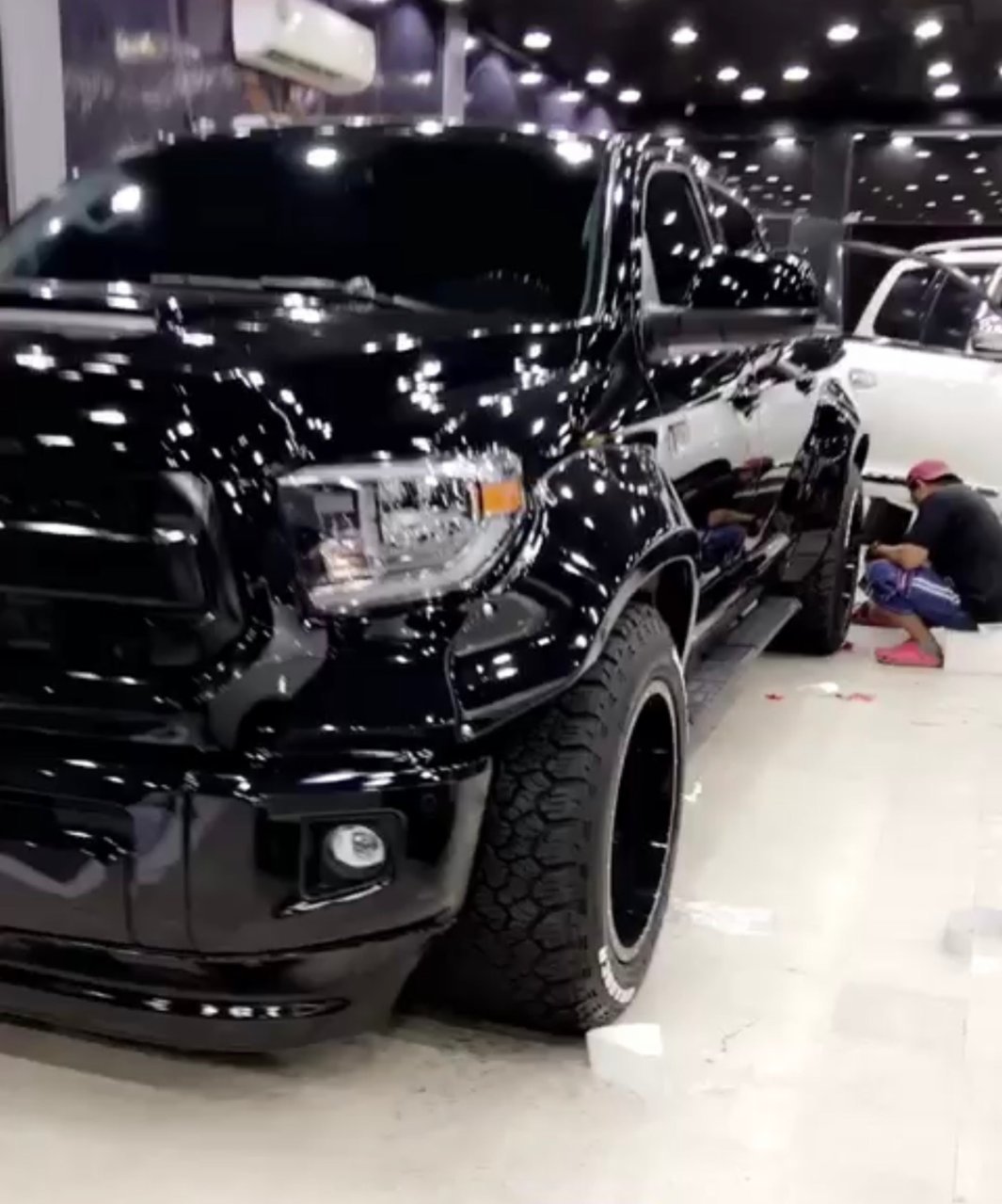

    Hello friends i need some help and opinions am kind of confused
    I decided to get the the Bilstein shock front 6112 and rear 5160 i want to install the Upper Arms but confused which will fit with the setup am doing and best in the market .
    What should i go for Total Chaos , JBA , Pro Comb , Dirt King , Icon ...etc
    I want be using it heavy in the desert once every 3 month or maybe more
    So what i should go for . Am sick and tired of my Truck lowered time to change
