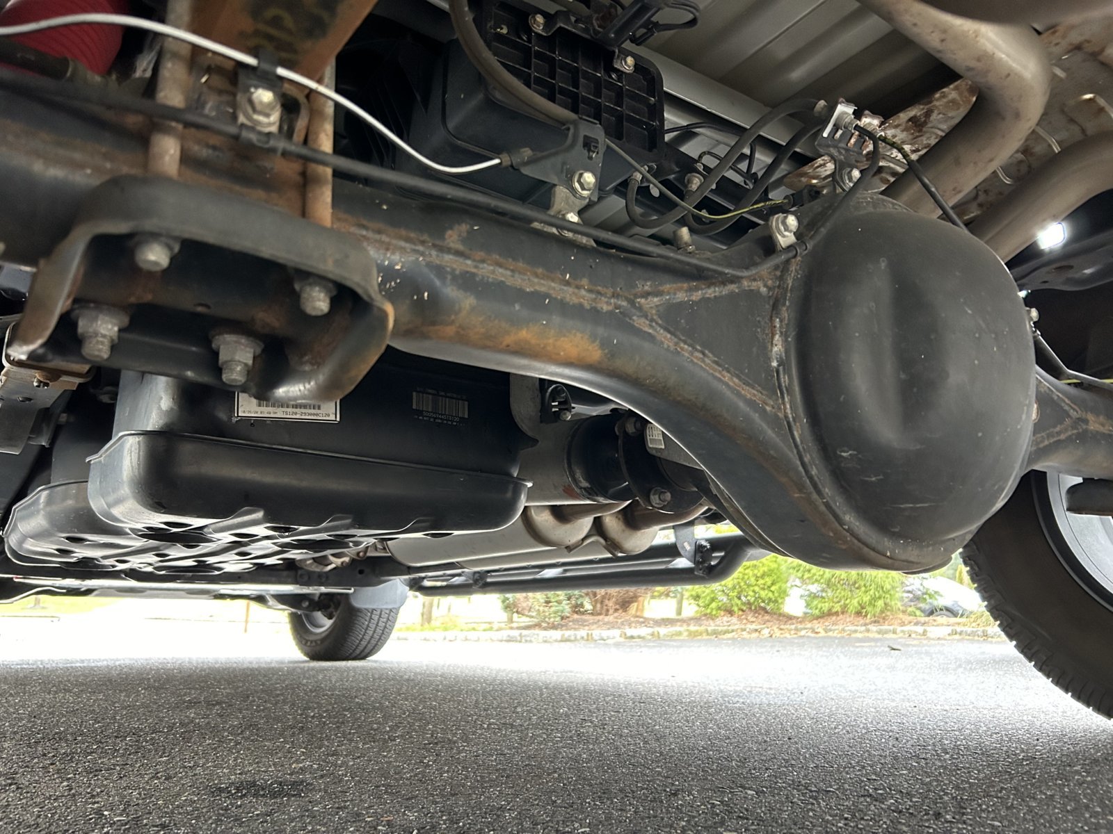

    For the guys who have added the rear TRD sway bar, was your truck equipped with any sway bar at all? My ‘21 TRD Pro has nothing in the rear, do I guess I’d need the entire kit, like this:
  16. Dec 24, 2023 at 9:37 AM

    All our trucks have swaybars unless removed by the truck owner.
    I think y'all have convinced me. I'll buy some TRD swaybars and install them. Doesn't seem like an expensive upgrade for ride quality.

    @citrusmaster Interesting. I am the second owner of my truck, but no evidence of a sway bar here. There is one in the front however.

    I believe the only trim with the rear TRD sway bar from the factory was the TRD Sport (not TRD Off-road). That trim wasn’t available until sometime after the mid model refresh in ‘14.

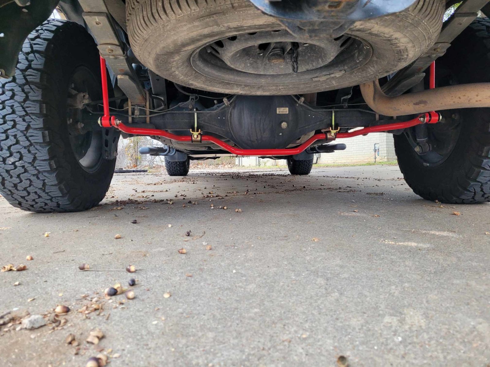

    I got my rear swaybar installed. It went very smoothly and was extremely easy. The kit came with no instructions but I was able to find some instructions for how to install here. Took less than an hour start to finish. I am pretty impressed with the quality of the kit given that it came off of Ebay. Well worth the money I'd say.
    I took it for a drive and it definitely feels a bit tighter on turns. Planning on ordering my shocks tomorrow.

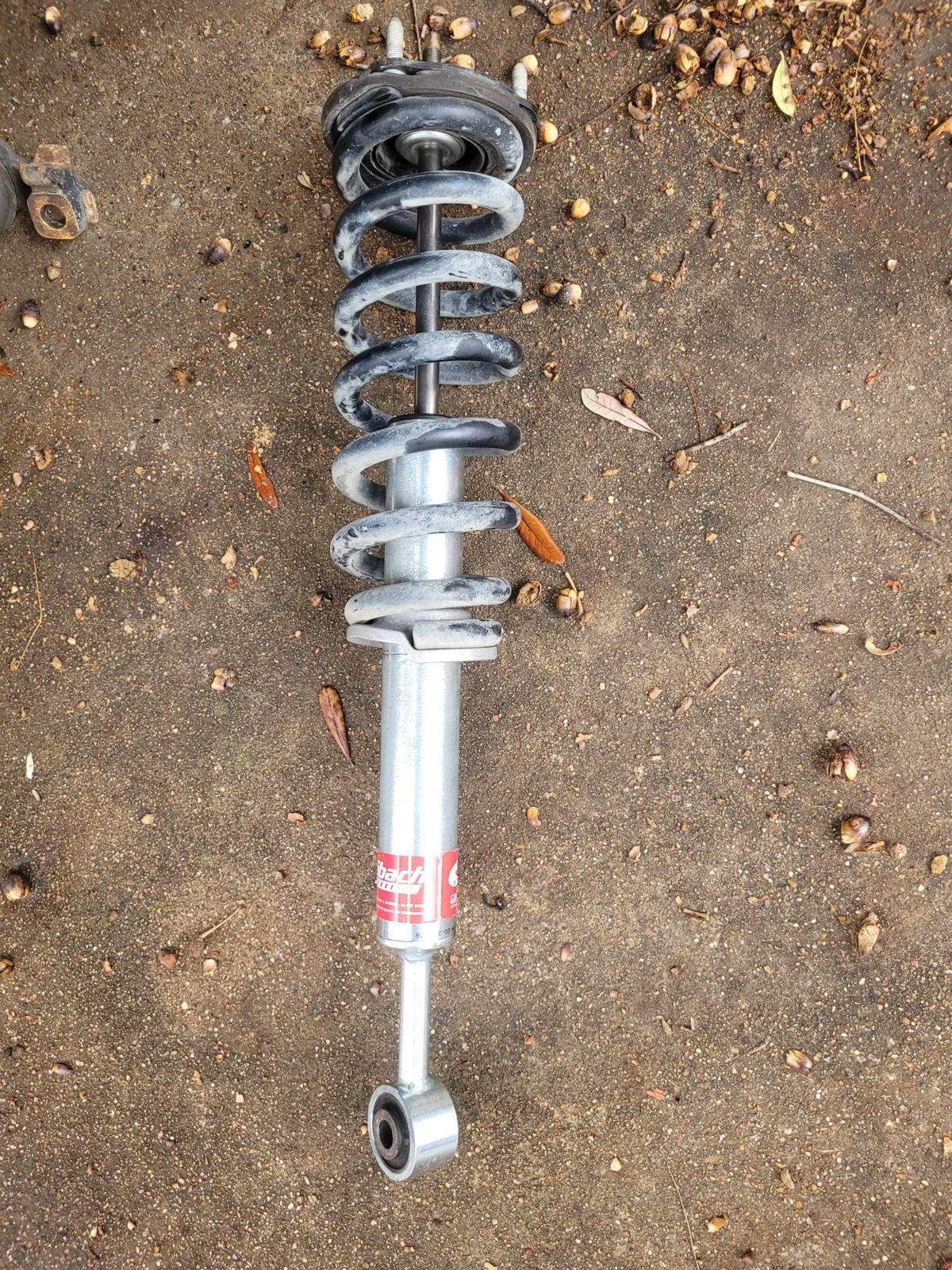

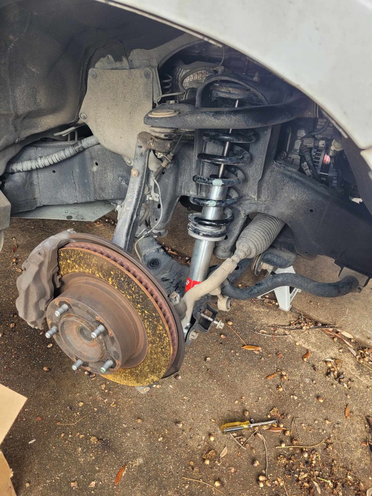

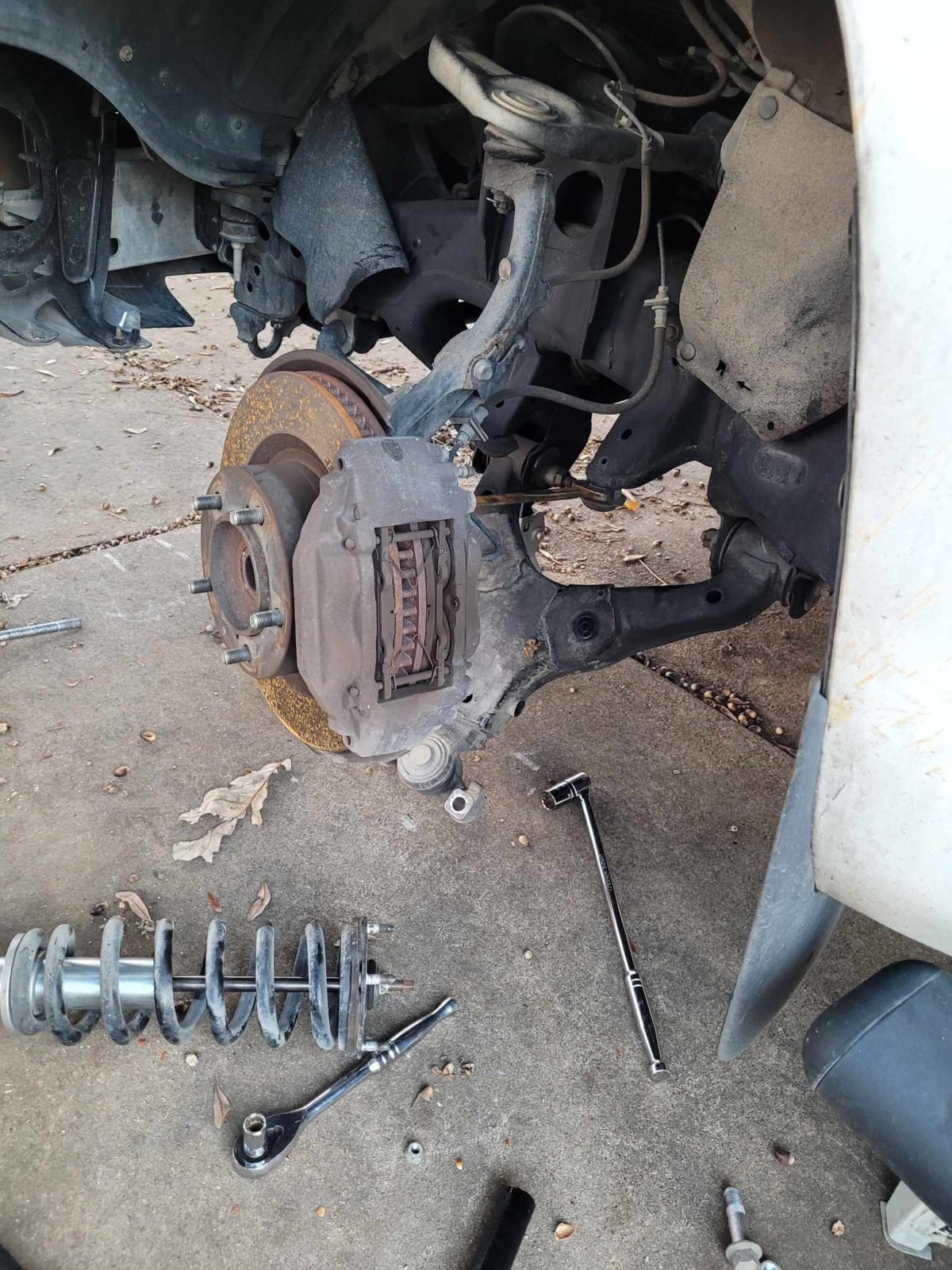

    I purchased the Eibach front shocks that user Hbjeff had for 83$ shipped, and had a local shop swap my stock springs over for 40$. Total of 123$ to get them on.
    A few notes in install: Doing the job wasn't too bad, but I did ended up wasting an hour trying to find the "quick way." First side took two hours, the second side 1 hour. I thought that I could wiggle the strut out without removing anything by just prying on the lower control arm, but after some time trying, that isn't possible. I then thought since mine was 2wd and didn't have a CV axle it might be quicker to disconnect the upper ball joint to remove it, but I soon realized that was a lost cause and gave up on that as well.
    Things moved very quickly after I dropped the lower control arm similar to this video. This is definitely the quickest method and I recommend it to any others doing this job. Disconnect your sway bar links, jack up the truck, remove the lower ball joint bolts, and ever so slightly loosen the lower control arm bolts. After this just remove the upper and lower strut bolts and it is out.
    I have my spring perch on the middle setting, and it looks to have added about 2.5 inches of lift as advertised but I will measure tomorrow to get the true lift amount. Front still looks a small bit shorter than the rear so I am happy about that. I still probably need to get an alignment this weekend, but it didn't look too far off with eyeballing and a measuring tape for toe angle. I drove it a couple blocks and didn't have any issues.

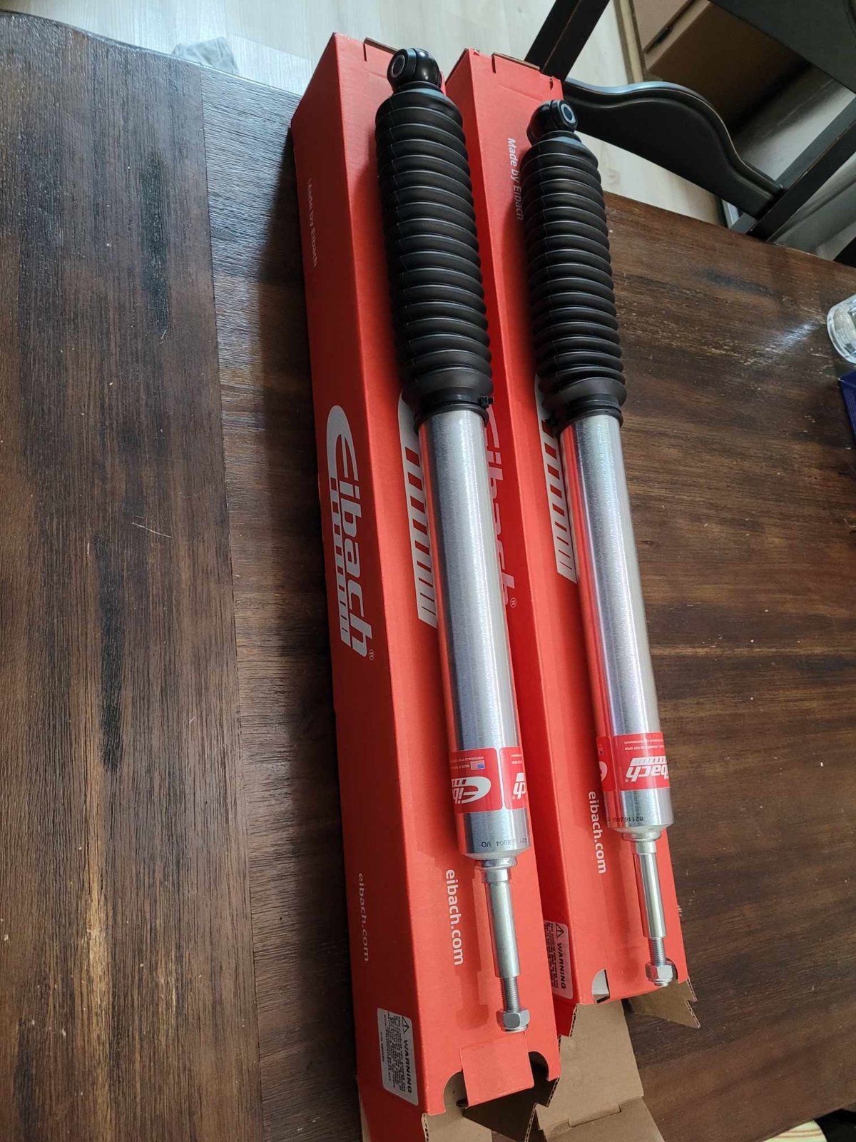

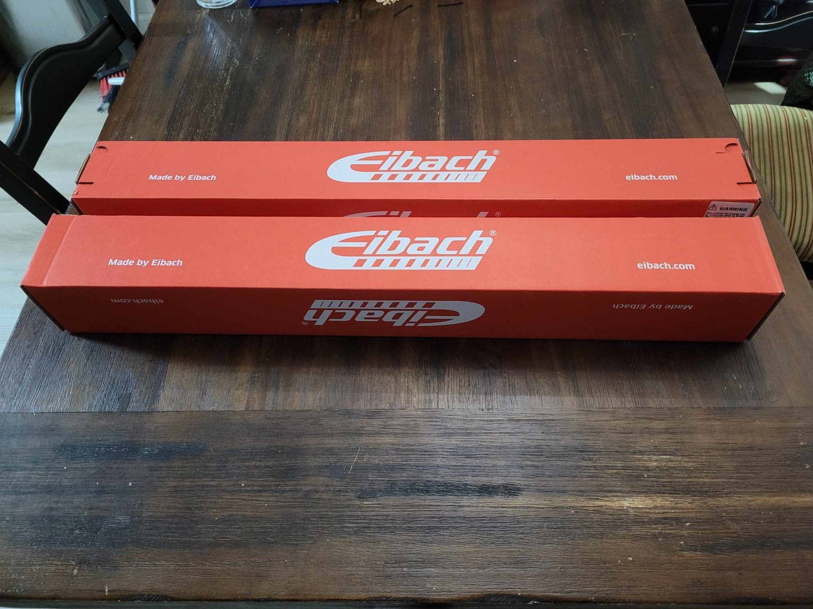

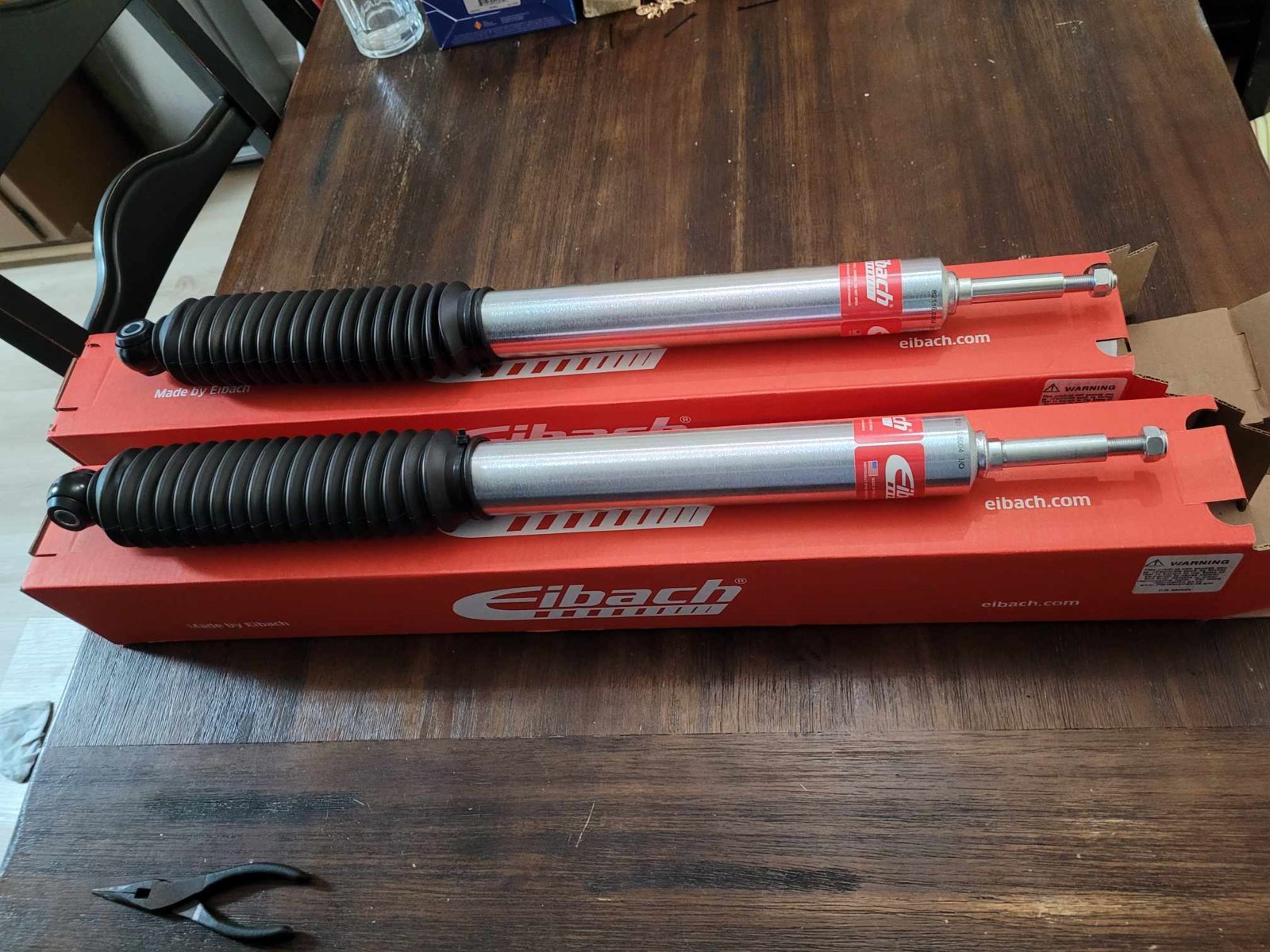

    I also ordered the rear shocks (262$ shipped from Stage 3 Motorsports) and plan on installing them tomorrow and also doing a transmission fluid change while I am at it, which requires removing my cat shield so that will be a bit of a project as well.
