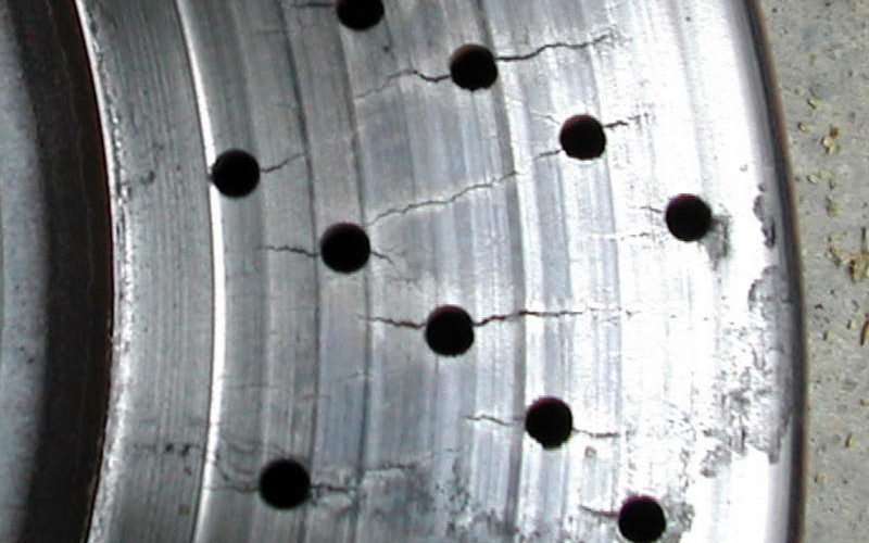

    I thought drilled rotors were to help keep them cool, but then read an article that said the holes were for the gases. Which I guess helps with heat in a way, but it also talked about how hot pads won’t touch the surface of the rotor due to a thin gas layer and the holes help get rid of that layer of gas. I think the article was on ebc’s website.
    I had drilled and slotted powerstop, and they were awful. I have slotted cryo stoptech and they have been pretty good.
    Not my rotors, but an example of them cracking.
