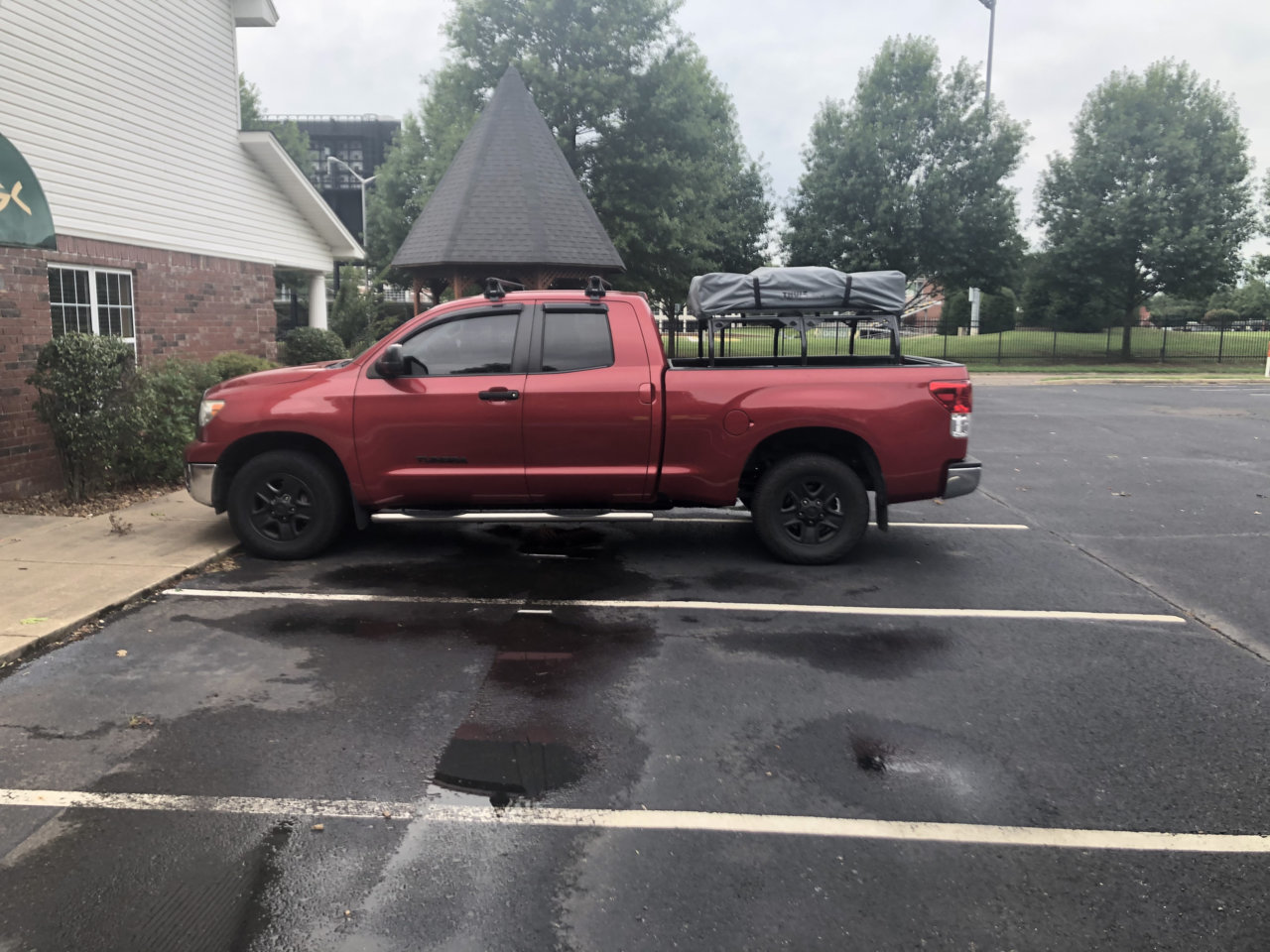

    I like the stock look. Don’t like all the rake. I think 1” lift up front might be a good compromise. How do I do this? A shim on top of stock suspension? 2013 4x4 Base
