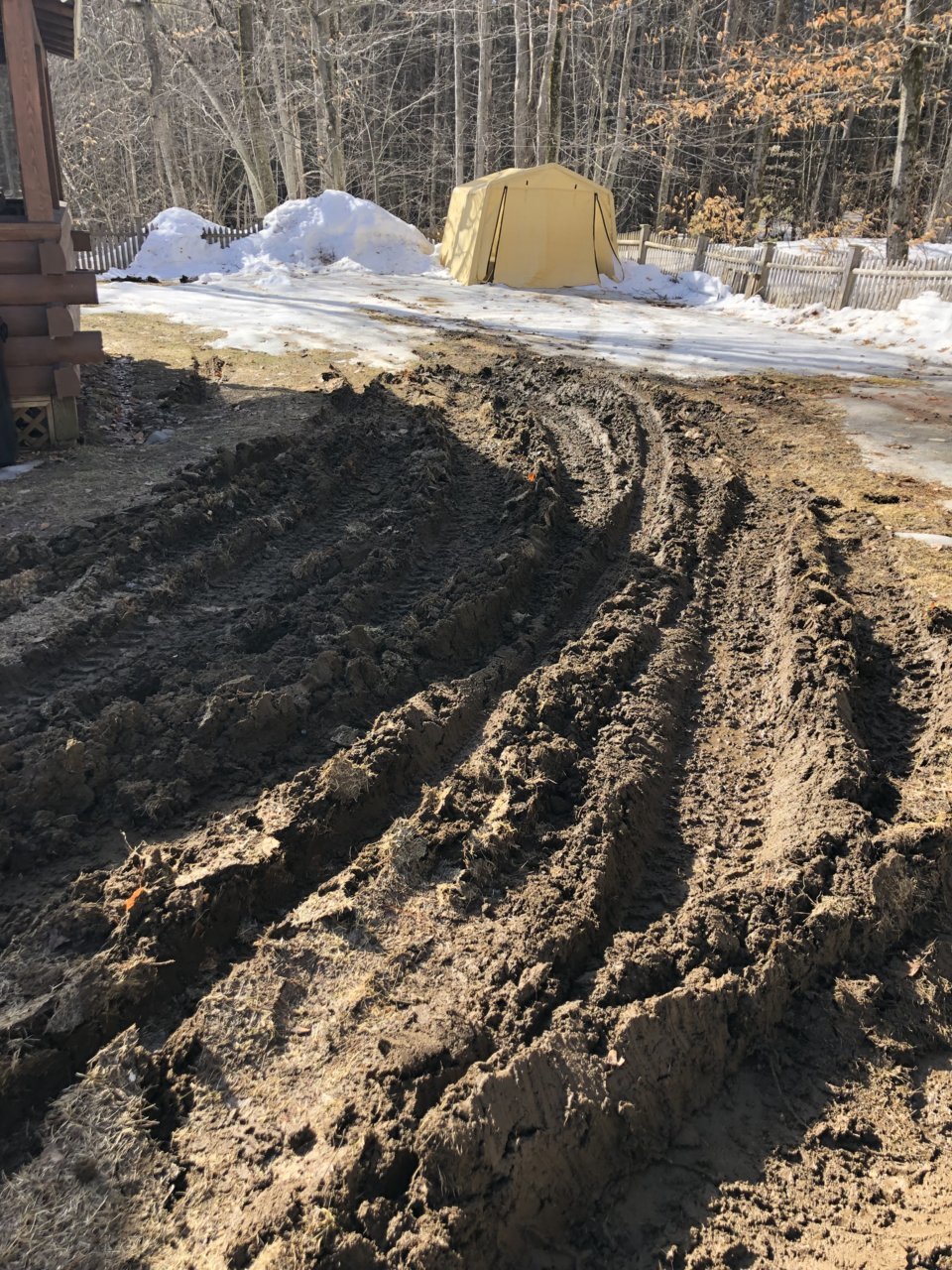

    I use 4H for my driveway so I don’t tear it up in 2. 4L for the occasional knucklehead I’ve dragged out of ditches this winter...oh, and when I pulled the boat out of the back yard before the ground “melted”. :mad: Gotta love Maine
