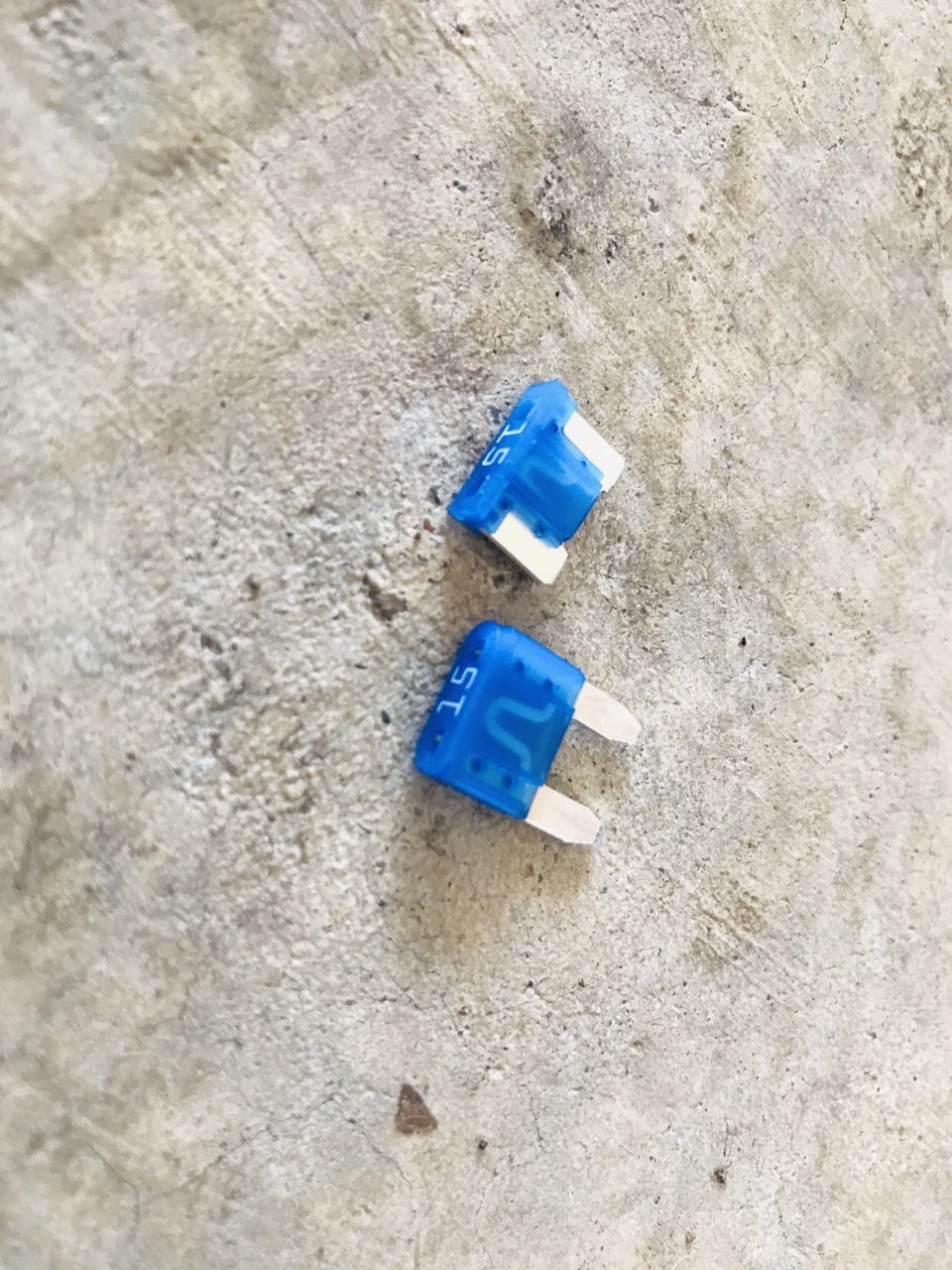

    Last weekend I blown out my cigarette outlet fuse when I was trying to use faulty vacuum. I don’t have really have mechanical skill but it’s not a rocket science. It’s inside the interior fuse box under the steering wheel. It’s labeled as 15A PWr outlet. Just pull out the cover and if you don’t have tool to pull out fuse then it’s in outside fuse box under the hood. And also make sure you buy the small pin fuse and not the large pin one. It’s the top one in picture and bottom one is not the right one. You can buy it for around 3 bucks anywhere. I bought from autozone and fixed it in 2 mins.

    I've got an assortment of fuses in my truck, but none like that top one. I guess I'll pick some up today. Thanks for the information.

    Bottom one would work too but you will not able to close the fuse cover then.

    Thanks for the "heads up". My tool bag has the bottom fuze style. I'll update the tool bag stash of fuzes.

    Thanks for then info! I guess I'll have to grab an assortment of these.
