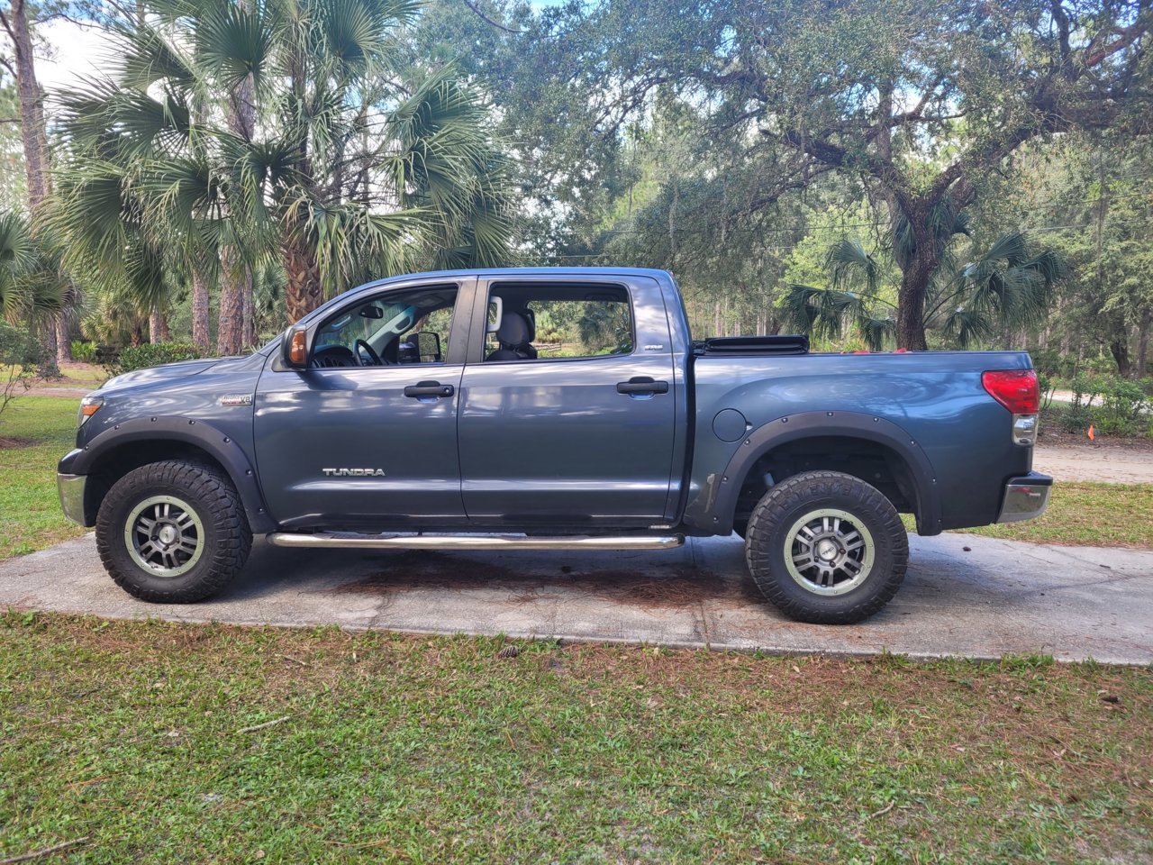

    When I got my truck 07 CM 4x4 200k miles, 10 months ago it already had a 2.5" leveling kit in the front. Last month I installed some 2" blocks in the rear (tapered and made for tundras). Since then the ride has just seemed terrible. Bouncy all the time and a slight case of the shakes 10-70mph.
    (possible important note: I took the passengers side coil all the way out before I realized there was already a front lift. Installed it as it was).
    Have had it aligned twice, and the tires balanced. Still a terrible ride.
    The guy who balanced my tires claims some of my tires are out of round (less than 2 years old) brand name tires.
    I tried adding 3/4" of spacers to driveshaft bearing today thinking that was going to be the silver bullet. Nope, might have helped a bit, but still shaking.
    I am close to buying some new u-bolts and going back to stock height in the back at this point. Sucks you're not supposed to re-use u-bolts or I would have swapped them already, but I can't be spending a bunch of money going back and forth on u-bolts.

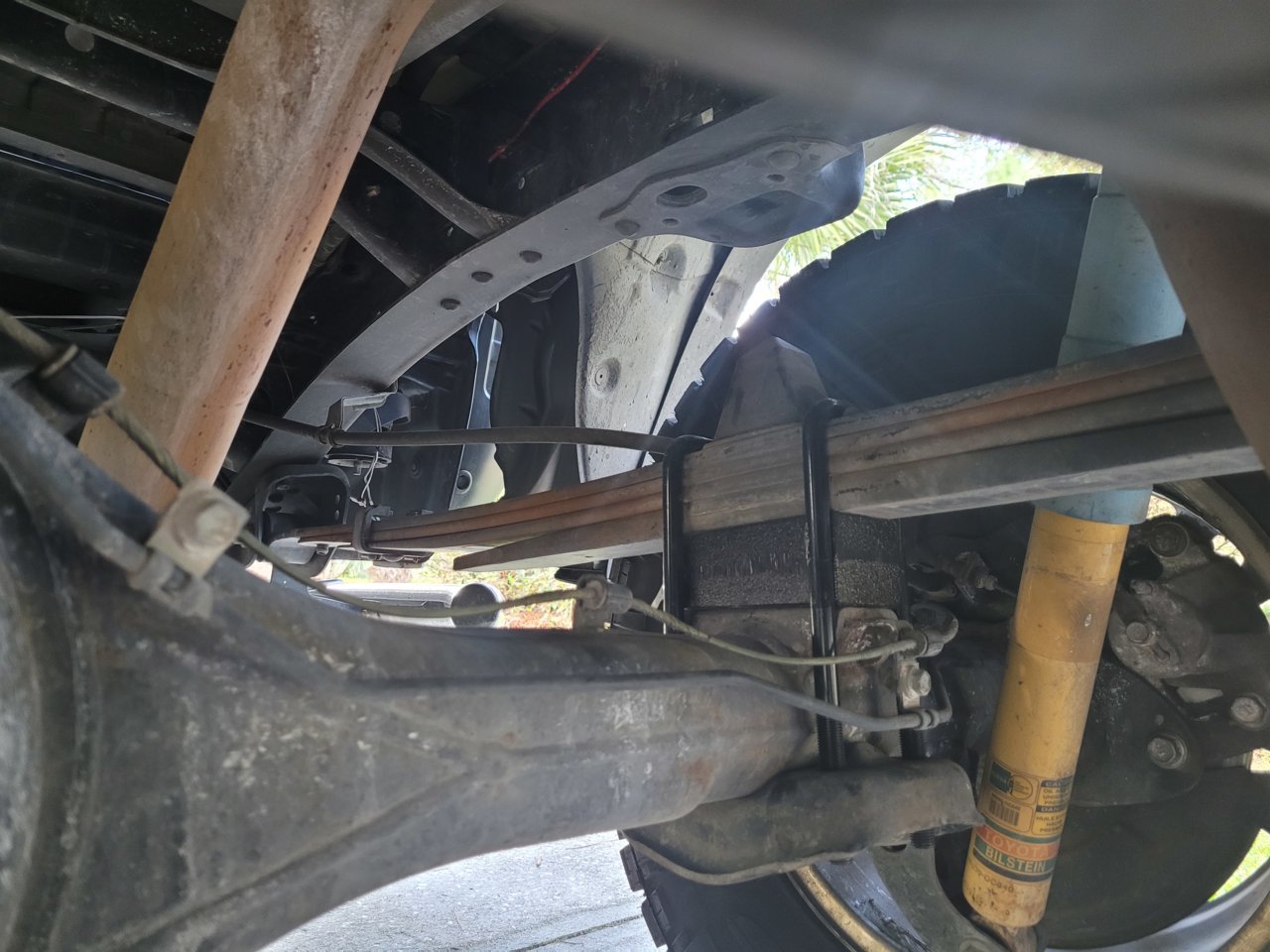

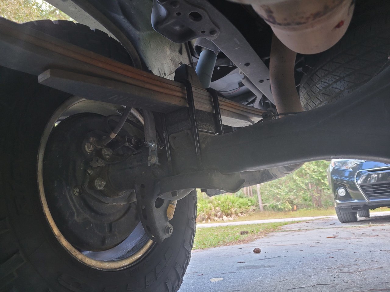

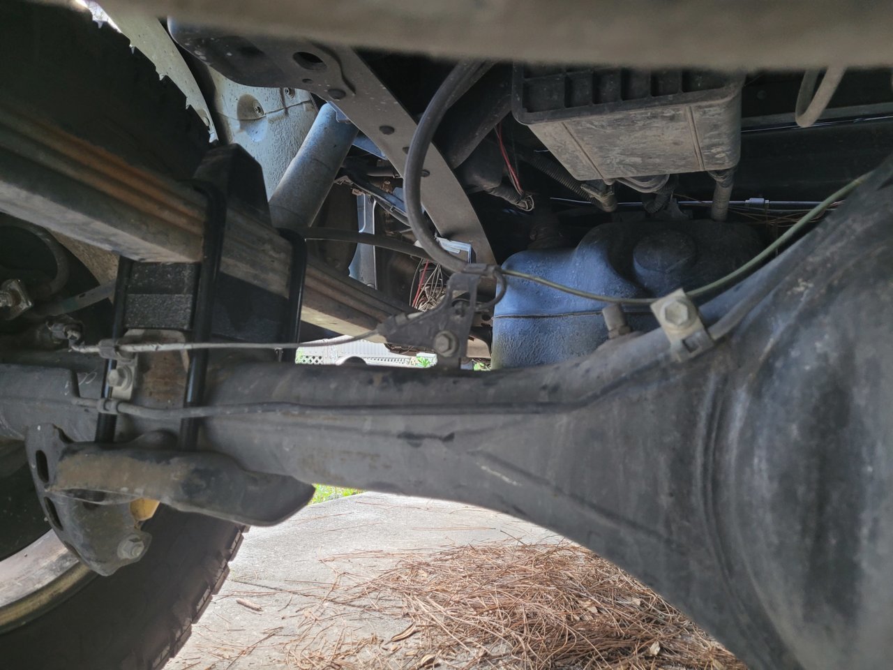

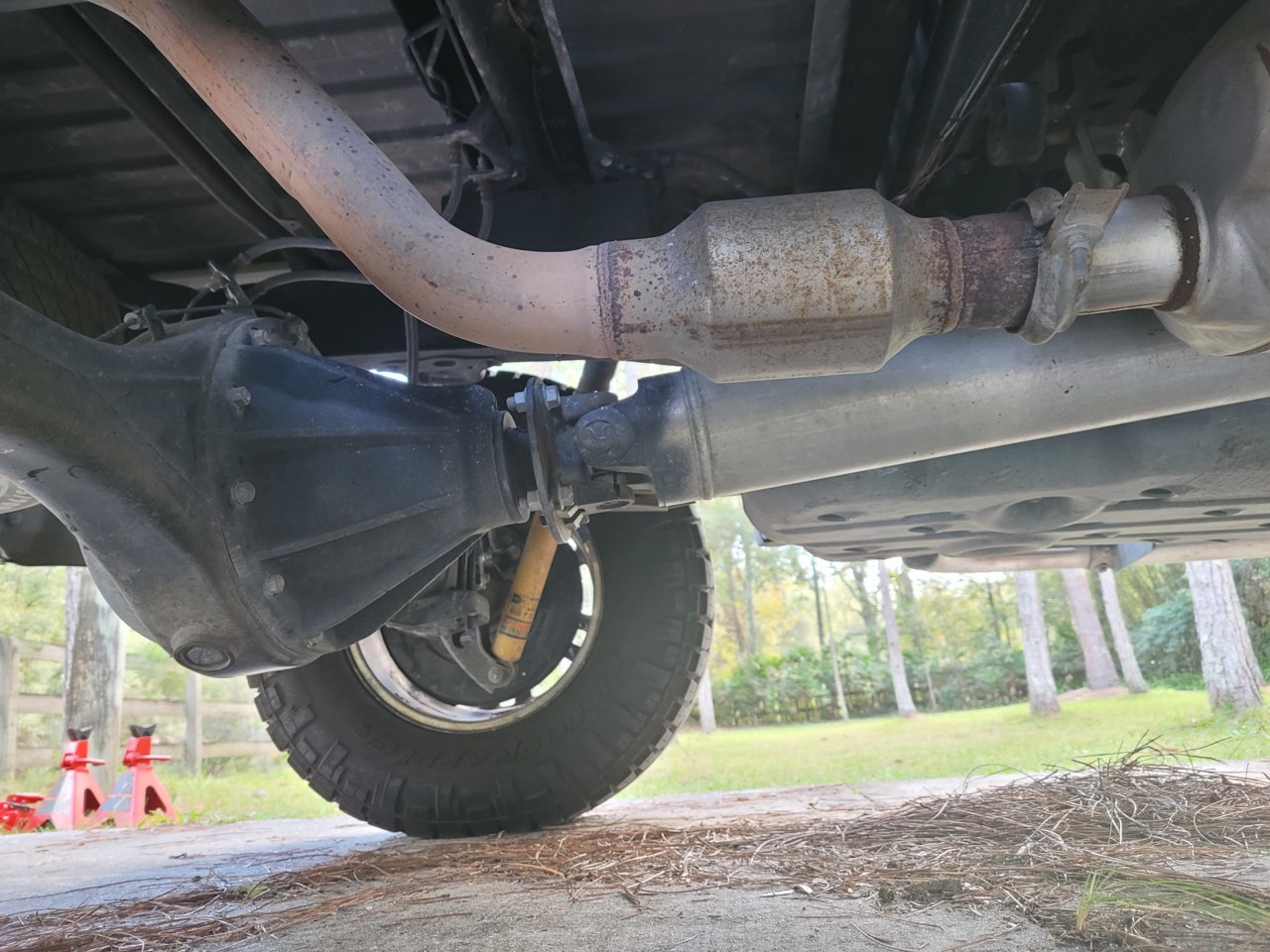

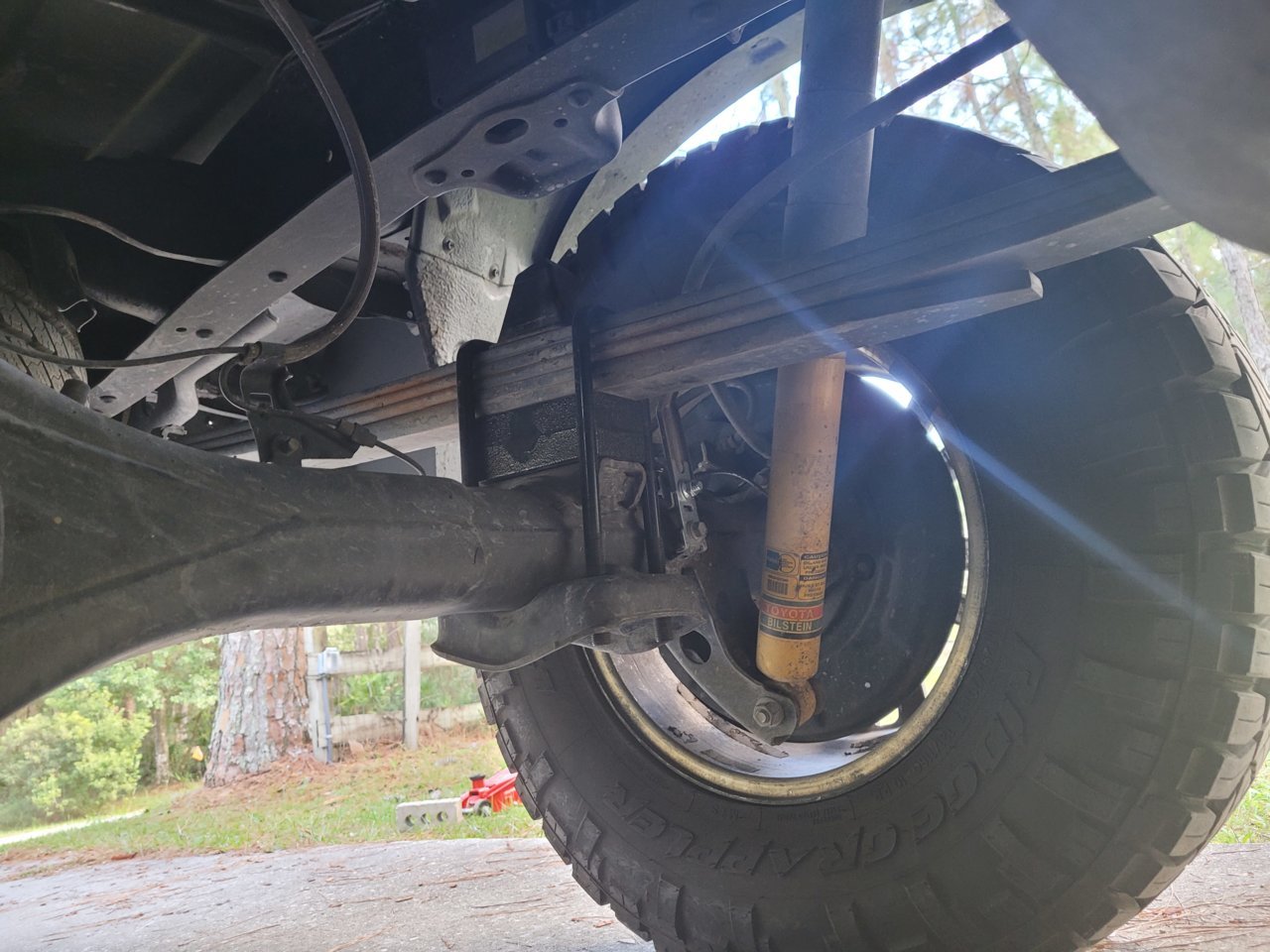

  13. Nov 5, 2022 at 11:23 AM
    chrisf111
    chrisf111 [OP] New Member
    Dec 14, 2021
    #71770
    368
    For sure not the steering wheel. I can take my hands off and see no shake in it. I need to find some time to swap the tires around and see if it comes into the wheels. Just so time consuming with only 2 jack stands. Pics of blocks coming in next post.

    Got the rear up on jackstands today and let the tires spin. Rear tires may be out of round by less than 1/4", probably closer to 1/8".

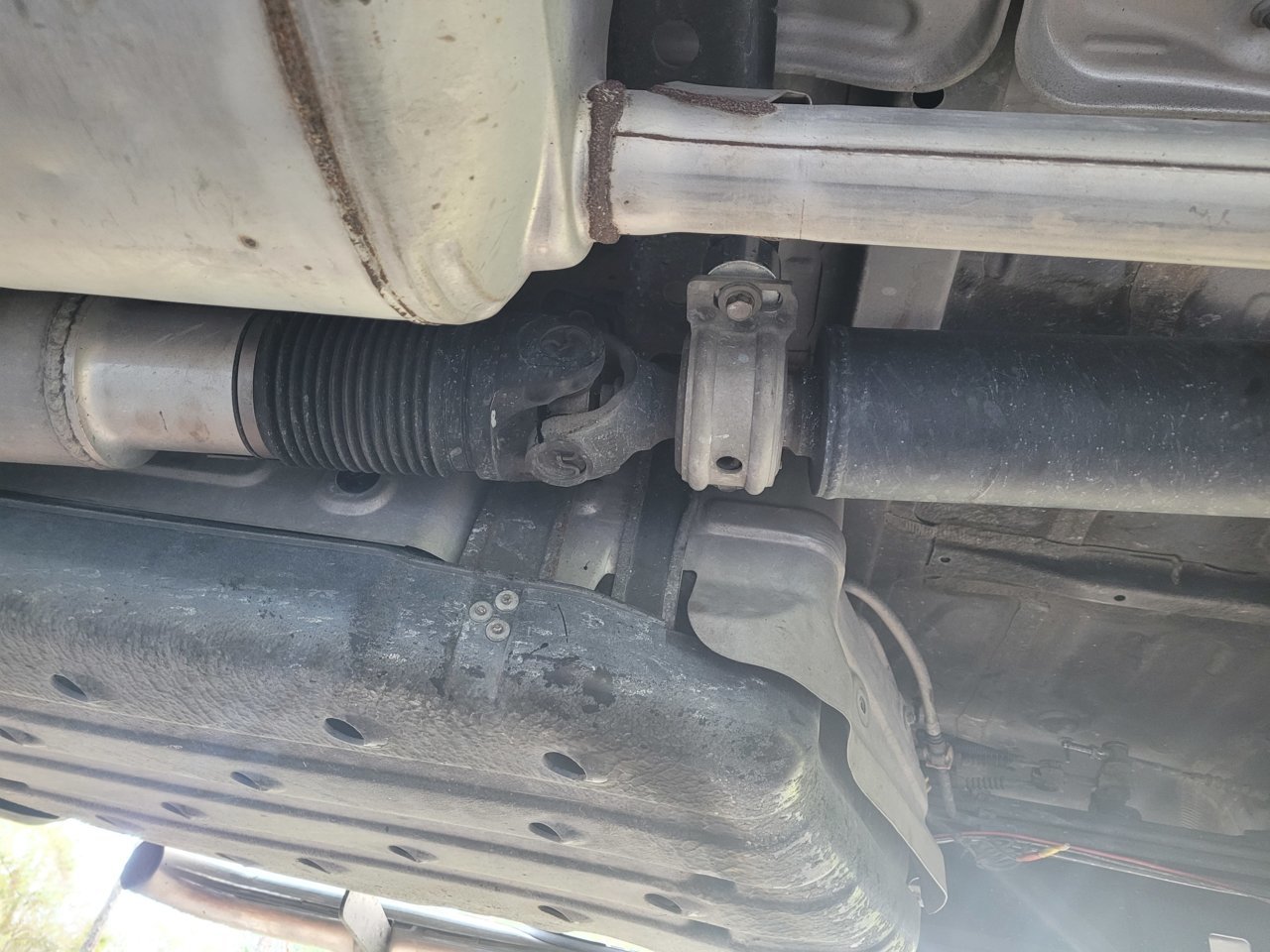

    Thank you! This is so helpful. I went out and made some adjustments and it seems to be riding better. I'll give it a few dozen more miles before calling it good. I ended up having to remove my carrier bearing drop spacer and flip it upside down, then add about 3/8" of spacers. The issue seemed to be with the front portion of the driveshaft not being in line with the transmission.
    It is tough because the only adjustment point you have easy access to is the carrier bearing drop.

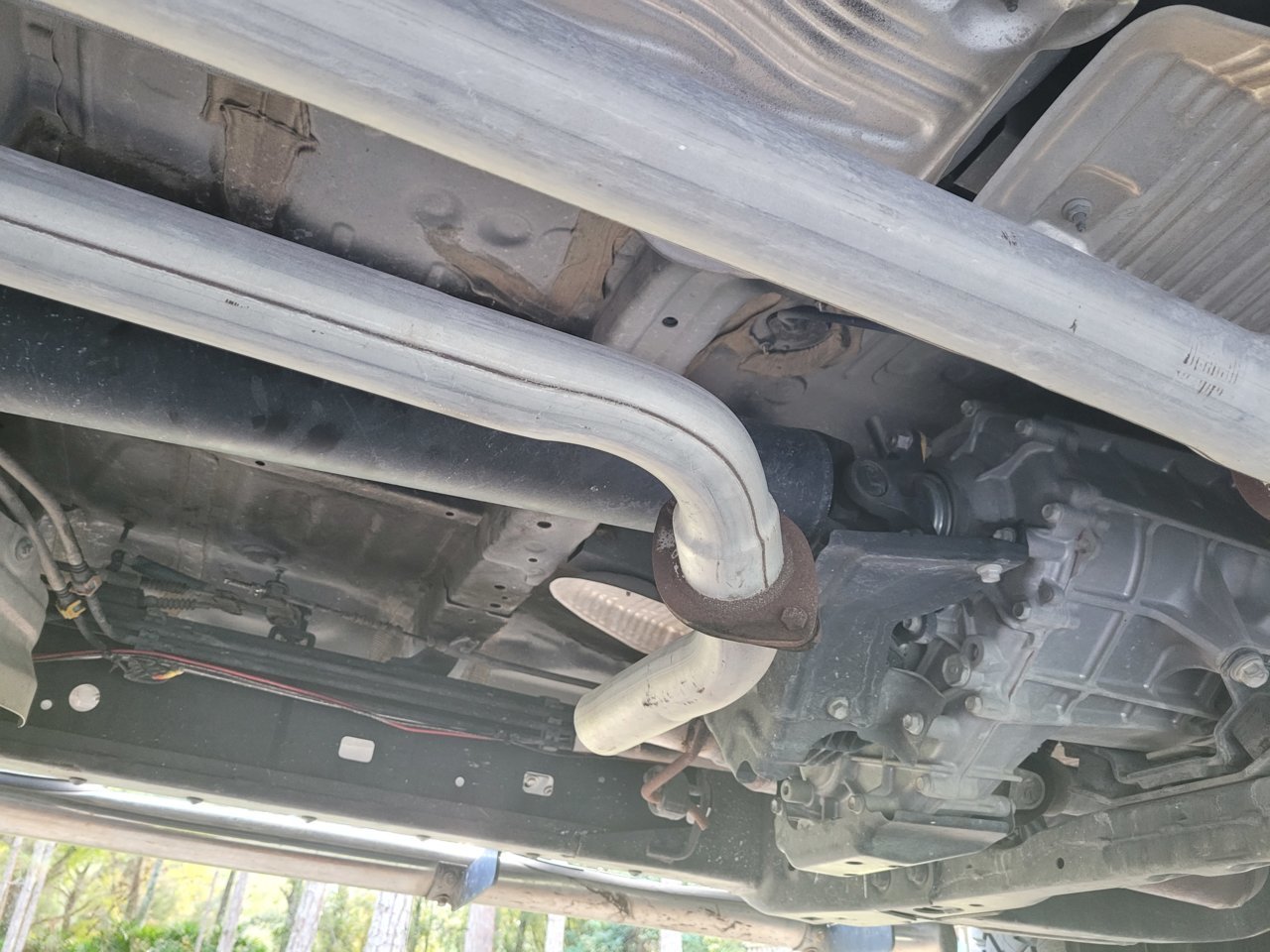

    Your blocks appear to be installed correctly. Your vibration is either the driveshaft angle or the tires.
    How big of a spacer do you have on the carrier bearing? How thick is it?

    Those round spacers i think are for the front differiential. I would try removing those and stacking some washers about a 1/2" inch thick with the carrier bearing facing the original direction and see if anything improves.
