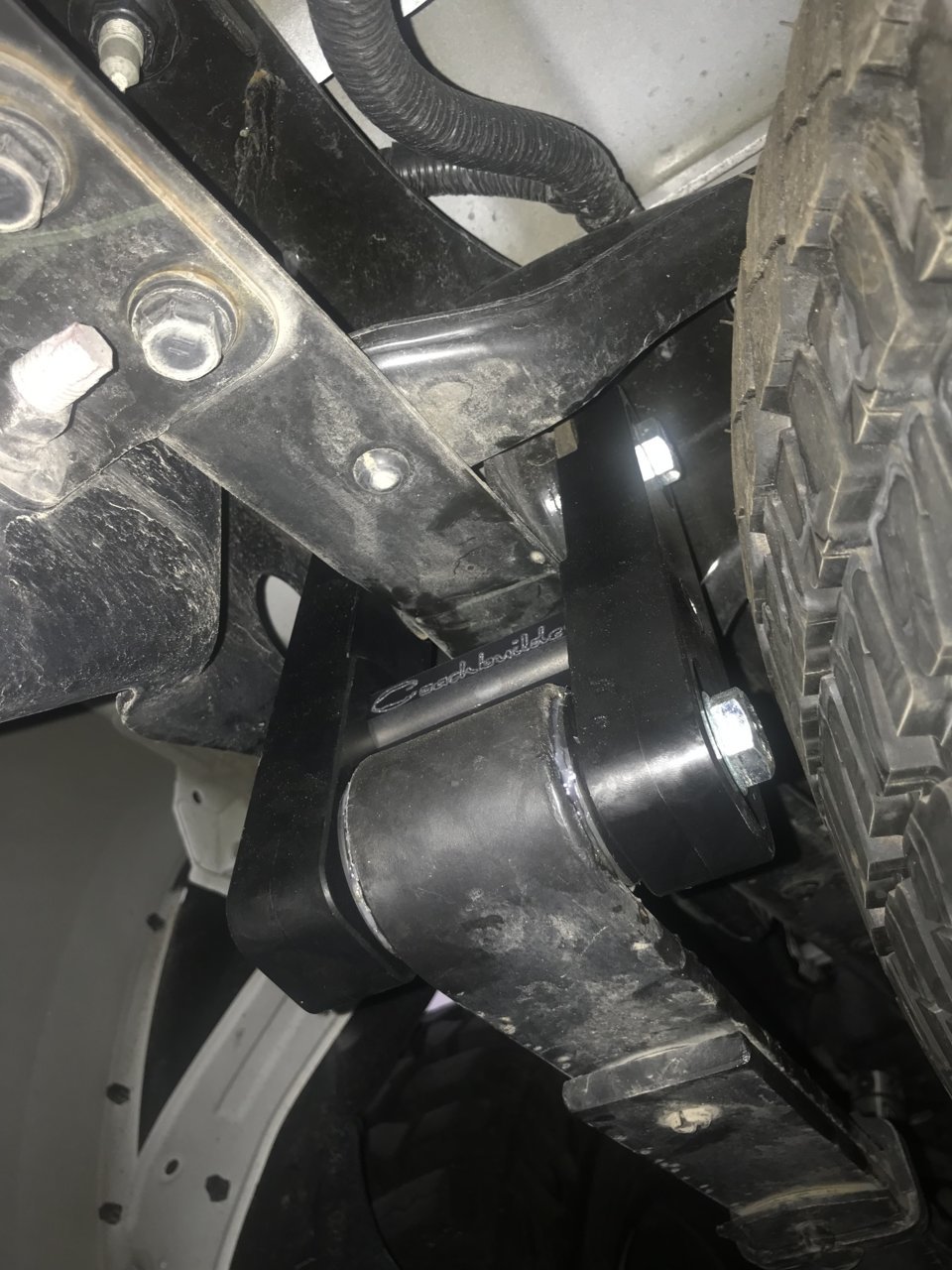

    This is my coachbuilder shackles. It helps level the rear depends on your front lift. But most importantly it helps your ride more firm and less bed bounce.

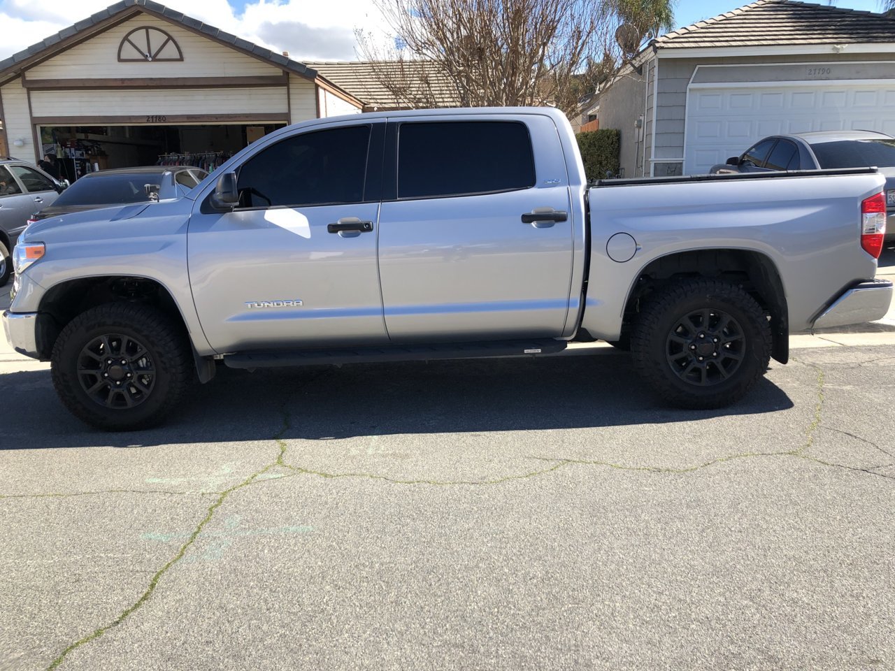

    I did 1.9” and ended up exactly level. But, anytime I had weight in the bed I was nose high. I added coachbuilder +2 shackles.

    So since u added the shackles u have a little rake then right ?

    Yes. Just a little.
