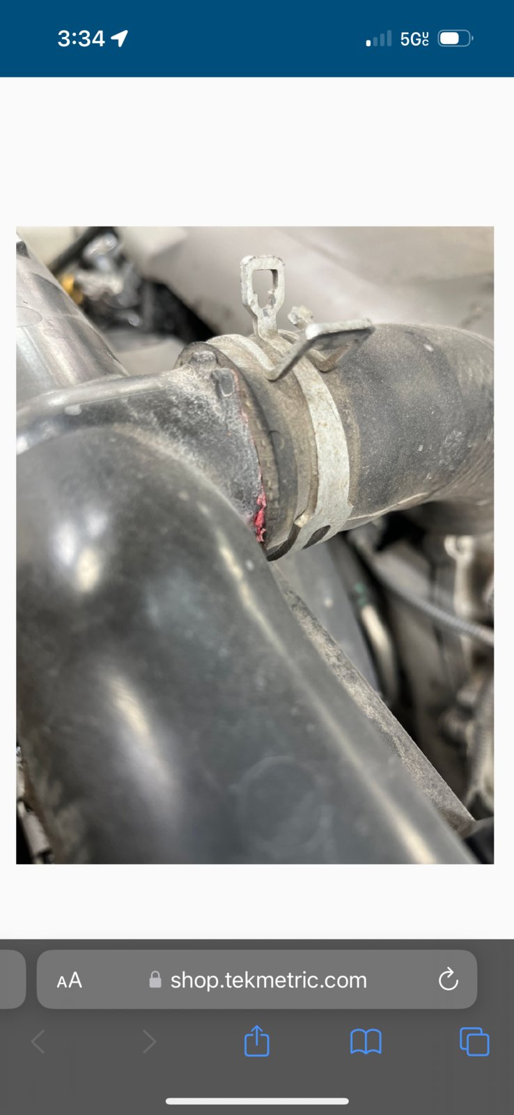

    My mechanic said that my upper radiator hose has a 10/10 SEVERE leak. Is this considered severe?

    Uhh no, no it's not. That's a minor seep.

    I'd give it a 1/10 since I can see some pink crustys. If you've never replaced the hose, it is a 2008, so that hose is 16 years or so old. I would replace the hose and the clamps, both upper and lower.

    You’d replace them both even if it’s a 1/10 just because of their age?

    I thought the same…

    Yes. I would replace 16 year old hoses because of their age and because they are starting to leak. 100%.

    But yes at that age replacement is a good idea, a lot of time it's not mileage that ruins hoses it's time. Plus those hoses and clamps are not expensive

    This is called preventative maintenance.
    This is called "Can someone come get me, I'm broken down half way between Vegas and LA in August at 112F"
    I'm a preventative maintenance guy. My response is facetious, but it has merit. In the end my decision is which is actually
    cheaper. Aside from the cost of doing a proper coolant flush and fill, this also makes me look at water pump, thermostat
    and all the other parts that might 'just have a seep' too.

    I had 3 yr old upper heat hose fail with a pinhole leak. Took 2 days to figure it out, and I was offroading in Yukon.
    Cost me 2 hotel nights and lot of lost sleep. That was with all newer hoses, it can happen anytime after that.

    My 17 is doing the same thing im at 97,000miles. weird. Neither hose nor the clamp have ever been off or touched
