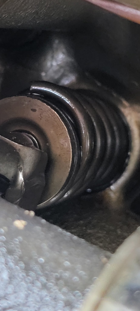

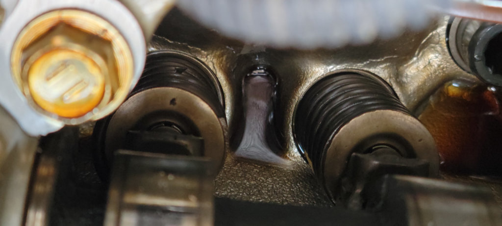

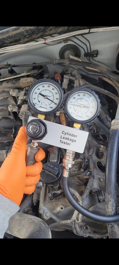

    Screenshot_20250209_125509_Gallery.jpg 20250209_125312.jpg 20250209_124014.jpg
    Finally got time to dive further into my truck. Did a leak down test and found the air venting directly into the intake manifold and out the throttle body. Decided to take the valve cover off and found 1 broken intake valve spring on cylinder 1. Ordered springs, gaskets, timing chain tensioner, plugs, the whole 9-yards and I am going to try and tackle it this weekend.

    Thanks for the suggestion. That's what I did. After looking into it, it is possible. And that's what I did today. I started by using a flathead screwdriver and popping the rocker off the hydraulic lash adjuster, then I slid the rocker out. Then, using a leak down test kit, I pressurized the cylinder at TDC, and closed the valve. Then, with a combo wrench, I used closed end of the wrench and the camshaft to press down on the spring. Since the spring was broken, it didn't require much force for the keepers to pop out. Then, I removed the spring. For installation, this was the tricky part. First, using a vice, I compressed the spring and used 100lb zipties to hold it. Then carefully, installed the spring. After getting it positioned in a way that I could cut the zipties, I installed the top hat (idk the formal name), and the keepers. This was the tricky part. A tip, use a flathead and gently push down on the keepers until they pop in place. Make sure you stuff a bunch of rags so the keepers don't fill into your head. After you get the spring installed, reinstalling the rocker isn't too bad. Rotate the engine so that the cam lob is pointed vertical. This gives you enough space to gently pry the rocker over the hydraulic lash adjuster.
    I ended up doing just cylinder 1 springs. All in all, it took me 9 hours. Including removal of valve cover, installing 4 springs, installing new valve cover gaskets, and replacing all 8 spark plugs. I have no experience working on valves, but with enough attention to detail, it isn't too bad. I would recommend taking lots of photos, and triple checking all screws and connectors. Ran the truck until it warmed up and everything sounds perfect. All codes are gone, and she idles like a dream.
