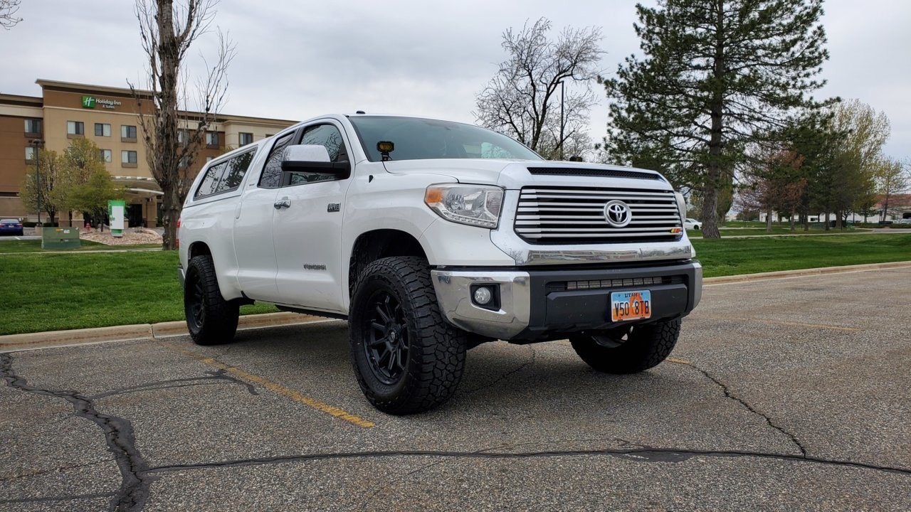

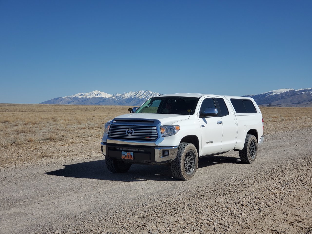

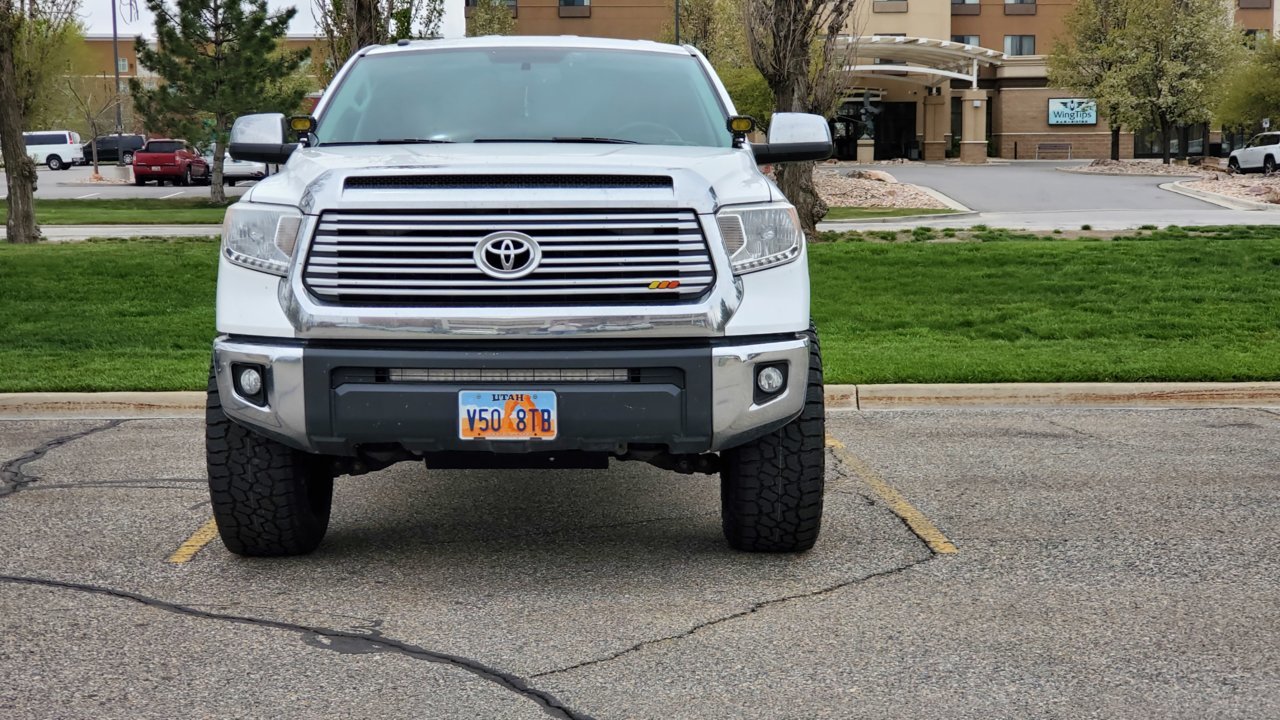

    Lower offset wheels or spacers , and generally changing offset further out will cause you to need a leveling kit to not rub. This was my truck with 275/60r20. Had a little poke maybe 3/4 inch or so with a level. Wheels are 20x9 +20 offset. Tires will play a part too, as now I'm on 325/60r20 same wheels with significantly more poke because the tires are so much wider
