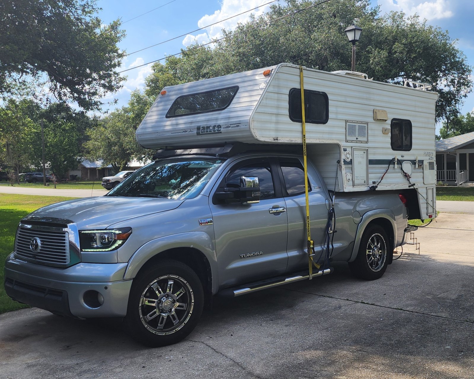

    1. I going to do a rear trd sway bar and Firestone airbags and bilstein 4600 for the suspension so far but I wondering what is a budget leaf spring that stays at stock height and gives some help with camper that is on half the time for I live in it and move from place to place the camper is a 1995 lamce squirelite 150s 8'6" short bed and my truck is a 2012 tundra limited 2wd 5.7 gas

    Yes I have proper mounts coming for the camper

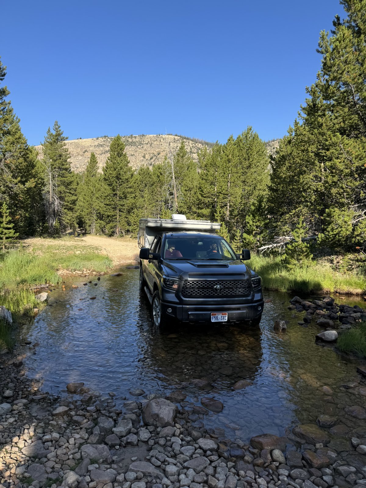

    #64861
    485

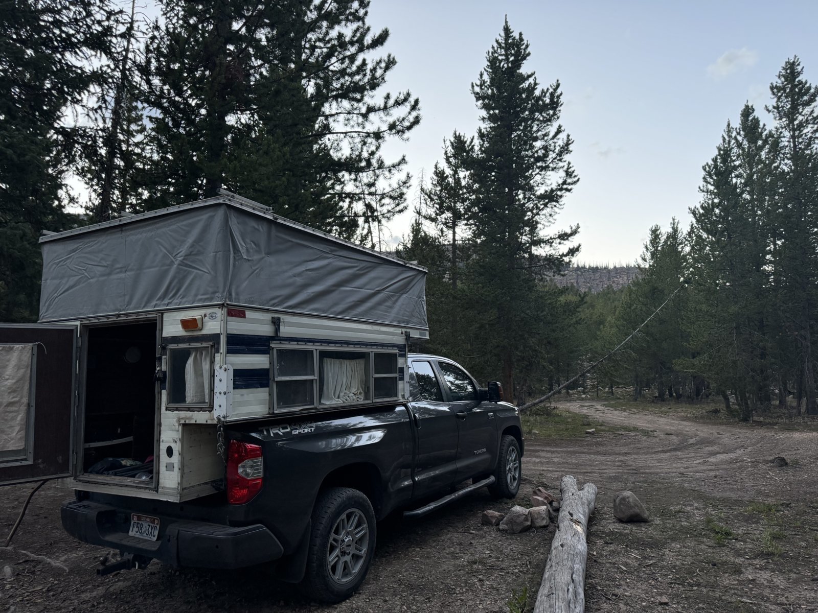

    That’s a big camper - I run a FWC fleet maybe 200 or so days out the year. Front and rear sway, e rated tires and ride right airbags have done me very well.

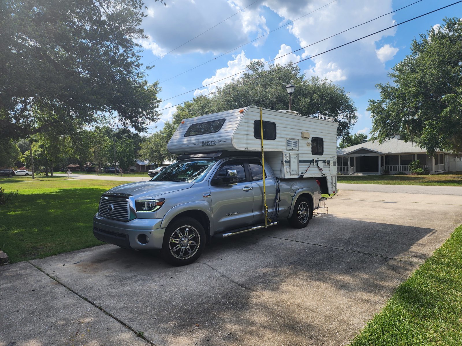

    This 150s is 1500~ dry

    First thing 2wd has more payload then a 4wd also I'm on disability and living out of the camper I need something reliable and truck is paid off the camper is the lightest non pop up I could afford I got it for 1800 no leaks or damage everything works and yes it right about ay payload but I seen others run lamce 650 on there tundra those dry rate 2100 so I doing pretty good , I figure by doing a front and rear trd sway bar the Airbags and upgraded springs and shicks I be ok , it be slow process saving up each month and buying a part each month i be ok the truck did handle the camper pretty good on the ride home I just trying make it best I can
    Thank you for your input I do appreciate it

    #64861
    485
    it stays on from April to late October / early November. Handles it fantastic. Camper is about 800lbs.
    Just took it off to rebuild this winter actually.

    Only 800? Is that a "cowboy camper" with like no interior?
  30. Oct 31, 2024 at 8:41 AM
    #30
    Pac12AfterDark
    Pac12AfterDark New Member
    Jun 28, 2021
    #64861
    485
    Ba
    Basically - it’s a 72 four wheel camper fleet. Lightening it up further this winter. (Going to take some length off it)
